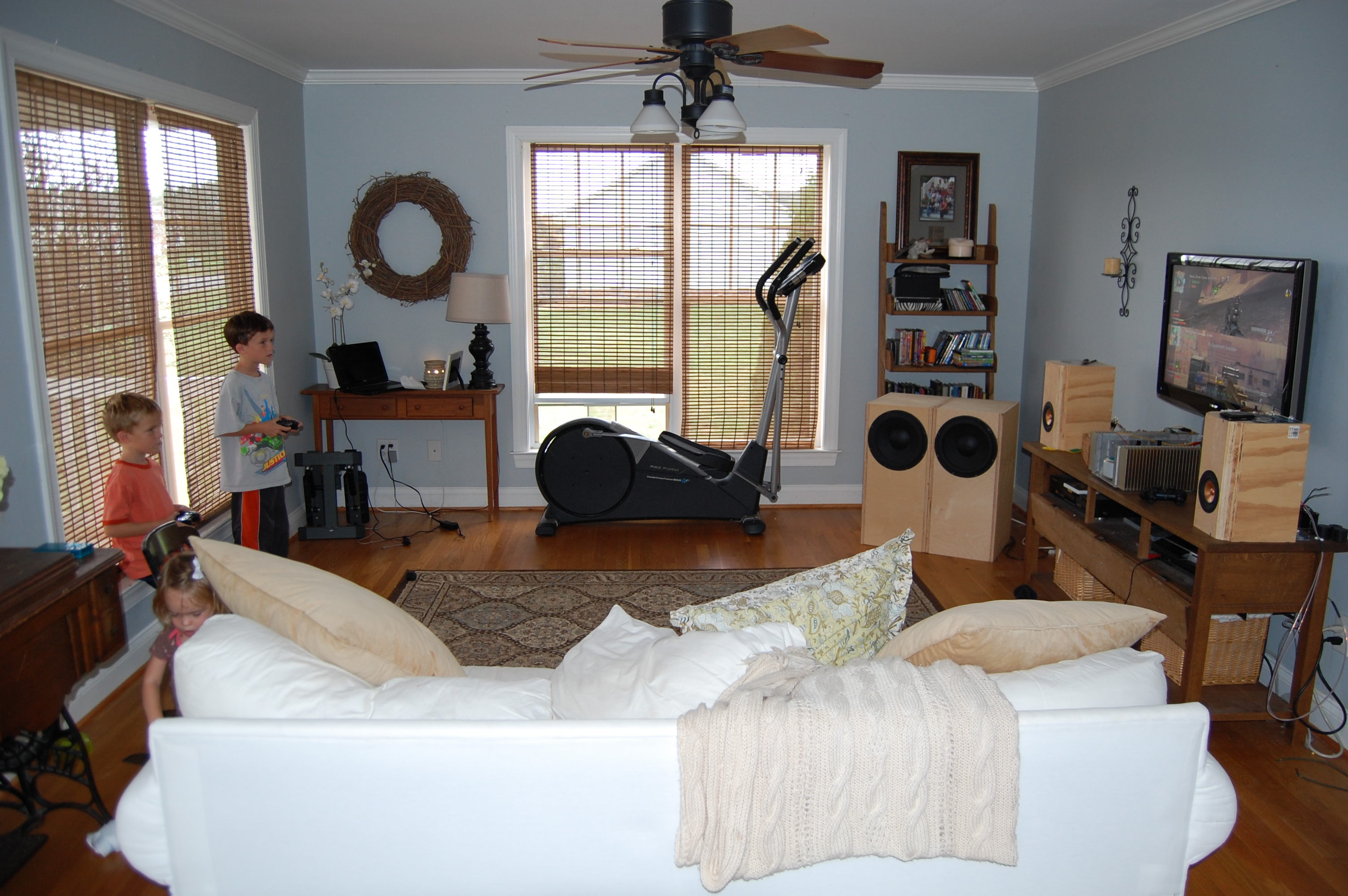

Here is a pic of the room. I figured it would help in making decisions about which path to take. Looking for more experienced opinions here concerning placement. We are shifting everything this way. THe window is going and a fireplace is going in. The pic inlcudes two sub boxes with 12" subs to give a scope. The cabinet is about 27" wide. Have to decide if the which box style will work best in room. I wonder if the side by side is going tobe too big or cause reflection issues.
Post 148 has the options of speaker layout. May not be exact, but going for similir look.
