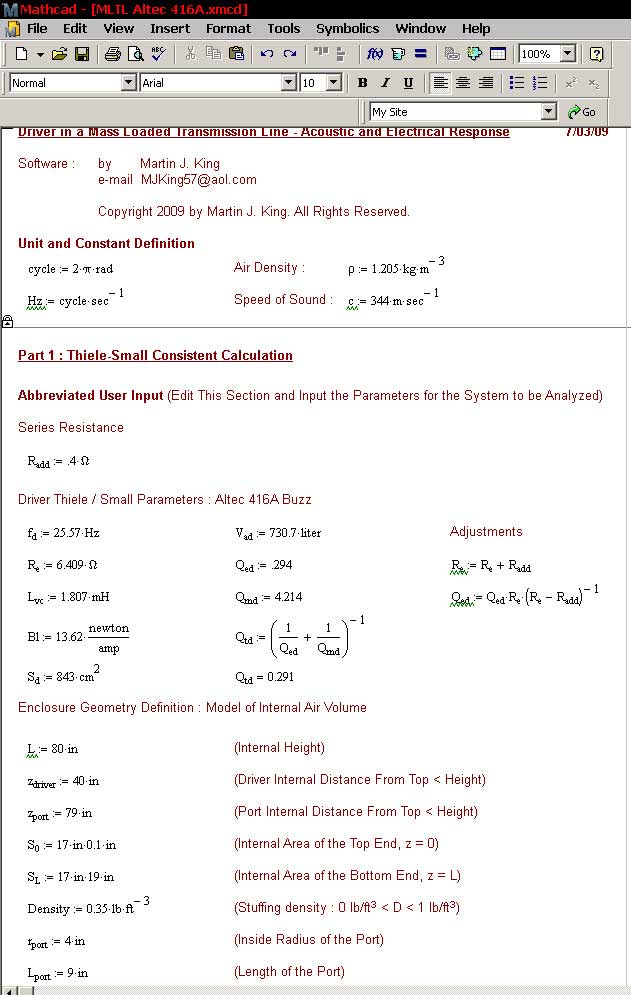

I just meant that MJK's sheets agreed with what the DATS system figured. In the program, it shows Le at 1kHz.
Here are the numbers
#1
Re - 6.25
Fs - 26.92
Qts - .319
Qes - .343
Qms - 4.573
Le - 1.678
Mms - 52.96g
Vas - 23.27ft^3
dB - 97.63 1W/m
BL - 12.78
#2
Re - 6.40
Fs - 25.57
Qts - .275
Qes - .294
Qms - 4.214
Le - 1.807
Mms - 52.94g
Vas - 25.8ft^3
dB - 98.08 1W/m
BL - 13.62
THey look like some 416-z numbers I have seen.

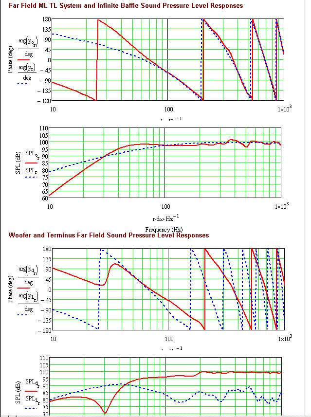

You may display more response detail in the Frequency graph. To do this reset the range of the graph. Clicking on it will allow you to enter different values where you have 110 & 60 now. I suggest 105 & 75 for 3 dB gradations or 104 & 84 for 2 dB gradations.
Varying Zdriver may have an effect upon the response ripple around 500 Hz.

I think it depends on your software. It appears you are using an older version of worksheet. Martin now provides worksheets which are based upon the volume components, Area & length.
I have his newest sheets. In the MLTL worksheet, it only has an option for port radius and length. Further down, you can fine tune the box parameters for in room response, but none of the changes made there affect the upper response graphs which I showed. I assumed that this was to mean that if you wanted other shapes, you would have to just figure volume.

Right on. MJK's math dictates a L*0.349 location, which only considers length while mine factors in CSA, so varies depending on the aspect ratio and since this cab doesn't have a very high one, it calculates L*0.487, even lower down than a golden ratio's L*0.46233, so no significant 1/4 WL vent loading unless the driver, vent is at the extreme ends. Plus, there’s the room’s vertical modes to consider WRT driver location.

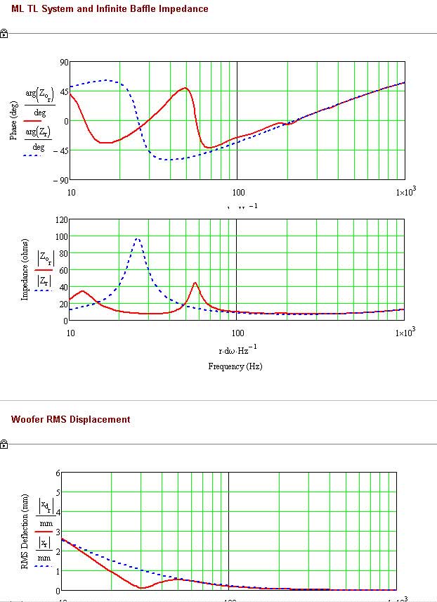

Couple of questions.
How important is consistency of wavelets(?) of the first two impedance graphs?

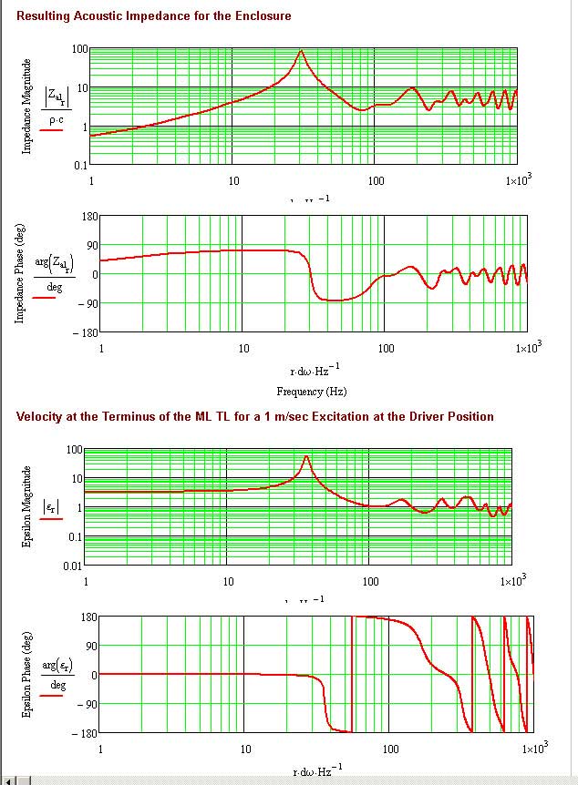

Here is try using better box ratio. Cant figure out why acoustic impedances are so ugly and why there is nasty port phase issue
let GM say last word here 😉
I'm sort of short in time today , besides fact that I have no clue , comparing to him
observe difference in length of your TL and mine
your's is too short
your's is too short
