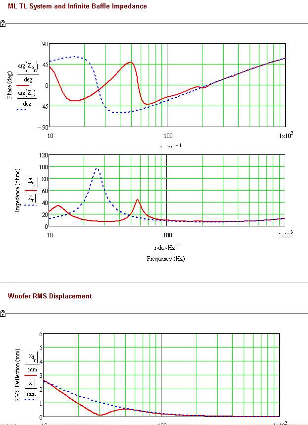

What is the major advantage of the reduced impedance peaks as seen in ZM's calculations included below?
My ignorant assumption is that it provides a more even load to the amp that should improve performance, but does this play out in real life as audible improvement?
This is a big deal when being driven by a high output impedance and why one must always tune to Fs for best overall performance/power transfer. With today's vanishingly low output impedance systems it only matters if the speaker's impedance drops below the amp's minimum rating.
There is group delay to consider though, so for higher Fs drivers it's best overall to tune them so that the lower impedance peak is damped.
Low Fs drivers tuned low have a higher group delay, but the vast majority of folks don't hear well enough down low, so by the time their hearing acuity improves, the group delay has decayed enough to be acoustically benign.
GM
Is this reduced acoustic phase ripple the advantage of true Tqwt vs ML-TQWT, like mine? I can reduce mine with more stuffin, but not to the degree that you have achieved. OTOH, the impulse response from mine is very good, which i would think is an indicator of a quick cone response. Just trying to figure out what all these graphs mean. No where does MJK speak to these things.
Correct, ideally we want a flat frequency and electrical phase response, but they are hard to come by except over a narrow BW.
Yes, ideally we want the system to be extremely well damped, so there would be ~nothing under the curve and no HF ripple [ringing]. Unfortunately, the only time I’ve witnessed it is from a small theoretically ideal BLH designed specifically to see if it was possible and otherwise useless except for a near-field app as it had virtually no power handling capability over most of its pass-band.
GM
