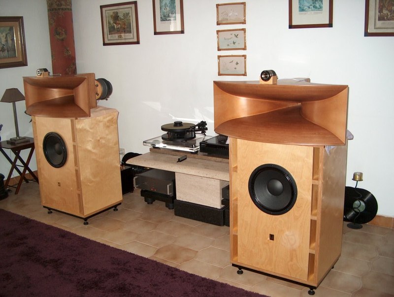

Nice piccys Zen Mod.. Post 16 for a NICE horn (edit HAHA you found it too buzzforb!!)

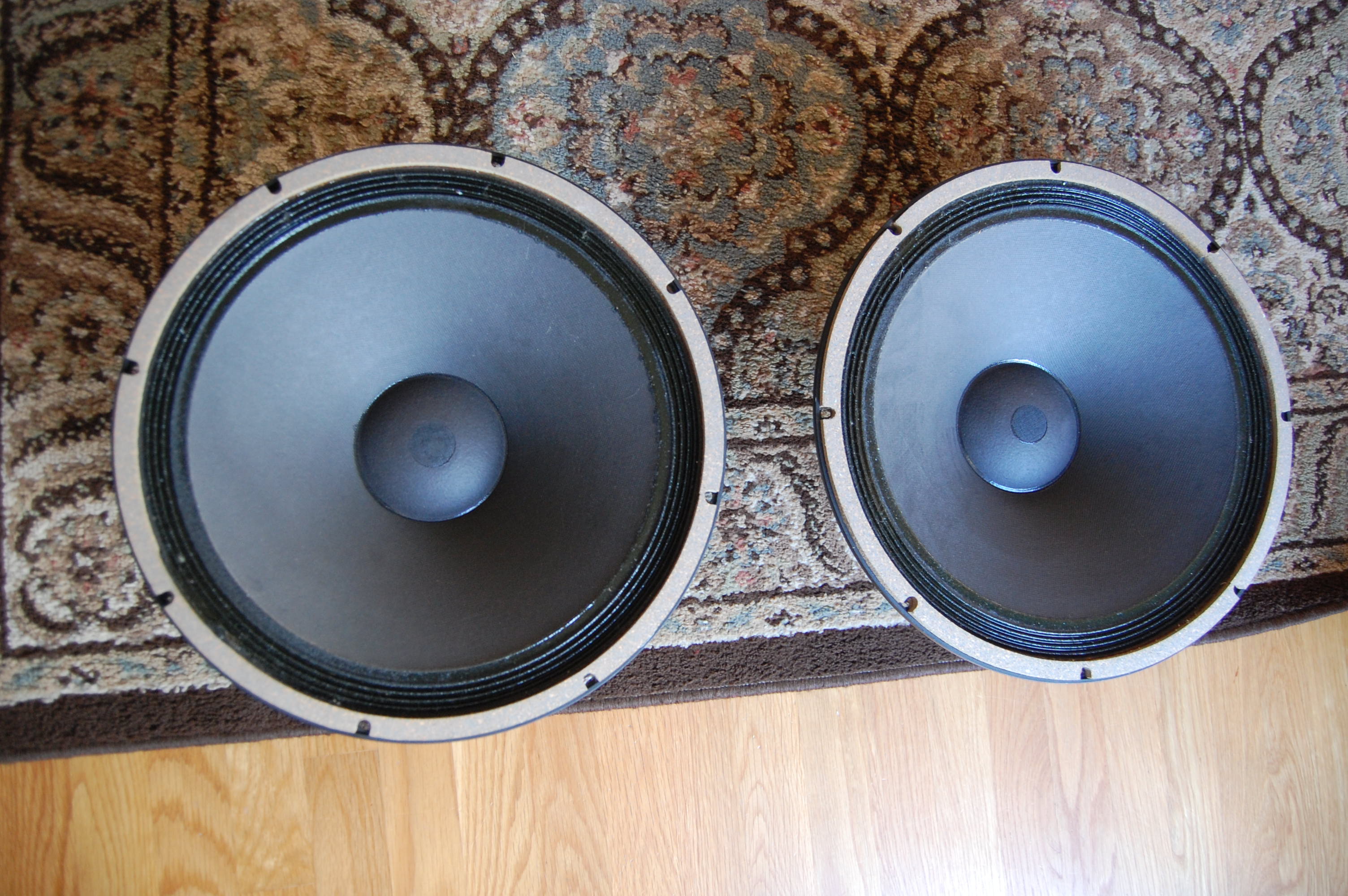

Can anyone say MINT!
Pray they measure like they look.
We'll see after BB practice.
Woofer 1
6.59 Re
26.24 Fs
.286 Qts
.305 Qes
4.469 Qms
.752 Le
Woofer 2
6.26
27.59
.318
.342
4.621
.671
Not perfect, ubt not bad either.
Woofer 1
6.59 Re
26.24 Fs
.286 Qts
.305 Qes
4.469 Qms
.752 Le
Woofer 2
6.26
27.59
.318
.342
4.621
.671
Been doing it for about 10 minutes. How long? Everything looks pretty good. Qms is a little low, but that is comparing to 416B and there are folks who say there is a difference? What has your radar perked. These things really are in wonderful shape.

What are the good things about an Onken style cabinet? ...as compared to a "bass reflex" or a MLTL?
In 'another thread' Pano said "I like the big Onken with the Altec 416 very much. It's very tight bass, never boomy. It can tickle you like a feather, or smack you in the face. Yes, it does very well at low levels - that's one of its strong points"

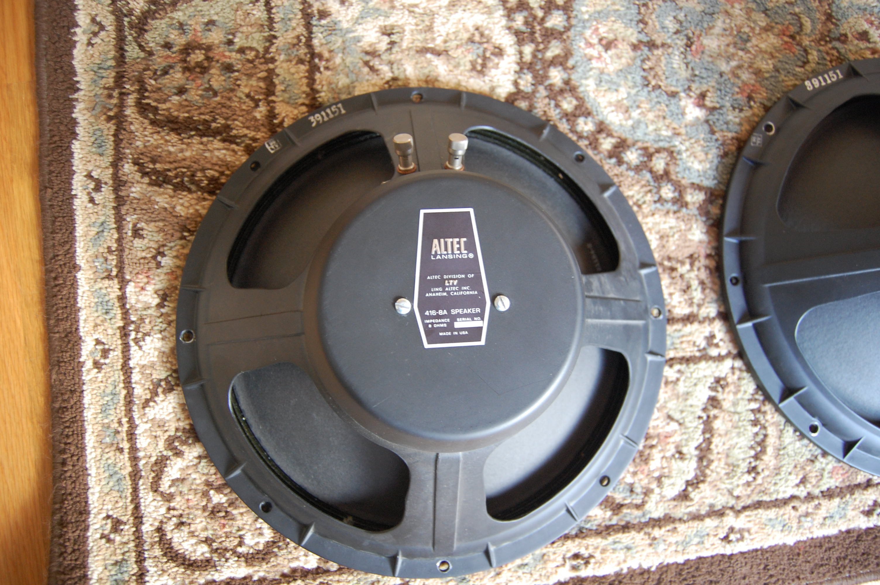

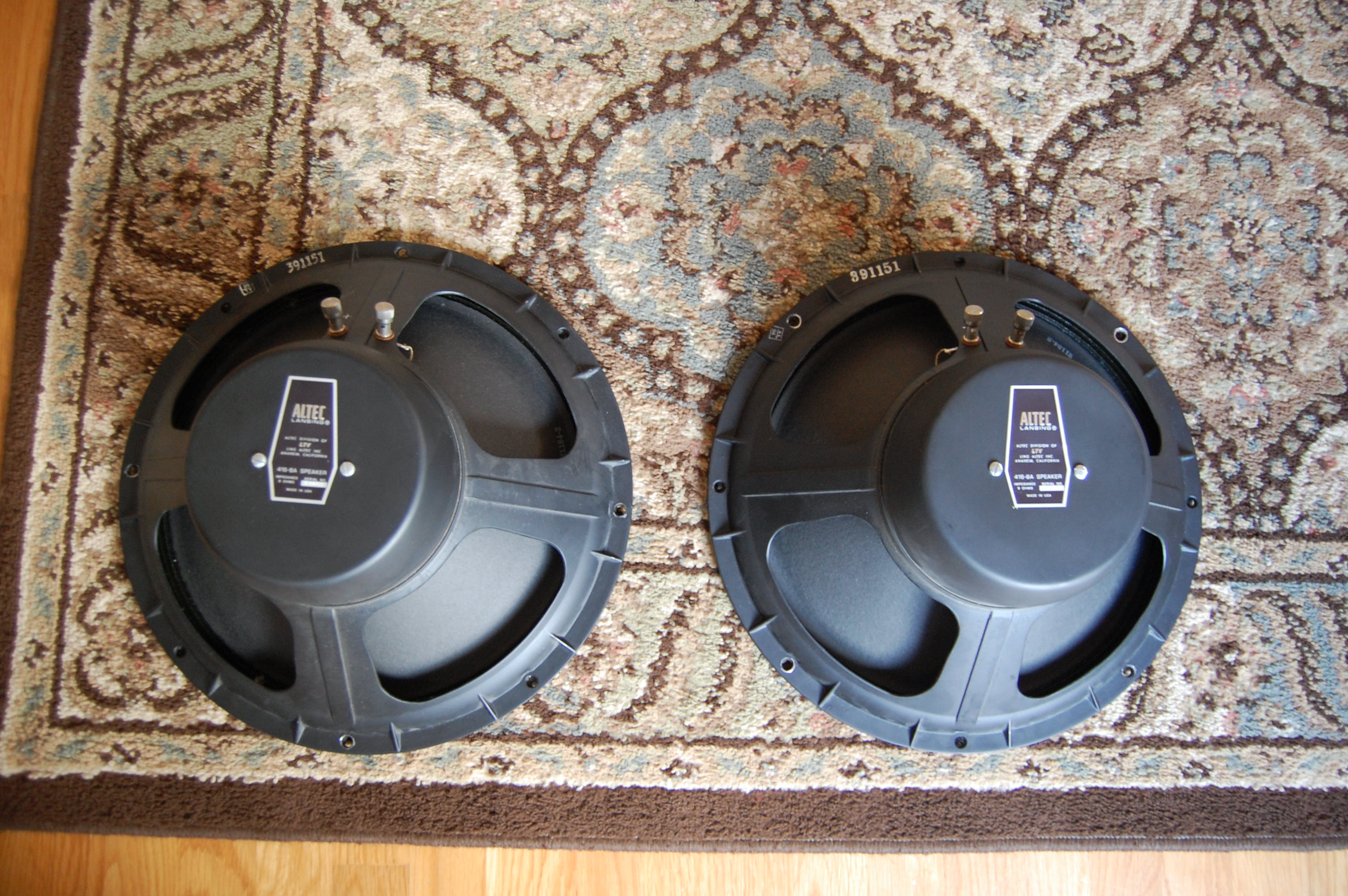

Ha. I am now talking about the new 416A's i have purchased. Initial pics and numbers are a couple post back. I will probably testboth when i do so, but focus is now on 416. Nothin glike dealing with a child with ADHD, huh. Take a look. I am quite pleases with their condition.
Updated prelim numbers after 6hr break in @25Hz. Will cut a bigger hole in sealed boxes after Thanksgiving lunch.
