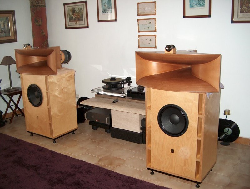

Hey buzzforb - here's some Altec bass type inspiration
http://www.diyaudio.com/forums/multi-way/223945-ale-acoustic-4-way-horn-speakers.html#post3248516
Whre do you find this stuff? That is clearly re-branded Altec/GPA. I am probably looking at 9-10ft^3 for my woofer and will go a little taller as well, as the Iwata is not as big vertically. Thanks for the info.
- Horn/TL combo
