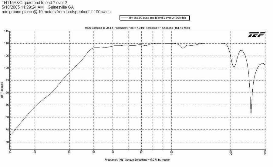

10% efficiency max?
Now granted I am not talking about a home sized horn woofer but I would ask you to consider a measurement of a couple of my Tapped horns.
The image below is for four TH-115 woofers in a two by two stack, measured outdoors in half space at 10 meters (-20dB from 1 meter) , with the four boxes in series parallel, driven at 28Vrms for 100 Watts into the nominal impedance (+20dB over 1 Watt).
The result is a conservative 1 Watt 1 Meter equivalent.
While the frontal area of four (80in wide, 45in tall) may be enough to cause some rise on axis from directivity, it is not large enough to do that at say 40Hz where the sensitivity is still over 108dB.
Here are links to the 115 and a couple others, granted none are conventionally loaded horns but they are still horns.
TH-115
http://www.danleysoundlabs.com/pdf/Danley TH-115 Spec Sheet_r2.pdf
TH-mini (one is over 102dB 1W 1M and its tiny)
http://www.danleysoundlabs.com/pdf/Danley TH Mini Spec Sheet_r2.pdf
TH-50 goes down low but with less efficiency.
http://www.danleysoundlabs.com/pdf/Danley TH-50 Spec Sheet r1.pdf
Best,
Tom Danley

Hi Earl
We measure larger subwoofers at 10 meters as the size of the system distorts / occupies some of the space at one meter, doing it at 10 meters and correcting for power more closely reflects the “1W1M” figure used to estimate the SPL at a different distance and/or power.
In this case, the nominal impedance is based on the 8 Ohm drivers, in band the impedance is actually higher than an 8 Ohm load.
That series parallel load was driven at 28Vrms to produce the measurement. In this case, using a nominal 100W drive level automatically compensates the 10 meter mic distance.
If one took these four drivers (15tbx100) and put them in the right vented boxes, close coupled, the 1w 1m sensitivity would be about 6 dB greater than one driver (96dB) or about 102 dB instead of 108 to 110dB mounted in the that particular Tapped horn.
From a source that has little or no directivity, 108dB to 110dB 1W sensitivity is pretty high.
If one defines “efficiency” as the difference between I^Rdc losses to radiated power, then yes 70% is very hard and not possible over any significant bandwidth.
What SPL would you expect to measure in half space at say one Meter while radiating one acoustic Watt from an omni source?
Best,
Tom

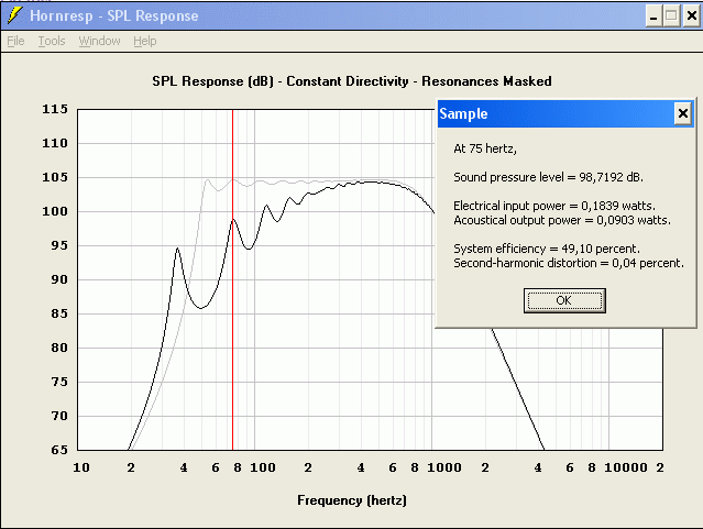

Efficiency - in numbers - is not something that I deal with regularly, but your numbers seem highly suspect to me. It would be very very difficult for the acoustic impedance to be greater than the electrical impedance. Your numbers seem to be based on HornResp calculations and I'm not sure where those come from. The only definition of efficiency that I know of is the nominal, which cannot exceed 50% as I said. I don't know what "true" efficiency is.
Doing the math, following Keeles paper cited earlier, gives the nominal efficiency of 45% for my example bass horn. (Disregarding Rms losses, since Qms for the driver is 10, which is high enough for this to be permissible).
I am fully aware of that nominal efficiency cannot exceed 50%.
True efficiency, which to me seems like a better description of reality than nominal efficiency (which may be useful for comparing numbers), since it directly describe the conversion efficiency of the system, is simply defined as
(Acoustical power output)/(Electrical power input)*100%.
Doing the math, again following Keele, for the true efficiency, this comes out as 65%. That it can be higher at some frequencies, is due to ripple in the throat impedance.
When you say "It would be very very difficult for the acoustic impedance to be greater than the electrical impedance" I assume you mean "reflected acoustic impedance", since the units of the two are quite different. But in this case, the reflected acoustic resistance (asymptotical value, rho*c/St) is nearly twice the DC resistance of the driver. Since the horn used is a Salmon hyperbolic horn (T=0.65), the value is larger than 50% of its asymptotical value down to ~50Hz, allowing high efficiency in a very large part of its operating range. (True efficiency at 50Hz is about 73%, while for a conical horn with the same length and throat and mouth areas, it is 1.22%).
To calculate reflected acoustic resistance, Rae, we need to know Re and Bl, which are 5.5ohms and 25.4Tm respectively. Rae, for Sd=0.038m^2 and St=0.0095m^2 as used, gives
Rae = St*(Bl)^2/(Sd^2*rho*c) = 0.0095*(25.4)^2/(0.038^2*1.205*344) = 10.24 electrical ohms.
This is however only possible with high-Bl drivers. Going backwards, for Bl < 18.6Tm, Rae < Re.
Compression drivers usually do not achieve Bl in this range, due to the small voice coil and practical B limits. Also compression driver efficiency drops significantly above the mass rolloff corner frequency.
Since both the analysis above and also Hornresp are based on classical and well known analysis of the electro-acoustical equivalent circuit of the system, I do not feel that the numbers are suspect.
If what you say were true then compression drivers would not even get warm, but the fact is that they melt down regularly.
Compression drivers can usually not achieve efficiencies like this. Also, they are usually crossed not much more than an octave below its mass corner frequency. In most of the working range then, nominal efficiency, which is based on the resistive impedances of the system, gives an inaccurate picture, and true efficiency would give a better idea. For pop and rock music (cymbals, distorted guitars etc) the power content in this range is quite high. Amplifier clipping also plays a part in feeding the driver with high frequency power.

Kolbrek said:True efficiency at 50Hz is about 73%, while for a conical horn with the same length and throat and mouth areas, it is 1.22%.
As I have stated, this detailed discussion of power and efficiency is not of much interest to me, at least not enough to sort out the details. But the above statement is once again quite suspect. This huge difference between the horns is not at all consistant with my experience and seems to be based on a ficticious theoretical loading achieved for an infinite "Webster" horn and not on realistic systems and data.
Tom's numbers seemed far more reasonable to me and those appear to be actual measured data.
Hi kolbrek,Kolbrek said:Doing the math, again following Keele, for the true efficiency, this comes out as 65%.
the simulations on the horn I originally asked about bring to me to a max SPL at 1m of 133 dB which is what I am roughly interested in - seeing whether the speaker can keep up with the rest of the system, ghost talk like 65% does not mean anything to me in the real situation - PA.
Cheers Dan
Kolbrek said:The Beyma 102Nd driver used in the example has very high efficiency-bandwidth product, with fs=53Hz and Qes=0.09. Things are of course different with less efficient drivers, my point was to show that it was possible to achieve the stated conversion efficiency.
this Beyma felt very sensitive, nonetheless the high sensitivity is only valid in the band of 600-2k so your predicted picture from hornresp seems pretty suspicious, it is just a 10 inch and I doubt its capability to move large volumes of air necessary to reproduce low frequencies.
The difference is huge at some frequencies, not at others. At 75Hz, the conversion efficiency is 49% for the conical horn and 55% for the hyperbolic horn. This corresponds to a peak in the throat impedance for the conical horn. At 50Hz there is a dip, giving the low efficiency at that frequency.
This is not the performance for inifinite horns. The simulation in Hornresp is admittedly 1P, but we are talking long wavelengths here, and the difference from actual performance should not be too different from reality. Many users can confirm that the Hornresp model is quite accurate when modelling bass horns, myself included.
The difference between different horn contours depends on many things. Short horns with large Sm/St (mouth area to throat area) ratio or long horns with small Sm/St ratio will show less differences than, say, a long horn with large Sm/St ratio, as is the case here. The horn is 3.8m long, Sm = 4.26m^2 and St = 0.0095cm^2. Reducing Sm to 0.5m^2 also reduces the differences.
The differences very much on the driver. As an example, by reducing Bl to 5, differences above 70Hz are quite small.
