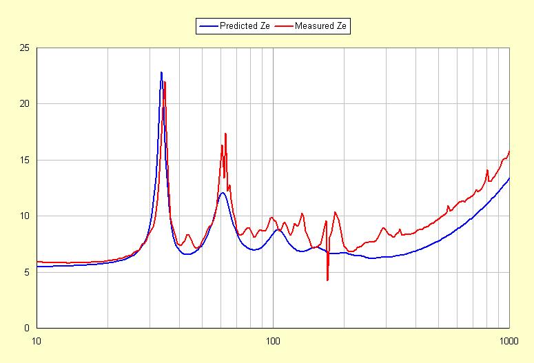

With regard to the "accuracy" of Hornresp results, the attached screenprint compares predicted versus measured electrical impedance for a given horn loudspeaker. I would have thought that the correlation is close enough for the program to be considered a reasonably useful design tool.
I think the real point that "Romy the Cat" is probably trying to make is that simulations can only take you so far. The ultimate test is how the loudpeaker actually sounds in practice, to the listener. I agree with this view.

The only things that Hornresp really needs to be aware of "about sound" are the solid angle into which the acoustical power radiates, the velocity of sound (assumed to be 344 metres per second) and the density of air (assumed to be 1.205 kilograms per cubic metre).

Having done a good deal of horn modeling myself, I will say that there are areas where its easy and areas where its difficult to impossible.
Modeling a horns impedance and its load on the driver is the easiest part. Thats because the Horn Equation is basically an impedance equation - it is one dimensional. But the true wave motion is three dimensional and as such any aspect of the horn that requires a good knowledge of the three dimensional aspects will be poorly represented by any model based on the Horn Equations - such as Hornresp.
In practice what does this mean? The simulations will be very good for impedance - as shown above - good for the very low frequencies where the wavelengths are much longer than the horn dimensions, but they will likely fail miserably as the wavelength starts to become comparable in size to the actual device.
That said, it turns out that virtually all contours act the same when the wavelengths are very large - only minor differences occur in the loading and the response. This is true for just about any contour with the same throat and mouth area and length. The connecting shape just doesn't matter that much. And where the shape does make a bigger difference, the Horn Equation is no longer accurate.

Of course!! I still use my SPEAK software, which is virtually an antique, because it is about 90% correct. The next 5-9% could be modeled with more comprehensive codes, but I find a compromise solution to work better, something I call "hardware in the loop". Basically, some of the analysis is a computer model, but some is actual measured data. With this approach I can get about 95-99% of the way. The last couple percent has to be done with real hardware as no model can get this close to reality.
I can assure that Hornresp is quite accurate as long as the wavelenghts considered are not too short in comparison with horn dimensions.
