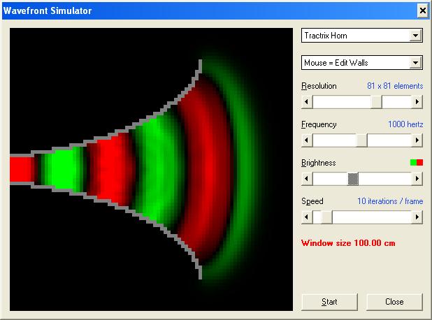

It is perhaps worth pointing out that Hornresp uses an isophase wavefront model for single-segment horns, rather than just a simple traditional Webster plane-wave approximation. ... The analysis is still of "one-parameter" or "1P" form.
I'm hoping that you will explain this (isophase wavefront model )as I am not sure that I know what you mean unless you are saying that the analysis is based on the "one-parameter" forms as defined by Morse in "Vibration and Sound - 1932"- which are still based on Websters Eq. And if you don't use Websters Eq., then what do you use?
If it is the case that you are using the "1-P" approach, then I think it noteworthy to point out that Morse himself dropped the "1-P" approach in his later book "Methods of Theoretical Physics - 1953" (which post-dates "Acoustics and Vibrations" by a couple of decades) for good reason. He defines the only place (to my knowledge) that puts the true limits on Websters Equation and shows how a "1-P" solution is vitually impossible in any device of a significant size. Only a full solution of the full Wave Equation has ever been shown to be accurate for a horn/waveguide at wavelengths comparable to the waveguide itself.
gedlee said:I'm hoping that you will explain this (isophase wavefront model)
Hi Earl,
Hornresp assumes that the wavefronts travelling down the horn are curved, not plane. The actual shape of the wavefront, and hence the rate of surface area expansion, are determined by the flare profile of the horn.
The attached screenprint of the default tractrix horn in the Hornresp Wavefront Simulator tool will give you some idea of what I mean.
As mentioned before, the model is not perfect, but it works for me 🙂.
Perhaps your approach is proprietary and I understand, but as a physicist I am still interested in your math. One cannot simply assume a curvature and determining what it is is the critical point. And what about the diffraction caused by too sharp of a curvature such that the wavefront cannot remain attached to the surface? How is that handled? These aspects don't affect the loading of the horn, or the axial response to as large degree, but they are dominate in determining the directivity. Its one thing to predict loading and axial response, but its an order of magnitude more difficult (or more) to get the directivity right. To me, waveguides or horns are dominately directivity control devices, the loading is pretty much irrelavent.

Hi Earl,
I agree. Hornresp uses finite element analysis techniques to construct the wavefront shape, taking into account the flare profile geometry of the horn.
It's not 🙂. I've never said that Hornresp is perfect 🙂. The program was originally intended to be used as more of a teaching aid than a highly accurate simulator.
User feedback would indicate that bass horn predictions are not too far off though, and I have received data from the P.audio System Company in Thailand (who also use Hornresp) showing that the program can be reasonably accurate when considering mid-range designs with compression drivers.
Once again, I have to agree 🙂. It took me more than 12 months to develop the Hornresp directivity model. Polar diagrams generated by the Directivity Pattern tool have been checked against horn directivity data published in Harry Olson's "Acoustical Engineering". The comparisons are actually not too bad, all things considered.

gedlee said:One cannot simply assume a curvature and determining what it is is the critical point.
gedlee said:And what about the diffraction caused by too sharp of a curvature such that the wavefront cannot remain attached to the surface? How is that handled?
gedlee said:Its one thing to predict loading and axial response, but its an order of magnitude more difficult (or more) to get the directivity right.
Kind regards,
David
