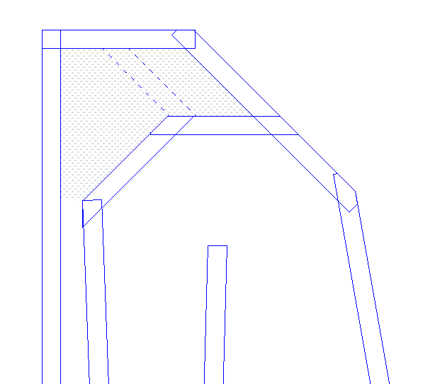

As promised, here comes the first picture of the drawing. I started an album at: http://picasaweb.google.com/florian.otel/A126HornBuildingPictures
Profile is drawn at 1:1 scale (noted dimensions in mm). Ply is 18 mm thick.
The CC:
(for a clear/full scale pic plus several pics of the same CC see the album link above)
While the dimensions match the ones listed pages 3--5 in the PDF (except some odd millimiters in the vertical dimensions on page 4), the area of this CC profile adds up to 111.775 cm^2. For a 15.5 cm wide front baffle the CC volume becomes 1.732 liters, quite a bit less than the recommended 2.2 liters.
Ideas ? Am I missing smth ? Greg, how did you get yours to be 2.2 liters ?

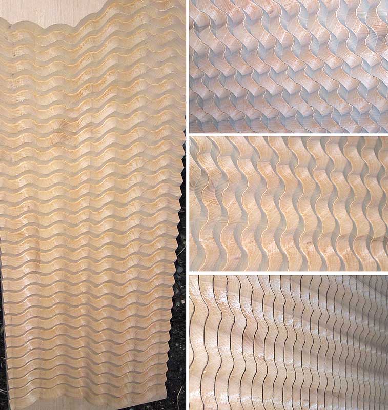

What Chris & i did was extend the top, open up the back, and then fill the CC with irregular stuff (including wavy wood) to bring it down to size). The expanded chamber is ~2.57 litres,

FlorianO said:Ideas ? Am I missing smth ? Greg, how did you get yours to be 2.2 liters ?
The only drawing that may have the correct CC is the jpg on page 2 (?) with the supraBaffle (nope is is at 1,84 litres).

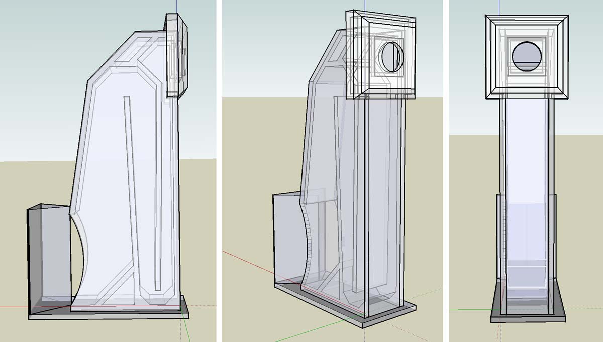

In the 3D visualization i just used the 1.8x litre chamber -- you can see the added void behind which gives room to expand (and to my mind cleans up the look of the top of the horn).

PS: sorry fpr the big pic -- it was handy)

Wrt increasing the volume of the CC I was thinking along the same lines as in your picture. It will both give me the cosmetics and the added volume (and maybe a side effect in improved cabinet bracing ?)
OTOH I can very well go for the SB and get the added volume that way.
Or maybe lee' bit of both 🙂

FlorianO said:One more uneducated question: Did I understand it correctly that filling a (slighly) oversized CC with corugated stuff like egg cartons / polyfill / profiled absorber "sponge" is equivalent to reducing its volume ? The reason I'm asking is compensating for the extra volume when e..g. adding a dobule-layered SB.
No... what you add needs to be solid... we added wavy wood...
