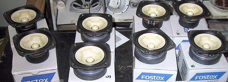

What are some of the mods people do to these drivers, I have seen alot of pics with something on the basket, but i cant find waht that is.
thanks
-greg
thanks
-greg
Start here... there is a link to a thread that describes the 1st crack at it ... the process has been refined somewhat. In my queue is a more up-to-date page describing the mods. If you have any questions email me.
The difference between a stock driver & a modified one are not subtle (but it is possible to go overboard)
dave
dave
