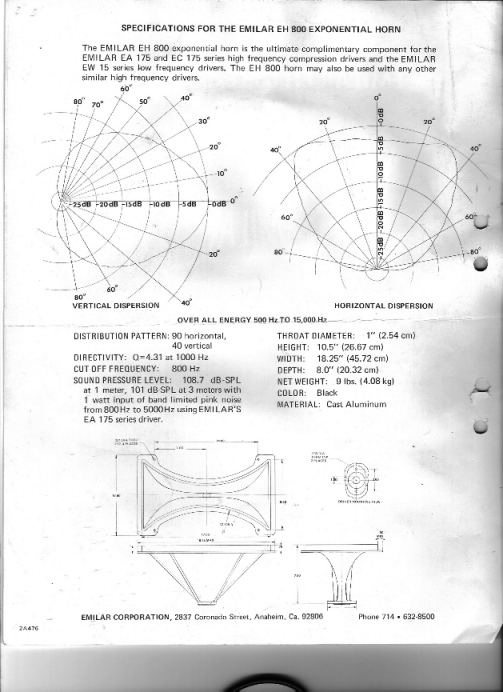

Emilar 500 Hz horn
Joe
A friend of mine has a pair of Emilar 500 Hz horns, which seem to be recycled from old big block Chevy iron...... serious castings to be sure and no resonances that I can detect.
The horns came from the BB King organization the TAD 4001's bolted to them surplus from the Disney folks in Winter Park and blessed by one of our favorite recording engineers.
They sound fantastic..... but I think the combination has an intelligence where by they just know what music is supposed to sound like.

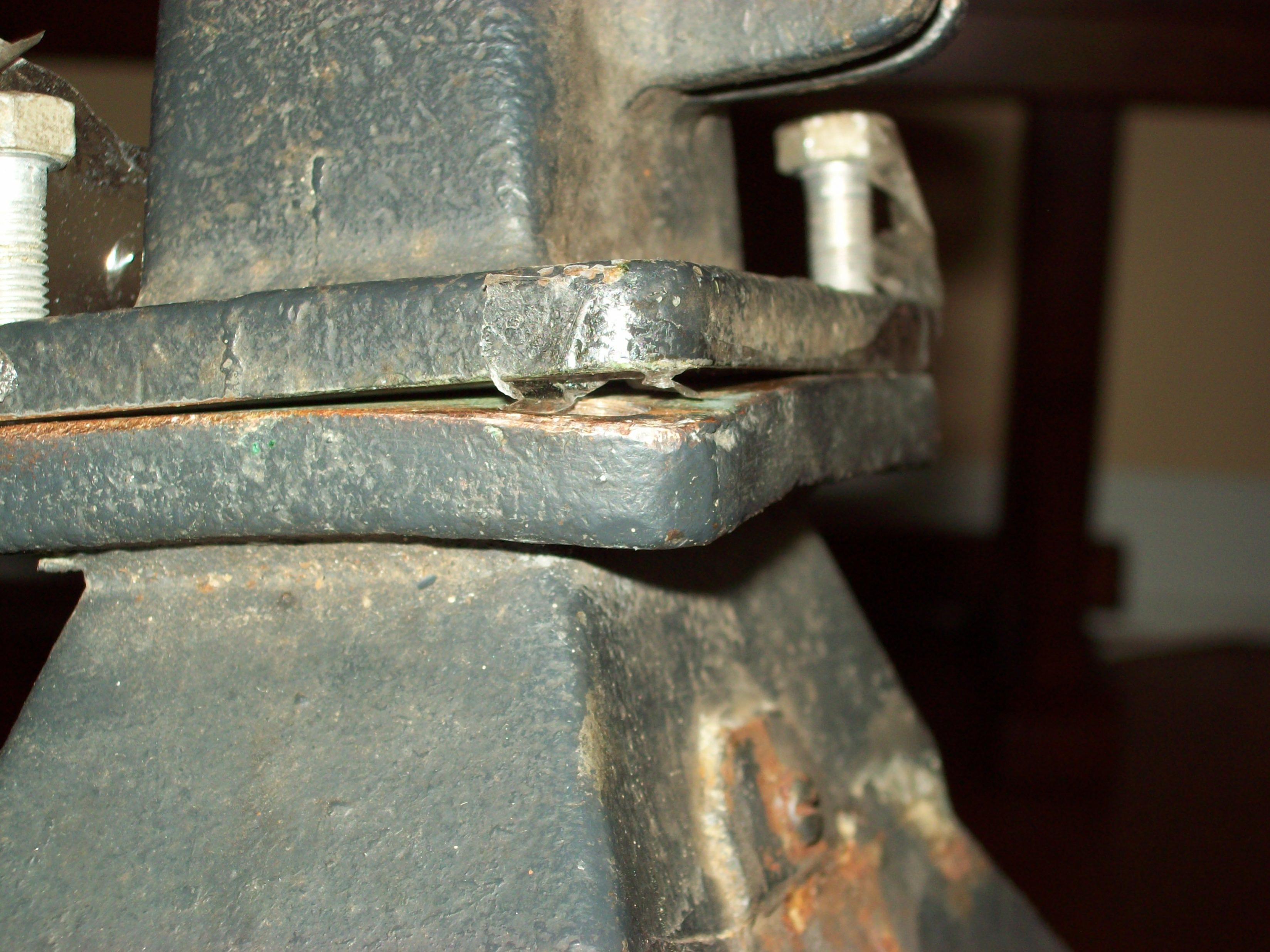

limono, that could be tough to straighten. Now that the metal has been sent into compression, straightening it out might just bust it clean off. I would take it to a blacksmith so they can heat it and straighten it out properly. It will be worth every penny, 'cause as everyone knows, next to the big multi-cells, that 811/511 family are some of the best horns ever designed and built in the history of mankind.
Limono is in Chicago...not exactly a blacksmith on every corner anymore up in The Windy City.
I, on the other hand, live next to Colonial Williamsburg. I actually know where I can find a blacksmith. Hell, I can even find a farrier or candlemaker if I need one.
