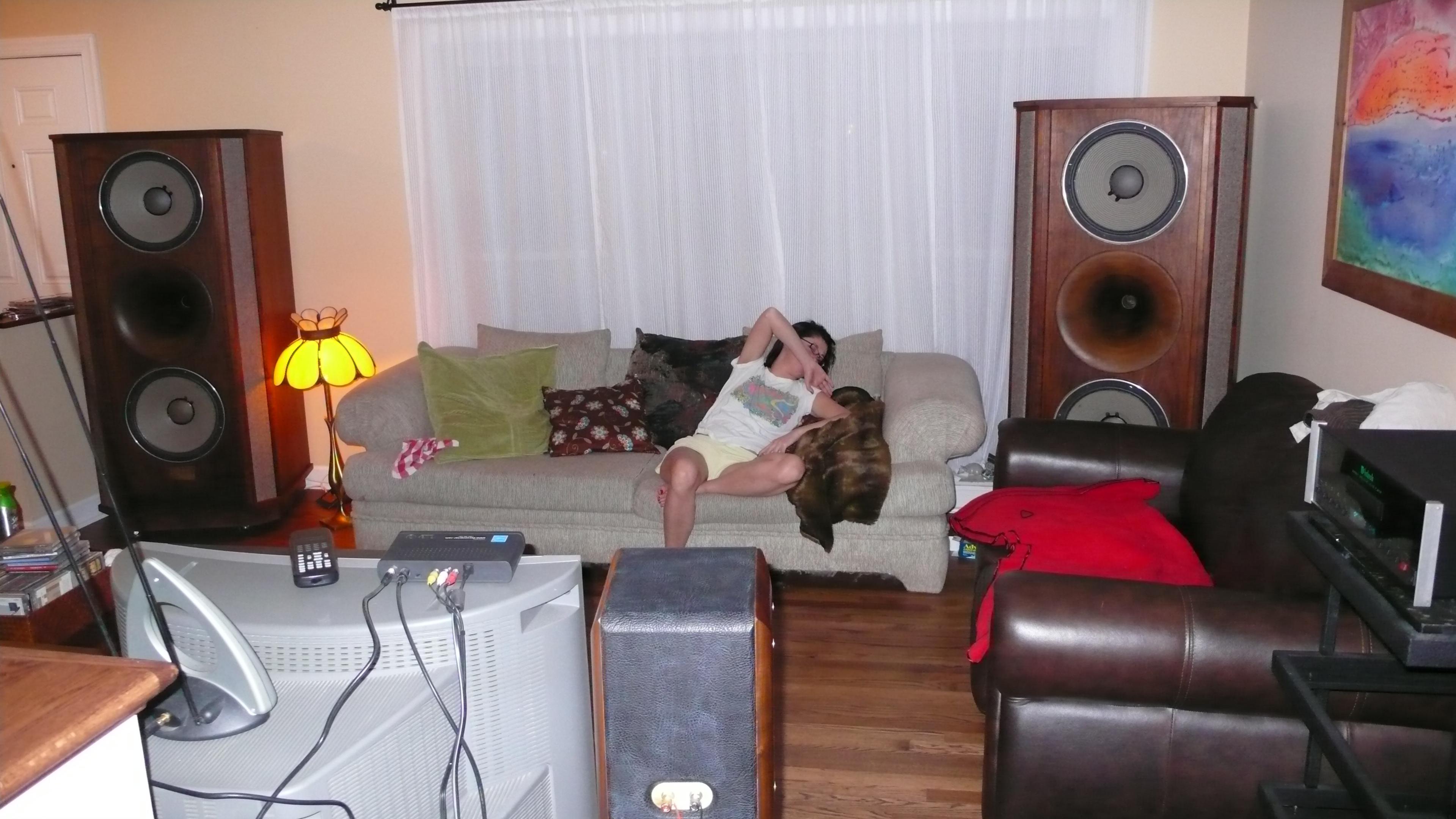

I'm not sure what drew my eye more, the female or the speakers O_O.
"Female " would be furious If she had known I post this all over the net hehe Thankfully only a few read DIY audio and the few of the few bother with horns and altecs.
The speakers are not good , meaning the basic concept is bad ,they are going to be equipped with Tannoy 10" in the middle. Custom cabinet costed $6k to build and original Tannoy cloth was imported from Britain (I heard it costed pretty penny too). Sorry for OT post. Back to altecs.

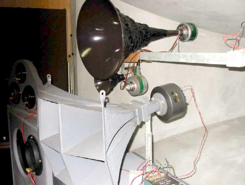

Is this the same person who suggested he could use that overgrown soldering torch for applying SBS roofing the horns? limono my friend, methinks you might want to turn your thoughts to a blast furnace to straighten that baby out. Even a roofing trigger torch might leave you wanting.maybe I heat it up with propane torch and see if I can tap it back.
Cal Weldon my friend , you behave like typical yankee although you're from the woods. If it isn't written in instruction manual for young roofers it can't possibly be done. Sure it can.
You heat up the lip of material to the melting point and stick to the horn,than you lift the other end and gradually melt the sbs applying to the surface, than you can use a knife , small pry bar to lift edges around perimeter and melt it until the tar flows from the edges when applying pressure .Wait for it to cool and clean it up (cutting it off) I used trigger torch to apply SBS to sides of cabinets melting the pads on the concrete floor and putting them on while still hot with few staples to ensure the edges won't lift.

limono, that material is bronze. Cast. Obviously somewhat malleable.
You can't simply take it to a blacksmith - and yes there will be blacksmiths somewhere in or around Chicago... it's hard to get at the flange to wack it.
The flange is soldered/leaded onto the end of the horn.
One *might* desolder it and remove it. I'd not risk the rest of the end coming apart - not good.
If it were mine, I'd make a rig to straighten it.
Steel bar, about 3/4"- 1"thick. Three holes where the holes are now for the mounting of the throat adapter. Place bolts in there. Two choices, make an over size hole for the bent end and try to use a bolt THROUGH with a NUT and washers on the other side. OR skip the hole and clamp.
So with the bolt you'd tighten up until the metal pulled back - you could apply judicious propane to the point of the bend. OR using the clamp/vise, you'd use the clamp to do the trick.
I'd probably relieve some of the metal of the steel jig where the bend radius is, so that you can pull up past the flat point by a very little bit, so the springiness does not make it pull back from flat.
The bolt method may be needed because it will be hard to grab it otherwise, gotta try a see. A nice sized vise will put a lot more oomph than a clamp.
The other way is to put it on a hydraulic press - like the ones they sell for auto shops, machine shops, and jig it in on some steel bars or the like and just push down over the bend to flatten. That is easiest IF you have access to the press. If I had a choice I'd go with this myself. Harbor Freight sells 'em... maybe you need one? 😀
When you are all done, run a fine flat file over the surface, flat in order to take off any hump that might have been created... a dead perfect fit between the throat and horn is not required if you use a gasket of any sort.

Oh I know it can, and I'm glad to hear you have the where with all to do so. Too many venture in on a wing and a prayer and then live with the consequences. I'm not kidding when I say, I saw a fellow trying to torch down his carport roof with a plumber's torch after reading about it on the internet. They forgot to mention the roofing torch and plumber's torch are a little different.Sure it can.
Onto the important question...why SBS? If you are going to attempt the damping of a horn with a sheet material I would stay away from the asphalt based products and use the EPDM detail membrane. It's self adhesive, it doesn't stink, it isn't messy, it will conform to compound curves and is easy to fix when things don't go quite as planned. Even an old torcher like me would have a hard time making a horn look good with SBS.

You're correct . I used torch down because I had scraps of it. EPDM is probably much better choice although more expensive. Hard to make any damping to look sexy
