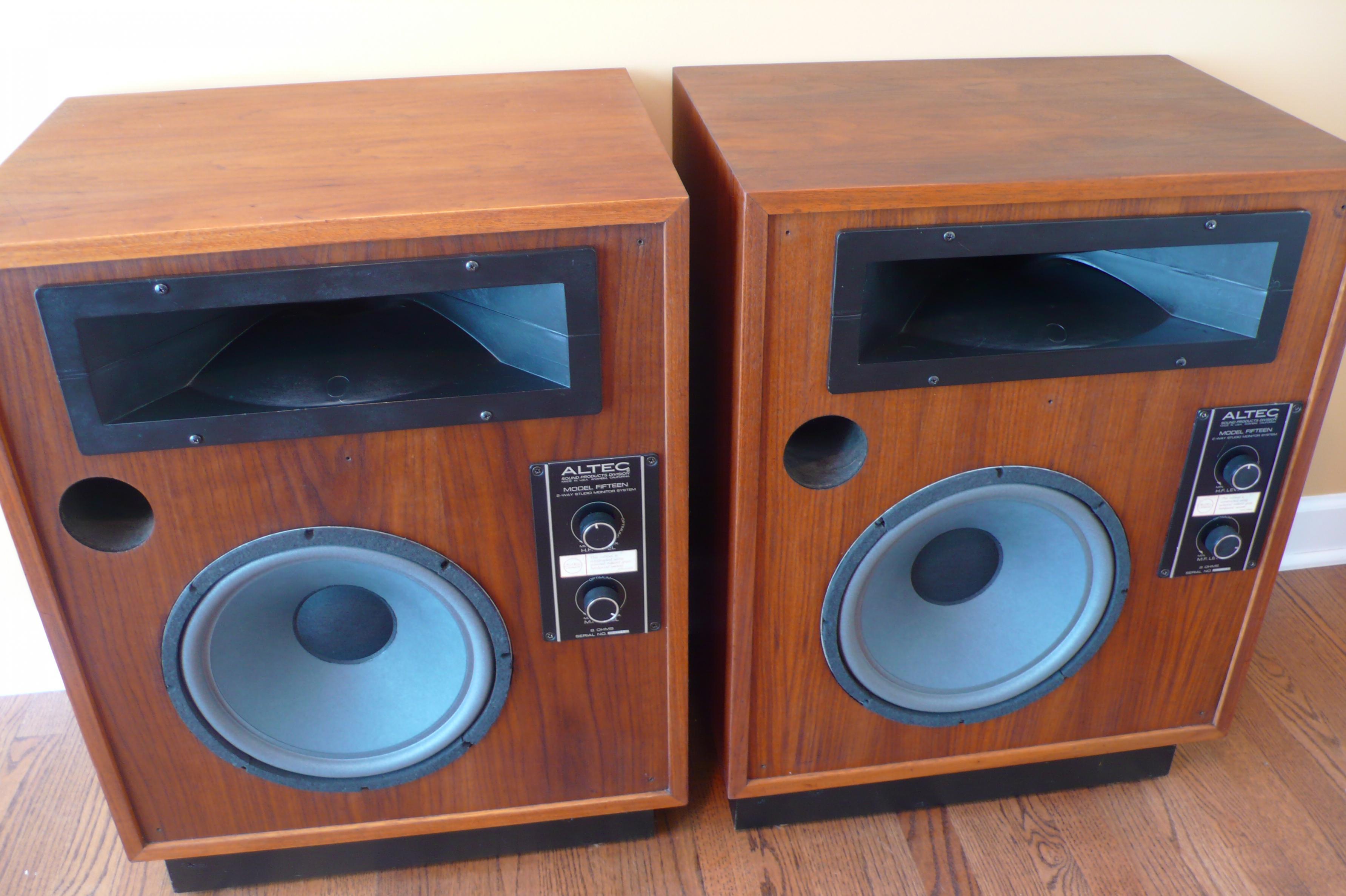

Undampened the 511's gave me ear fatigue. It took 1/2" of auto undercoating to get a thunk.

I had considered lightly sanding plastic horn back with rough grit, then gluing some flat lead wheel weights (the type used for inner part of wheel, not the lip) with urethane windshield adhesive. The eurethane is messy, but it's easy to get at any autoparts store, along with wheel weights 😀 I don't care about extra weight... It's not like I am going to cover the whole thing completely. You can cover as much of the horn as you want with the urethane, and is as many layers as you want I suppose.
I have plastic horns too, and I'm not sure what the auto undercoat will do to them, so I was planning on using RTV and lead shot.

My unscientific advice says that gluing lead weights to a plastic horn is a waste of effort. You are better off rough sanding and covering the back with modeling clay. Or making a conic rear covering and filling with sand (for example).
RTV and lead shot? Very confusing, and smelly... not likely to really bond well... maybe if you were able to seriously rough up the surface for a mechanical hold. Lead shot? Nah... you want something much more able to be in suspension in the RTV and not sag out... sand? Glass beads? Then you want a two part RTV so you can actually mix it up... not the stuff in the tube...
I'd rough it up with like 20 grit, and try the latex mold stuff they sell in the crafts stores, and paint on a few layers, like do it for a week... build it up, with maybe sand or glass beads mixed in/and/or sprinkled on. Yeah, it won't have a 20 year life, but so what? Doesn't smell bad either.
The conic rear (or boxed, or triangular, etc depends on the shape of the horn) filled with sand (seal that with silicone rubber!) is guaranteed to be most effective of all.

My take is to use bitumen torch down material they sell to cover flat roofs. You just buy one roll of tick bitumen for $70 which is 3'x33' and hand torch from home depot ($10 or so) cut the appropriate pieces melt the sticking side and apply to the surface . You need to be very careful not to burn yourself. It is equally good to damp speakers enclosures. I've got the idea when I looked inside Proac cab and spoted bitumen pads. You can apply few layers one over another. Quite effective .

Have to agree with Bear here...these horns sound like they are ringing even if you completely cover them with raw meat.
I once encased a 511 with a layer of plasticine modeling clay that I found at a Dollar Store. Cost $30 for 30 packs. I also cut the welds in the vanes and installed rubber strips, as I saw done on a very old Altec sectoral with gray paint...led me to think this was the original design intention to damp bell modes.
Dang 511 still had a ringy edge. I concluded that it is in the geometry.

But I put in my time with these particular horns, tried clay, sand in latex paint, cutting the vanes with a cut off wheel and inserting rubber like the old ones, sandwiching them between phone books with weights on top...measures that should have fixed any metal bell mode problem and I still wouldn't pick a 511 up off the street.
As mentioned above, I think the problem is in the geometry. Maybe the cross-sectional shape transitions in the throat area? The rough crude casting in that critical zone?
