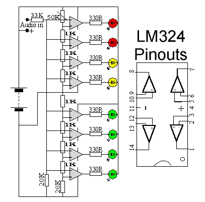

I would really love to build a 4-channel switch for my audio project using the previously mentioned MAX4709. I'm interested in this if it is less noise/distortion than simply using small DPDT switches. I would also like to have a switch that uses a single button to select each source.
I found this:
http://www.electronicsforu.com/efylinux/circuit/feb2003/Add on stereo channel selector.pdf
which looks very interesting but I'd like to use the much easier to find LM3914 instead of the KA2281 in that shem. Or better yet, omit it completely for a simpler circuit. I'm also curious what kind of distortion it might have. I've searched around the net a LOT but haven't found much (very little on ESP pages too). Anyone know a good schem for this kind of a circuit?
Can anyone comment on this circuit? I found an equivalent to the KA2281/LM3914 with opamps (see attached schem) and it seems using a MAX4709 should produce a very decent low-noise button select with this circuit. Any suggestions? This looks like it could be a really fine circuit.
