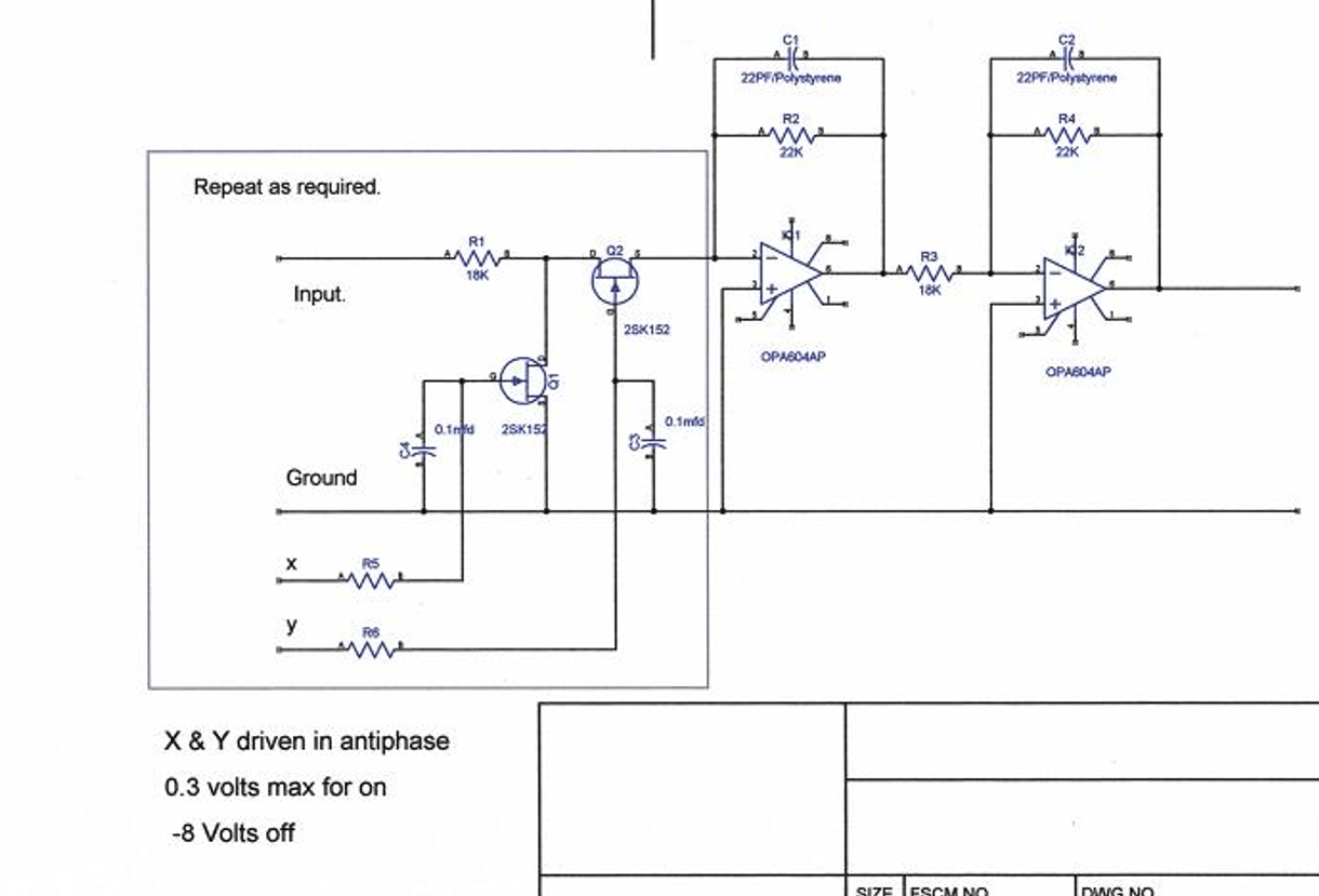

OK... it switches as many inputs as you want. Each input repeats the circuit shown in the square and the FET's source's all common together on pin 2 of the opamp. A mixer in other words...
X and Y in antiphase. That means that as one goes high the other goes low, except that here the levels are high = 0.3 volts and low = -8 volts. So as the series FET is on passing the signal the shunt FET is fully off and vise versa. I used a PIC micro and logic decoder to give full remote control, along with a normal rotary switch on the front for manual control if needed (remote not working or handy etc)

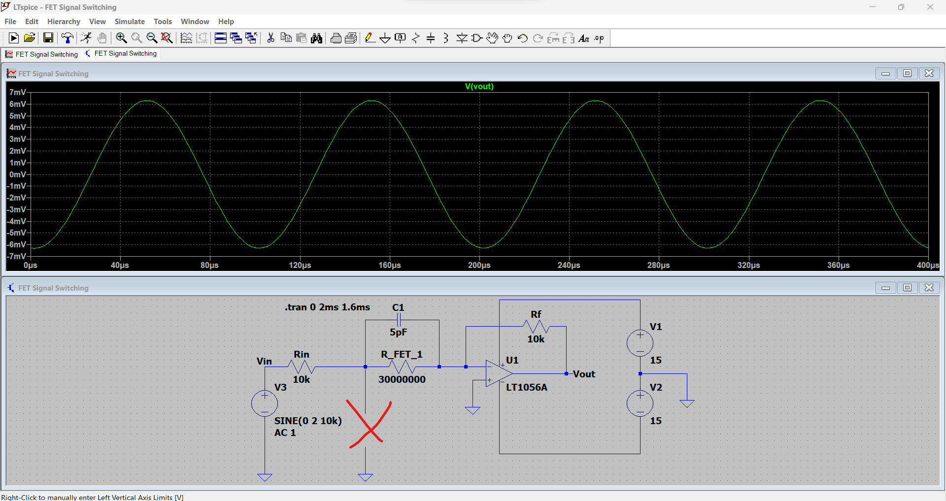

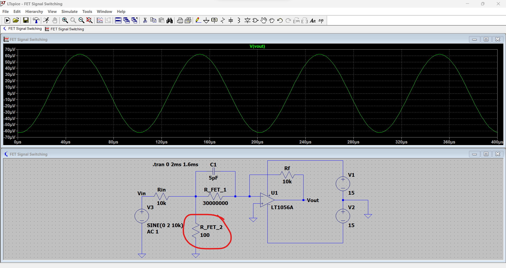

The second FET greatly improves the 'off' isolation. Look at this where the FET on resistance is set at a highish 100 ohm and the off resistance at 30,000,000 ohm. The 5pF is an attempt at adding the stray junction capacitance across the FET that is off.
In practice the isolation was so good that even a signal generator delivering a high voltage squarewave was totally inaudible even with the volume on full. The FET's I uses had an on resistance of around 15 ohms from memory (so much better than in this sim). I've set the off resistance to 30meg ohms but at low frequency it will be much higher.
Look at the scale at the left.

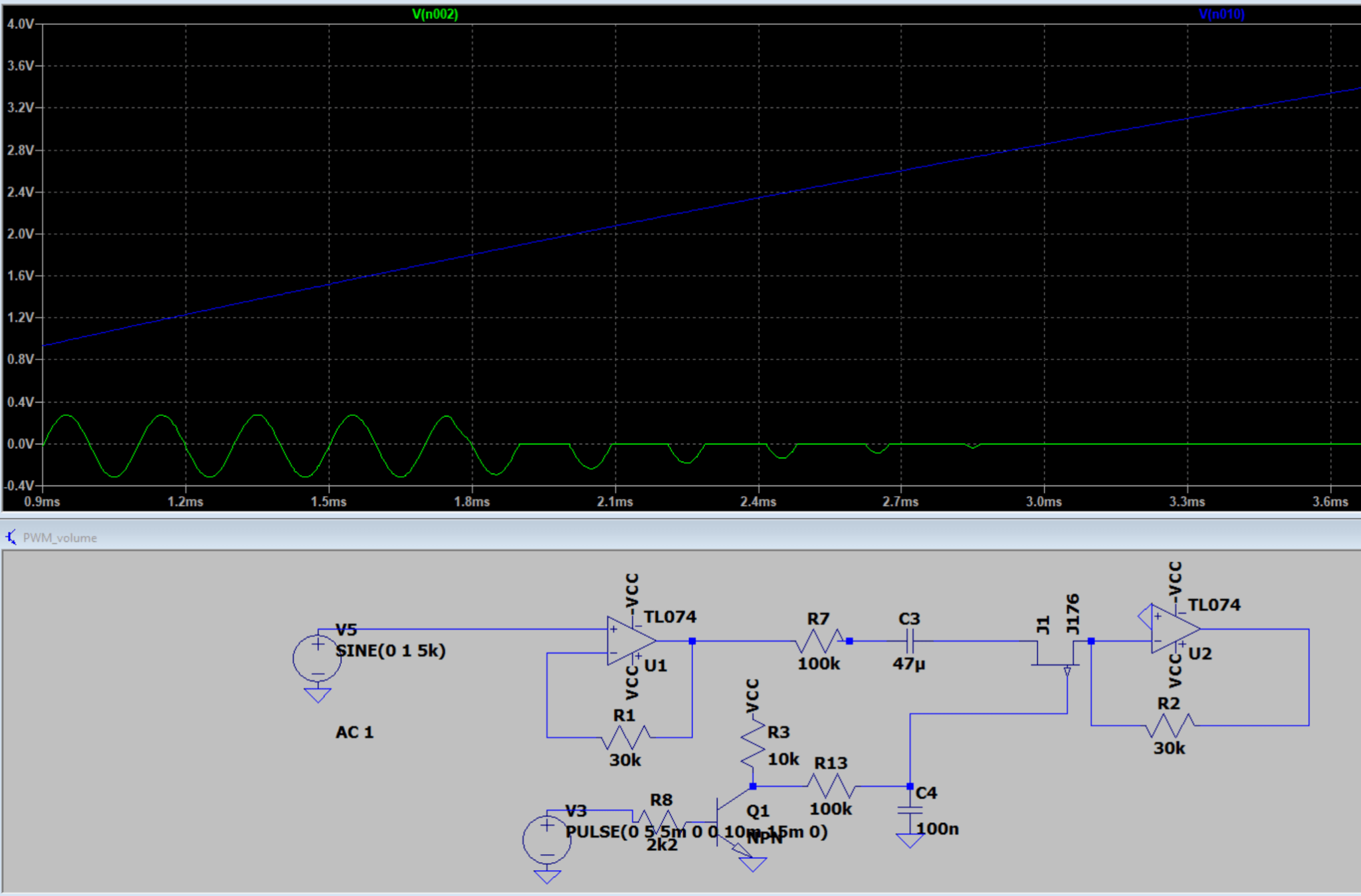

Hi @Mooly, thanks, that makes sense. I am working on a dj mixer and there are two sections where I need JFETS: CUE and Filter. For CUE it is acceptable to have a pop noise when a channel is activated, not for the filter though. So far I have been experimenting with one single JFET in current mode but I did not achieve the result I wanted. My simulation is very simple, voltage follower and inverting opamp with the p-channel JFET in the middle. In the plot below, the blue curve is the output and the green is the Vg voltage. The fading in is asymmetrical, when the input voltage goes more negative, the source voltage goes also more negative and the resulting > Vgs bring the JFET to cut off (1.82V for this j176). Now, I dont know how this would sound but I am pretty sure it is not going to be a smooth transition,,,the only way to fade signals with JFET is to use them in their ohmic region. Does this make sense to you?
That all looks and sound very familiar and so I don't think you will achieve a clean fade with that configuration.
My final design for the input switching gives a noise free switch although if there is signal present at the inputs and the volume is turned up you can hear the distortion (the sort of distortion you show in the sim) during that few 10's of milliseconds as the FET gate voltage ramps up. My gate resistors were 1meg from memory.
If you use the FET as a shunt in its linear region you will never achieve a high 'off' value and the essential series FET (the one in your sim) is never going to pass the signal in a linear way during the transition.
