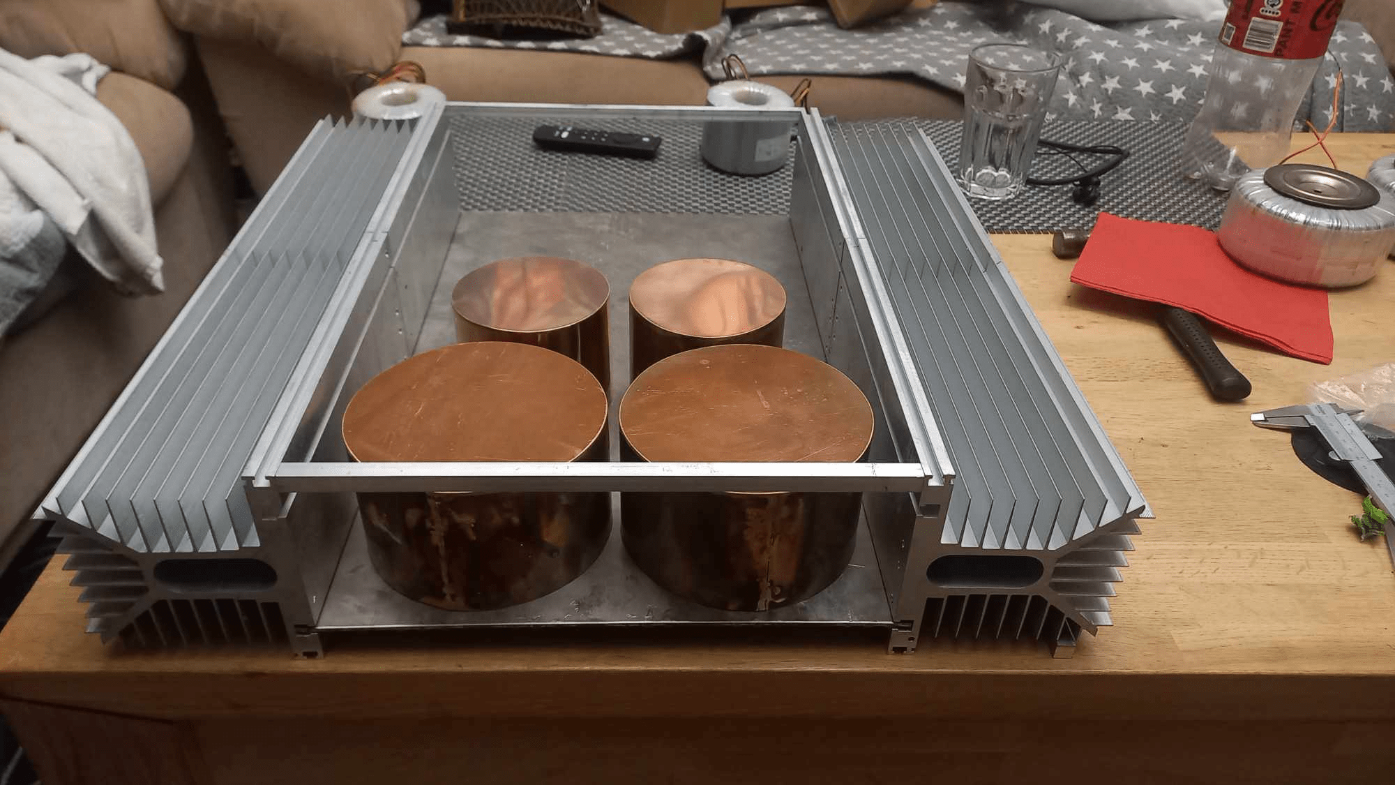

I hope its Ok i use this as a progress Log 😀 for myself too..

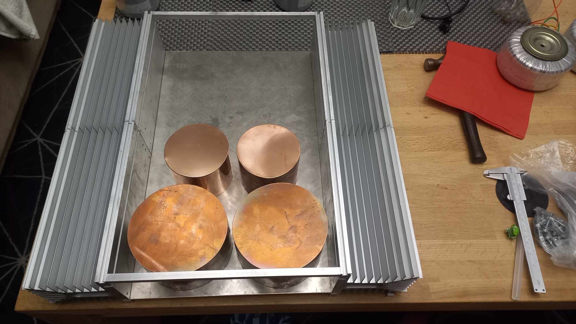

Finished milling the sinks. 🙂 buttem plate and half the chassis struts.
Of course, it is your thread! Nice progress 🙂

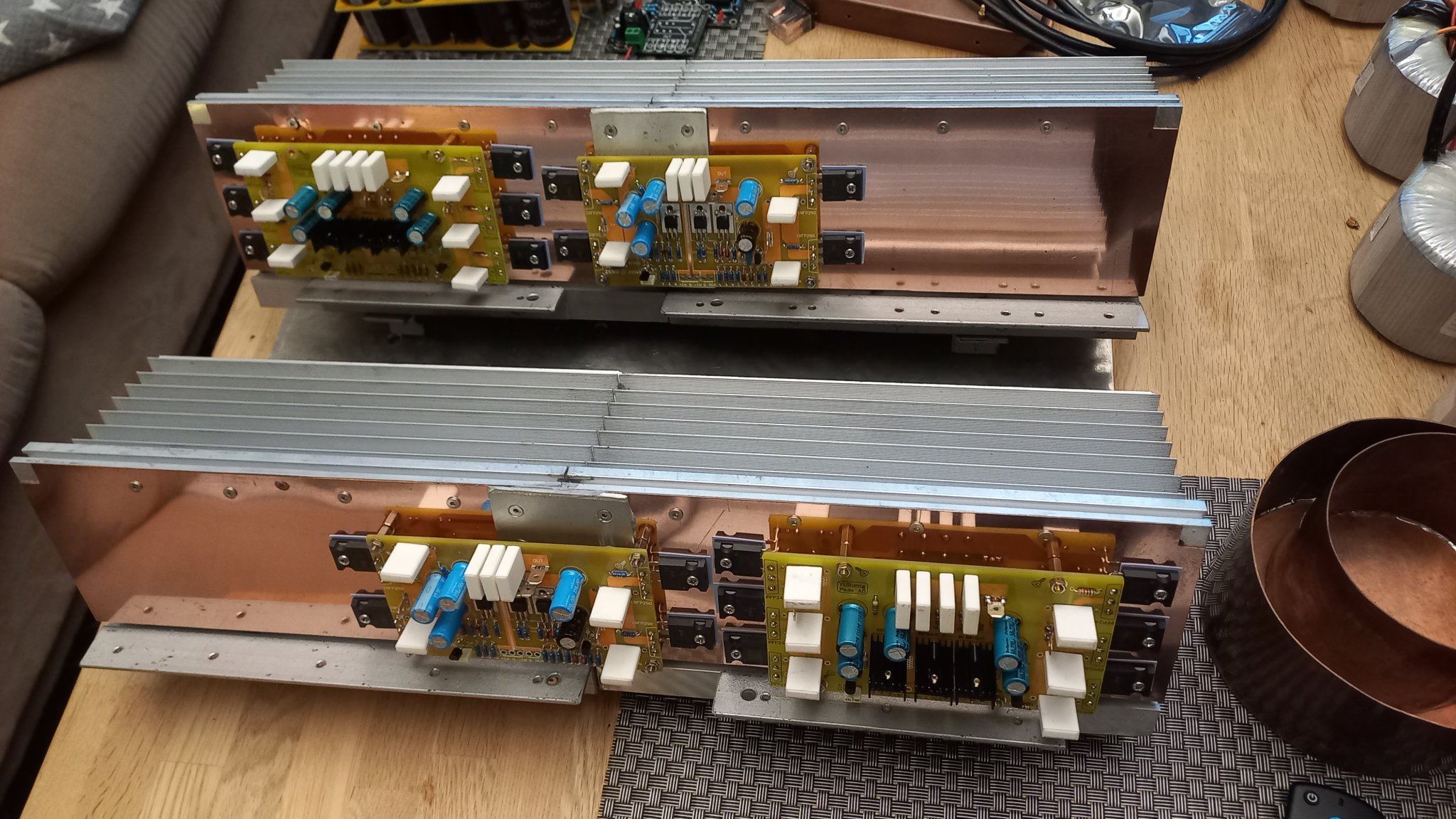

I don't know if it was talked about but the heat dissipation on the heatsinks being placed horizontally will be lower than if they were verticle. The heat has a harder time rising. With that being said, you may have so much heatsinking that it is not a problem.
Yeh i know.. thats why i watercooled them.. 😀 (the core is hollow so ill just run a loop trugh it.. i mean i went purely for looks.
I could even just add a temperature controlled 120mm fan to the back. of the sinks if i wanted to make it easyer for myself.
The fan would make it better than any vertical mounted sink anyway.
And as a bonus you would have your very own 600w electric heater under your TV... i mean Win/win right? 😀
Ahh, I see. Pretty cool! I suspect that you will be alright. I didn't go back and read through the thread but I assumed that you probably had your bearings straight. Looks good 🙂
I always listen to suggestions. 🙂 theres no way i can think of everything..

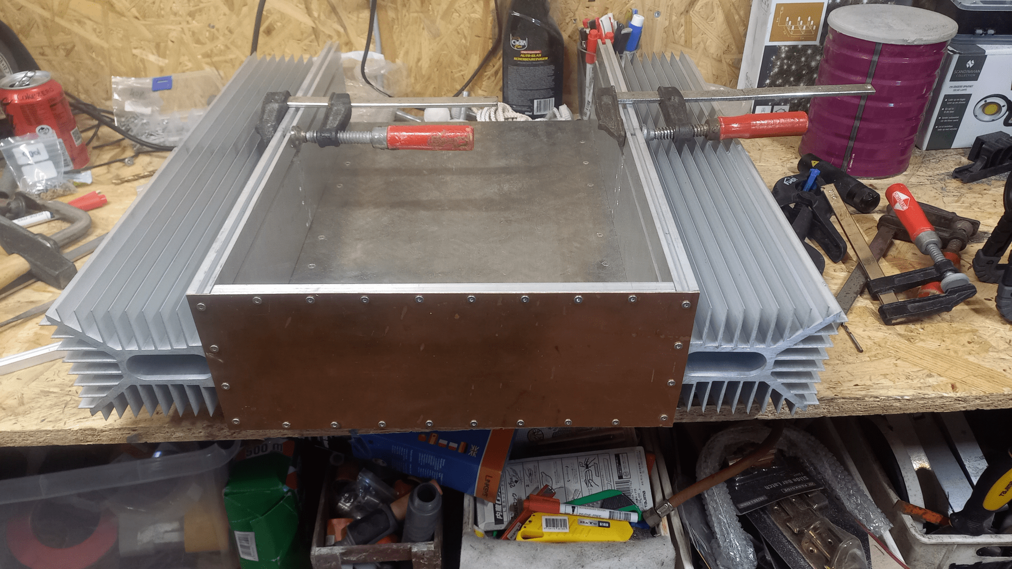

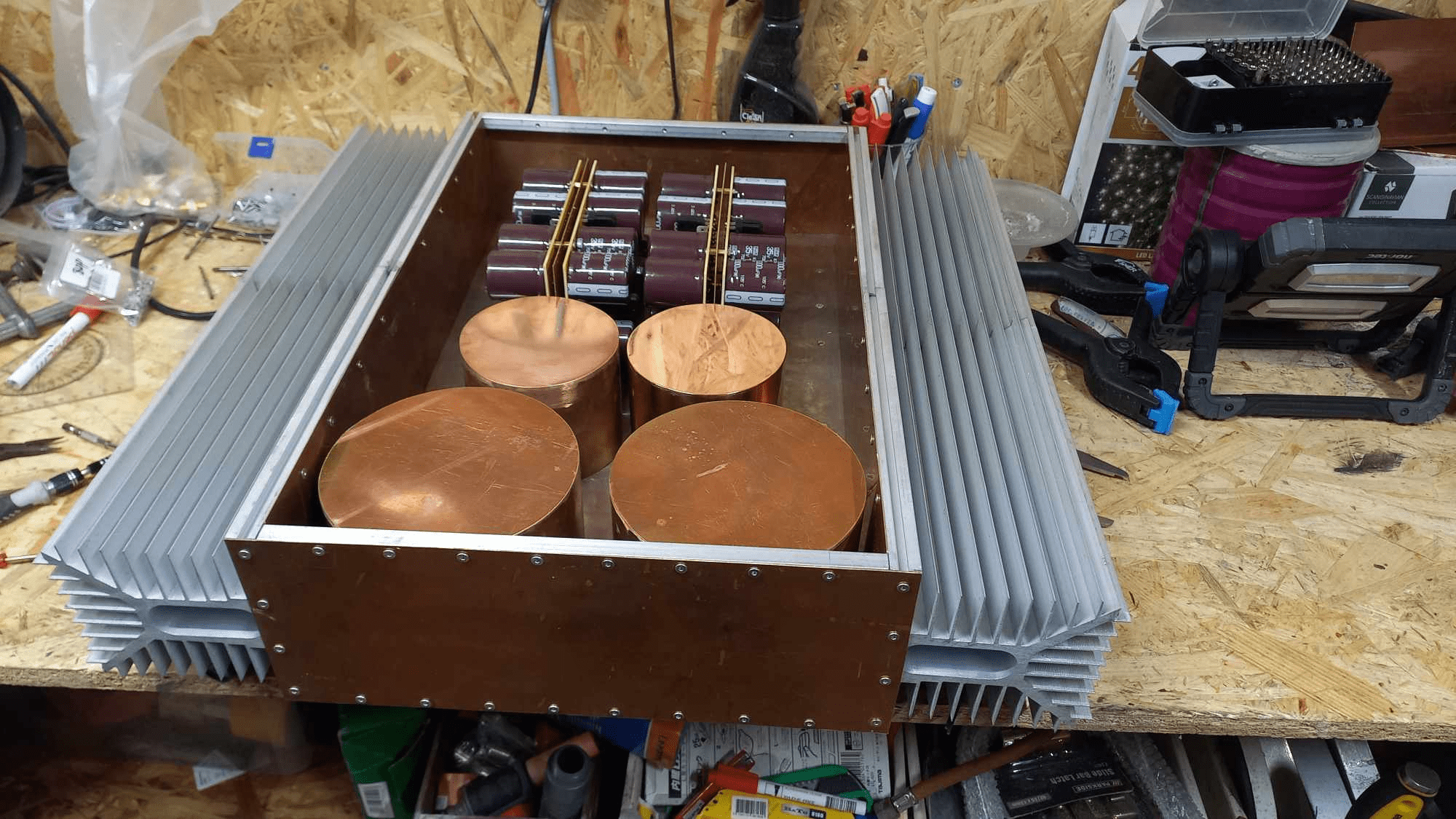

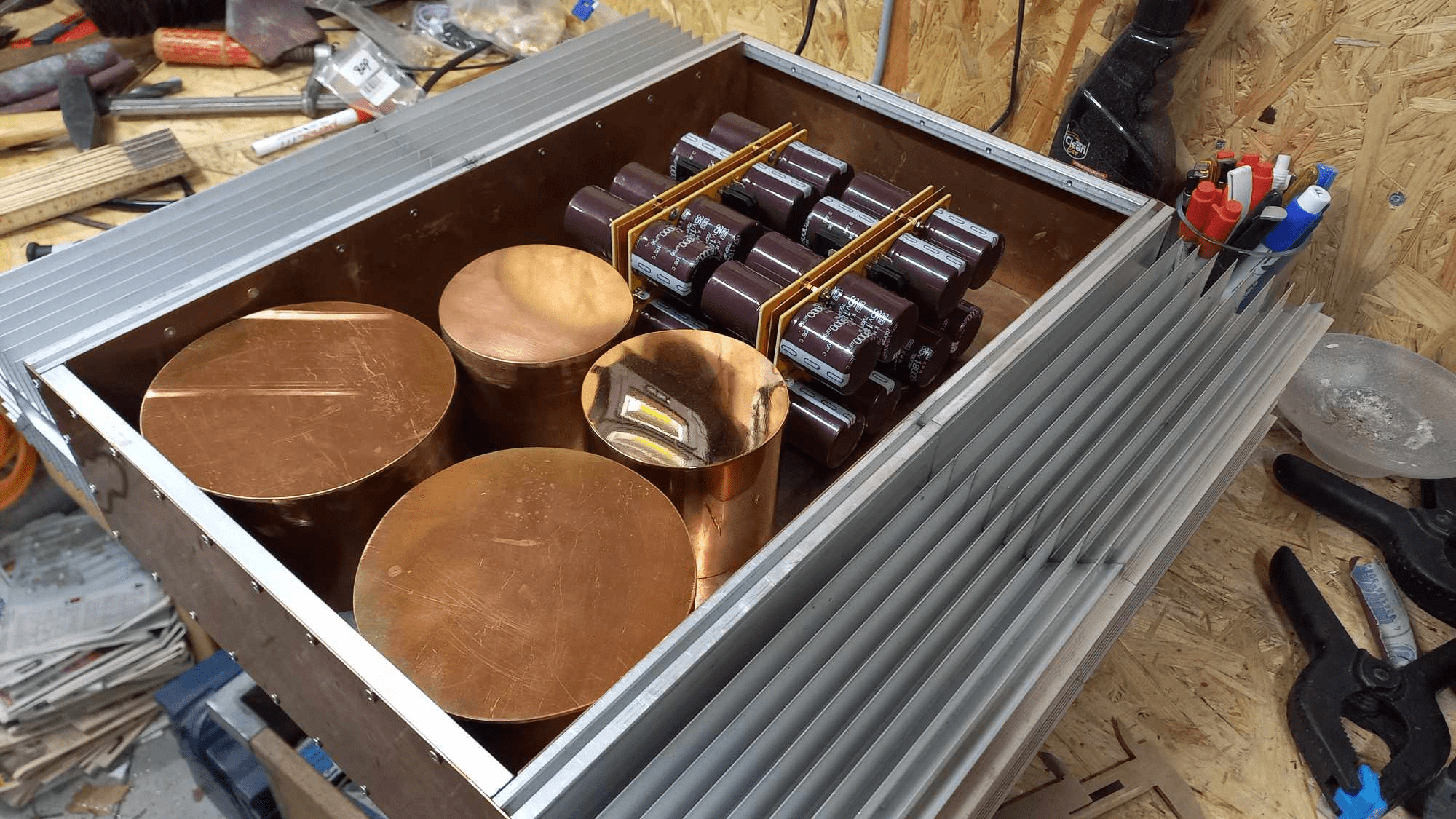

That is some fine metal working on those copper transformer covers.
In the interest of providing extra information, copper will be excellent at shielding electrical fields, but much less effective at shielding magnetic fields. Other metals such as annealed nickel-iron alloys or even tin can help more with magnetic field reduction.
It’s possible that magnetic fields may not be a problem with your channel boards, so this could simply be something to consider for future updates.
shuldent copper go into the "fine" or "good enough" category here ? i mean its not steel but its 1mm think copper plate.
The steel domes you can buy for toroids are only 0.5mm (the ones i found)

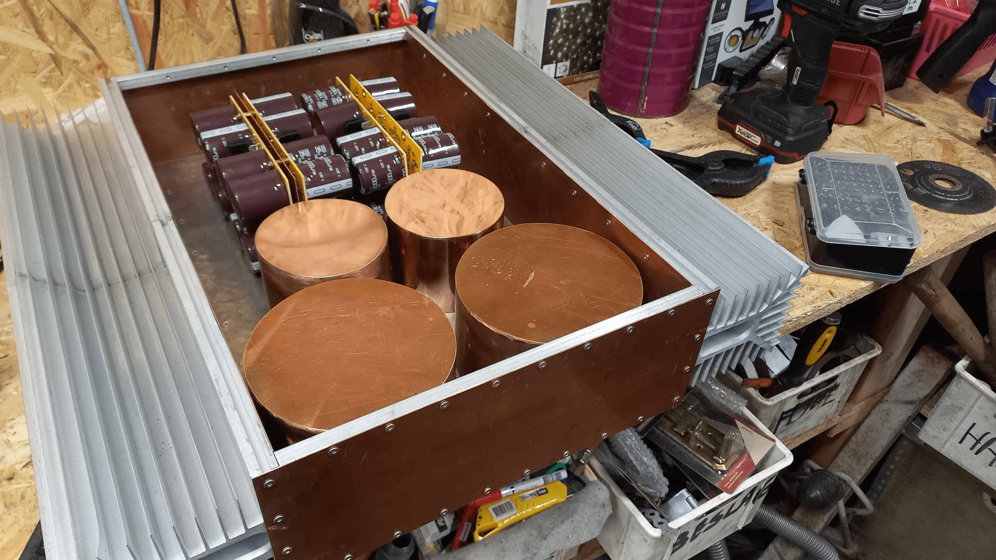

its the same hight as the domes so 0 cutting is needed.

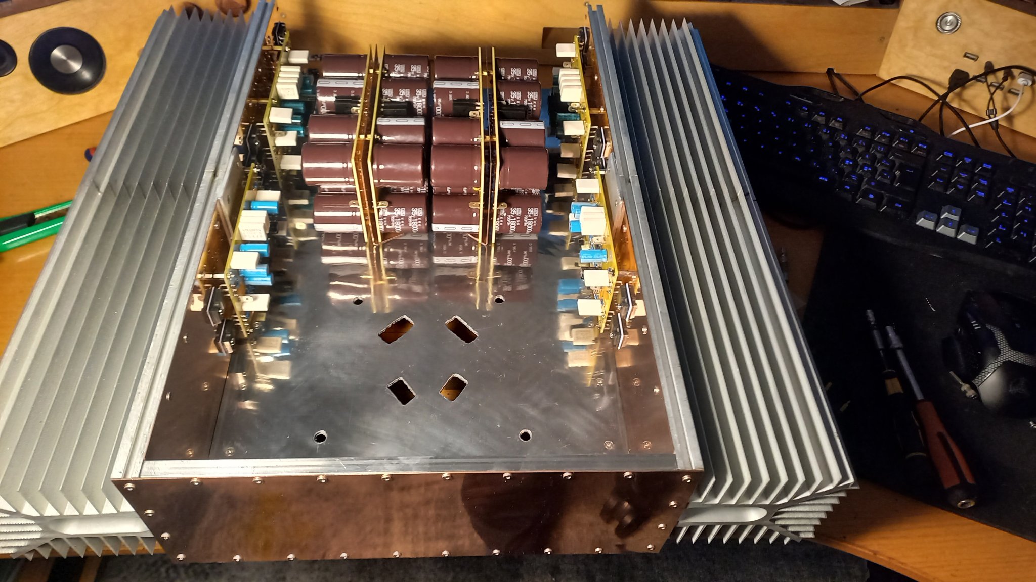

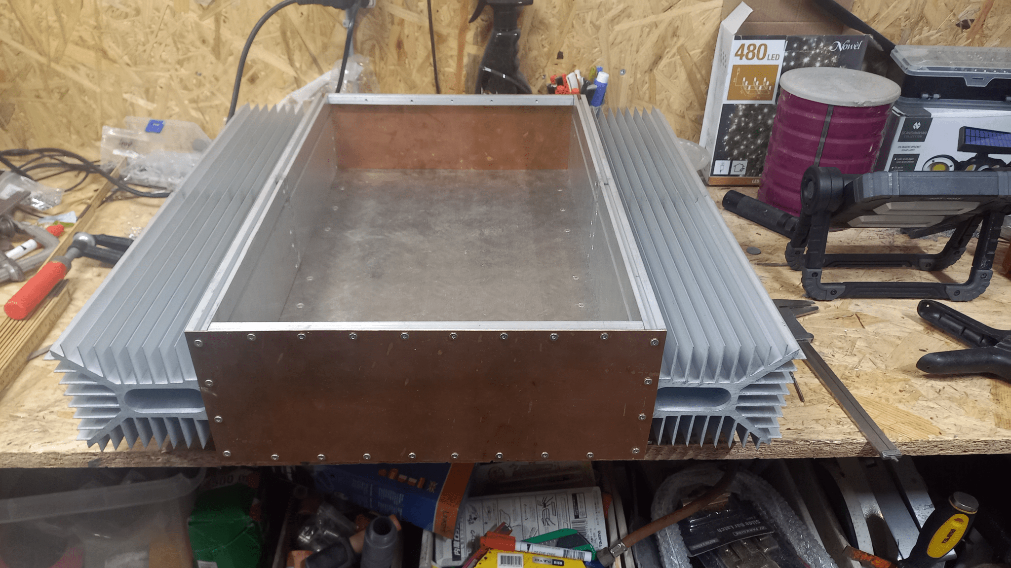

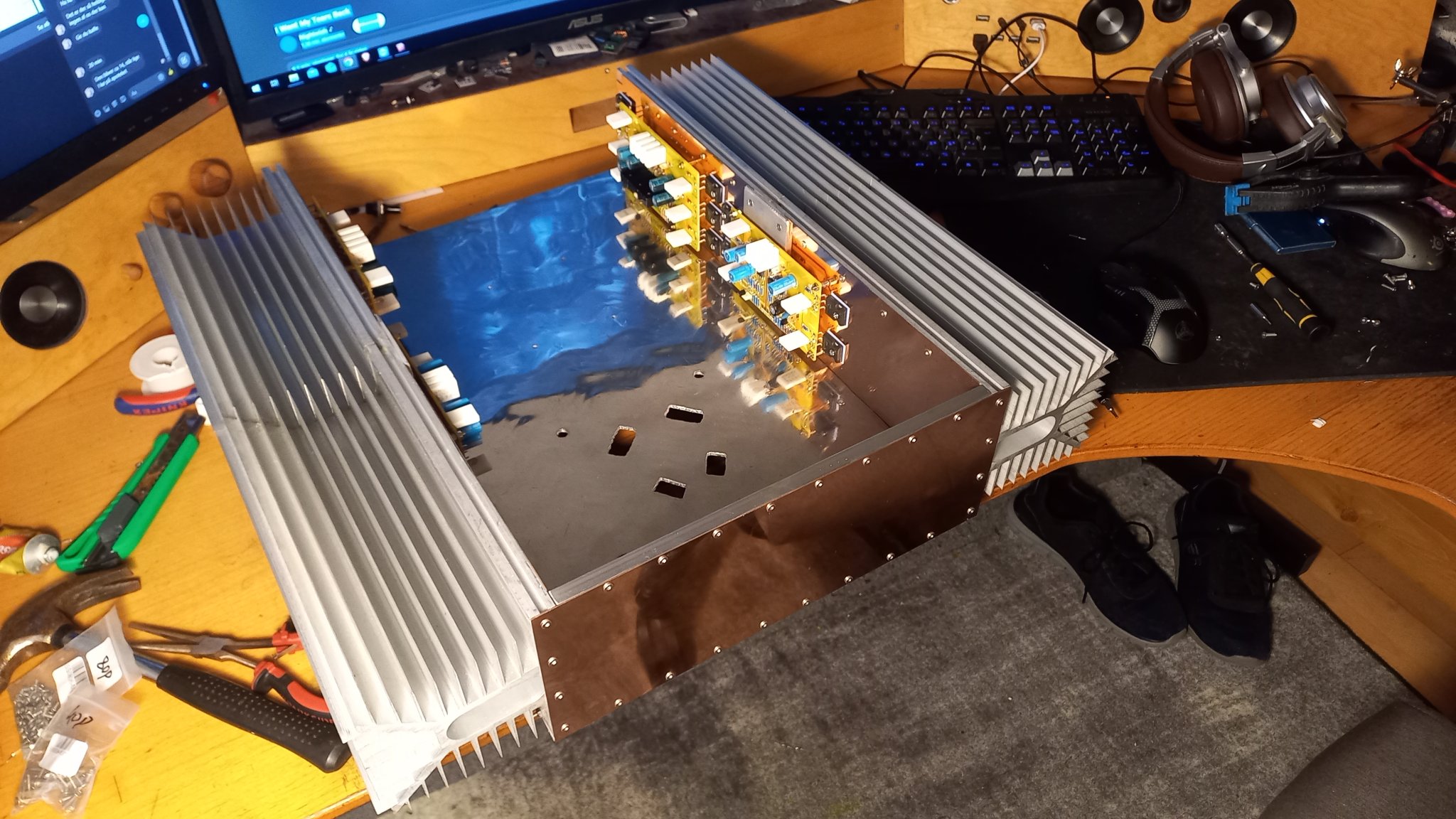

Core chassis is finished. Need kopper plate on the sides tho. (and polish... lots and lots of polish. 😀
