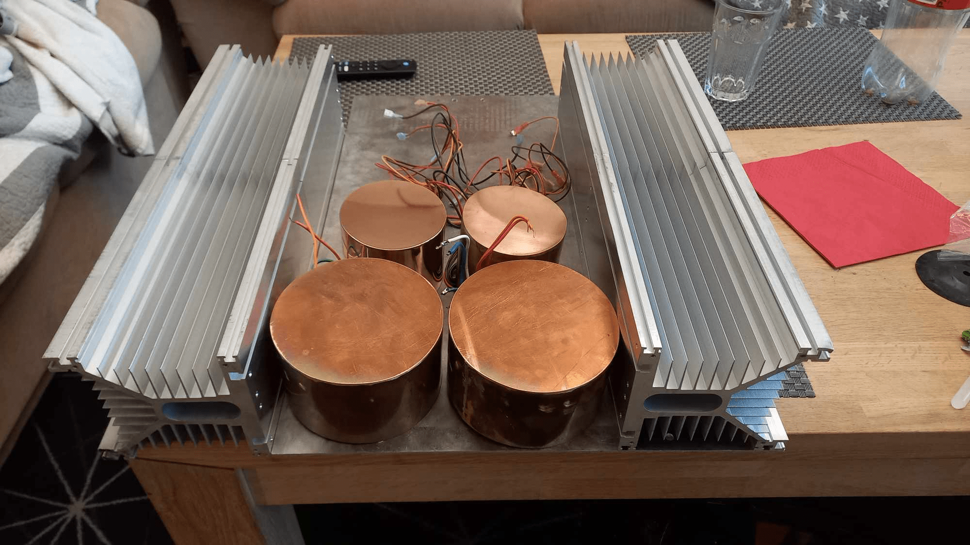

I dont think they are enouth to cool 600w passively. And the water was done to keep the amp at 50c. At all times. Bc. I diddent want to use noisy and ugley fans on the amp itself. i figured why not use what i had now that the idea was festering in my mind 🙂
remember the sinks are lying down. so thr passive cooling from the buttem and sides are minimal.
and im sure a 120mm fan on each side was enough.. but. the coolness factor of that is marginal at best 😛
Noisy fans? Just turn up the volume 😂
It looks like a good solution, very reasonable. The heatsinks are multi-directional. Even though they are more efficient when mounted vertically, they are still effective in the way you have them setup.

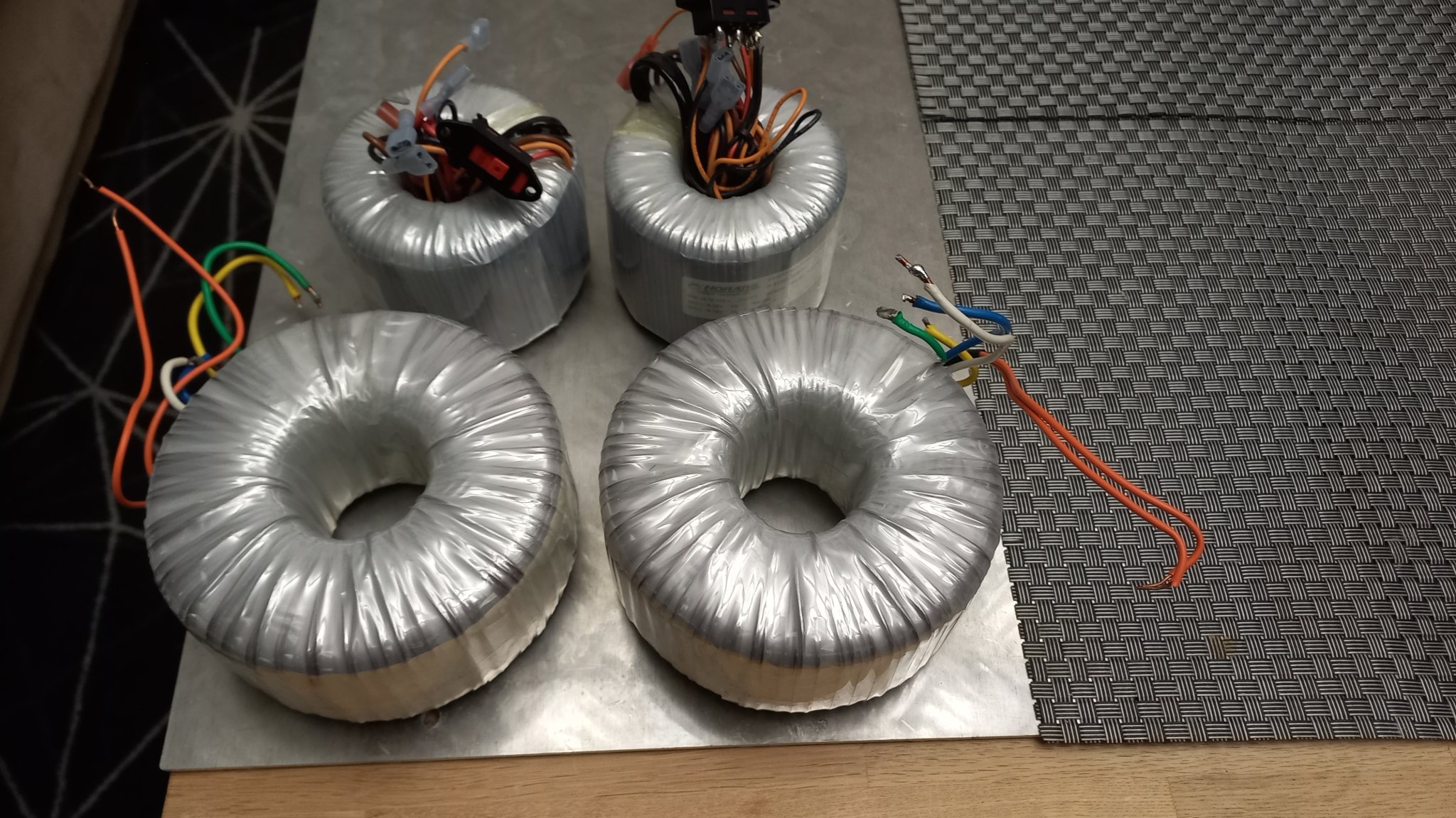

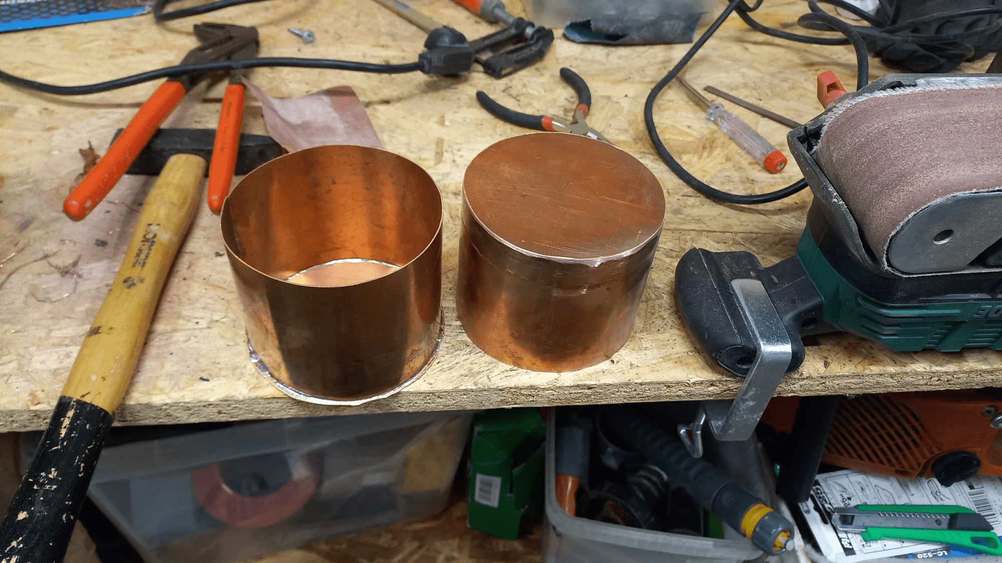

Just got the toroids unpacked 🙂
Reactions: 6L6
