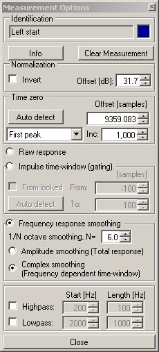

Holm does not actually use impulses. It uses either swept sine or MLS just like all the other pieces of software.
It has several methods for determining what I would call the reference point, i.e. time zero. None of these is going to be precisely correct for a given loudspeaker, except that there is no "precisely correct" reference, no "acoustic origin".
The real point is that one does not need to know the exact time zero, only that from measurement to measurement it is locked in time. HOLM does precisely that. So if the estimated time zero is off by one, two or even ten or hundred samples, it doesn't matter as long as all of the measurements being combined have the same reference point.

^ yes even if the absolute distance is not correct (perhaps this is sumaudio's beef?) the relative offsets (between the drivers being measureed) are accurate. Surely this is what matters when desiging the crossover.

Tony - I have not seen that error. But, as I mentioned, I have seen it jump several samples in mid measurement, but only on a specific computer and sound card. I suspect the card more than the software.
Getting an absolutely correct distance is not important at all - one can measure at any distance and get good result - it is the relative distance that maters. I suppose that one could run into errors if one did not measure the multiple drivers in one setting or tried to use results from different sets of measurements, but I never do that - too inaccurate no matter whose software you use. I measure all the drivers at one time without moving anything - just rotation. The rotation imposes some small errors, but I have not found these to be significant either.

It is the lock time aspect that makes measuring relative phase/time of flight between multiple drivers possible with HOLM. Setting impulse peak at t=0 approximately results in 0 phase for highest frequencies of greatest amplitude; with a tweeter peak is sharp, covering just several samples of response. Small shifts of time base will determine how flat tweeter phase looks at upper frequencies.

To my knowledge HOLM does not ever do a "time of flight" calculation, or at least it is never shown if it is. So what is all this talk about "distance". My understanding is that HOLM simply finds the peak in the impulse (or there are other options) and calls that t=0. This does not find time of flight but does give the correct phase for that delay. If you synch all the measurements then the relative phase between the measurements is always correct even if one does not know the time of flight.

The total offset is shown as samples in the option part of each measurement. That would be time of flight plus latency, I think. Although in the snap below the offset seems rather high.To my knowledge HOLM does not ever do a "time of flight" calculation, or at least it is never shown if it is.

1st - I am aware of the offset in samples, but I am not sure that this was ever intended to be the delay time in samples, just the start of the impulse from some arbitrary point in the output signal waveform. If this is truly the delay in samples, nowhere in the program does it state this. At any rate, who cares what the total delay time is, that's completely arbitrary as well. what one needs to know is the relative phase of the different measurements and this is perfectly accurate in HOLM (contrary to what is being claimed.)

1: Yeah, not sure what the total offset means. I'll look into it. Doesn't really matter, as you say. It's the relative offset that's important.
2: True. I was thinking about how HOLM might align the signals for analysis. It can do the same with two imported files. With swept sine there isn't any highest amplitude in the test signal, so I was wrong about that. DiffMaker Software does some kind of analysis (which you can see in the log) to align files.

The answer was "The highest amplitude of the test signal is time aligned with the highest amplitude of the response signal with that difference in time being the distance to the transducer." That seem pretty darn clear. Loudness equals distance.
I would not interpret it that way at all. One thing to remember too is that Ask's native language is not English.
As we know Holm converts the measured result to an impulse response. My interpretation of the above is that highest amplitude above refers to the highest peak in the impulse response. Compare the highest peak in the test signals impulse response to the highest peak in the recorded impulse response and you have (not taking into account latency) your time of flight. Provided the latency on the sound card is constant, once you lock time zero, all measures of time of flight are relative which is why provided latency is constant it gives you good relative phase of the drivers, which is perfectly usable for crossover design.
