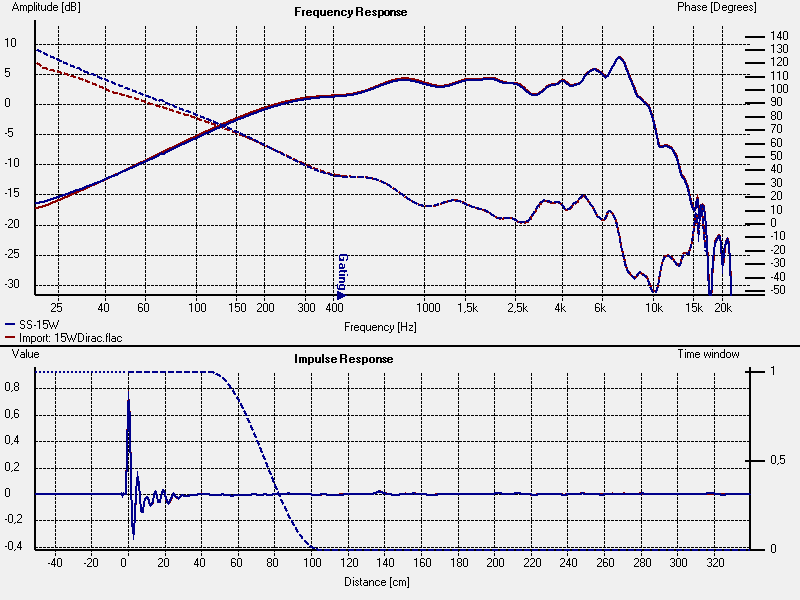

Impulse domain - Import as wave/flac/mp3/au-file
I like this feature myself. I have made a test:
1. Play a Dirac sample at 44.1 kHz direct to a mid-driver (SS-15W)
2. Record the peak in Audacity
3. Save the waveform
4. Import waveform impulse into HOLMImpulse
5. Make measurement in HOLMImpulse direct to the mid-driver (SS-15W)
6. Compare
I know that in theory the impulses should be the same, but I had never expected them
to equal this much - you might not believe I have actually made the test. It is good that I have consistency, but I'm left with the
question why I'm using logsweep when I can measure everything in just one sample... I know: S/N ratio, Harmonic distortion, ...
But it does take the technicalities out of measuring - everybody with a brain can understand that if a Dirac is on a CD, then the driver plays a peak, not a Dirac. so what comes out of the speaker and into your ear is not what is on the CD.
