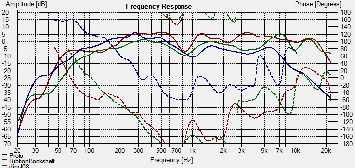

Attached graph shows some speakers in the same room but
different positions. Positions and room are both suboptimal.
RED:
Bookshelf Speaker with ribbon tweeter, measured slightly
below the tweeter axis, should better be above.
Free standing, needs closer rear wall or bookshelf,
too less bass in that position.
BLUE:
Bending Wave Transducer
Side wall too near.
GREEN:
Dipol 08 Line Array
Mike sould be somewhat higher on ear height.
Rear / side wall is too near.
No subwoofer, 1 satellite only.
But nevertheless:
The Bending Wave Transducer has lowest bass extension,
smoothest phase rotation, lowest distorsion and the smoothness
of FR is at least on the same level with the "conventional colleagues".
The top end roll off can be fixed easily like mentioned before.
Not to mention is has the smoothest dispersion in the highs.
Kind Regards

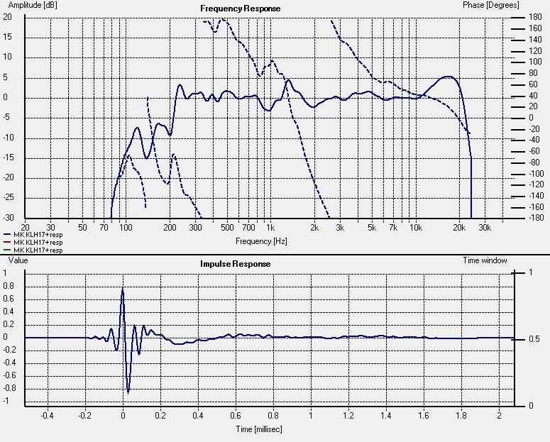

Attached is the test I promised in another thread showing the 400 hz phase inversion.
Also, is the impulse response acceptable? I'm not sure what's good and not good on this measurement parameter.
Recently conducted some HI tests starting to use the software and discovered a phase inversion within my 2-way woofer's passband at around 400 hz.
I'm running the test in a 13 sq. ft room with the speaker oriented diagonally corner-to-corner to minimize reflection/mode effects. The speaker has a 2nd order LP and a 3rd order HP with conventional topology.
I wonder if the 400 hz phase inversion is being caused by acoustic effects such as a room mode or diffraction. The other phase inversion is at the expected crossover point of about 2200 hz.
Any ideas as to the cause?
