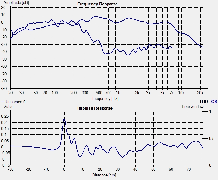

Attached a frequency response of a prototype bending wave
transducer from ungated raw IR. The phase shift (not shown)
and rolloff at the upper end is due to experimentally attaching
the exciter to the panel with kneading mass instead of lightweight
and harder glue ... Smoothing is 1/3 octave, second graph is THD.
