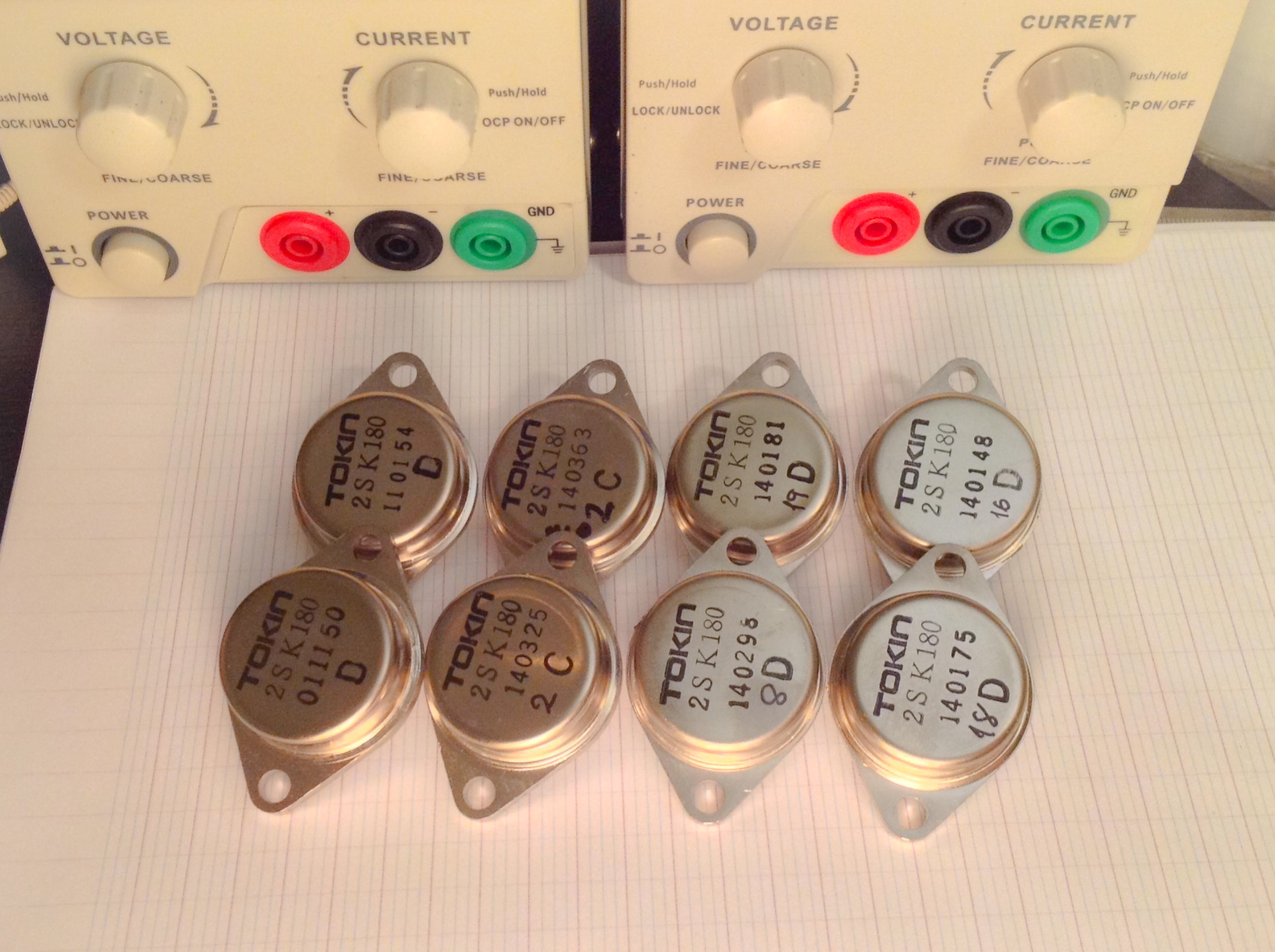

4 curve traced pairs 😀 and + THF-51 , 2SK182 ES

I measured 182ES from Watanabe-san at various operation points. Very well matched. 🙂
LTSPICE based on my measurement. (measured 15-25V range only)

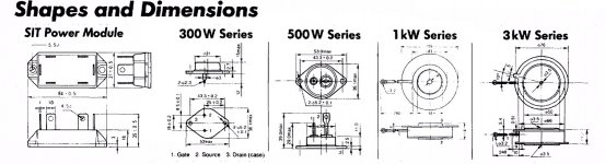

What would be the interest for custom made ceramic insulators for 2SK180?
I asked a vendor about it and I am waiting for the answer.
What is the "type" of the big encapsulation again?

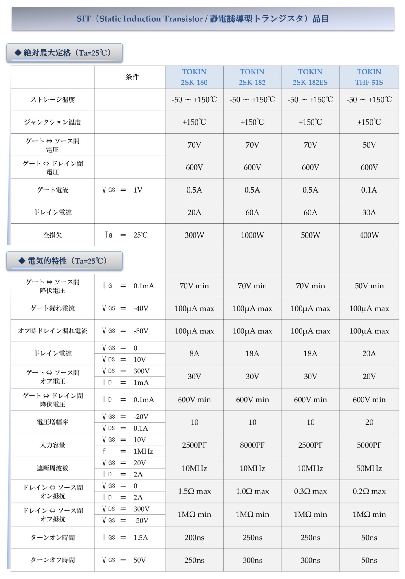

maxlorenz, I was studying the thermal resistance of Tokin SIT.
2SK180 (Pt 300W Tj 150C), θj-c is 0.42C/W ((150-25)/300).
182ES, 0.25C/W.
SONY 2SK82, 1C/W.
It seems the case temp of Tokin can be much higher than regular FET, so the difference of C/W between Keratherm and Ceramic for this size of FET would not be a serious issue, I guess. Have you calculate the difference?

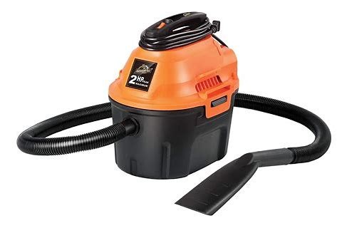

Tip : drill and at the same time use vacuum cleaner 🙂

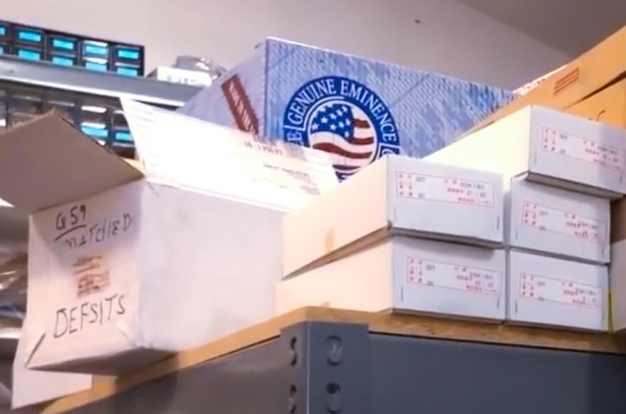

Good news in a last interview episode with Papa
, thanks to Mr Guttenberg for amazing videos ,
we see not dozen Tokin's but rather dozen of hundreds
+ super exotic golden " small satellites" and mega huge black SIT bricks probably twins in one package.
Think Sony Vfet's Diy amplifiers had been just adventures beginning..
