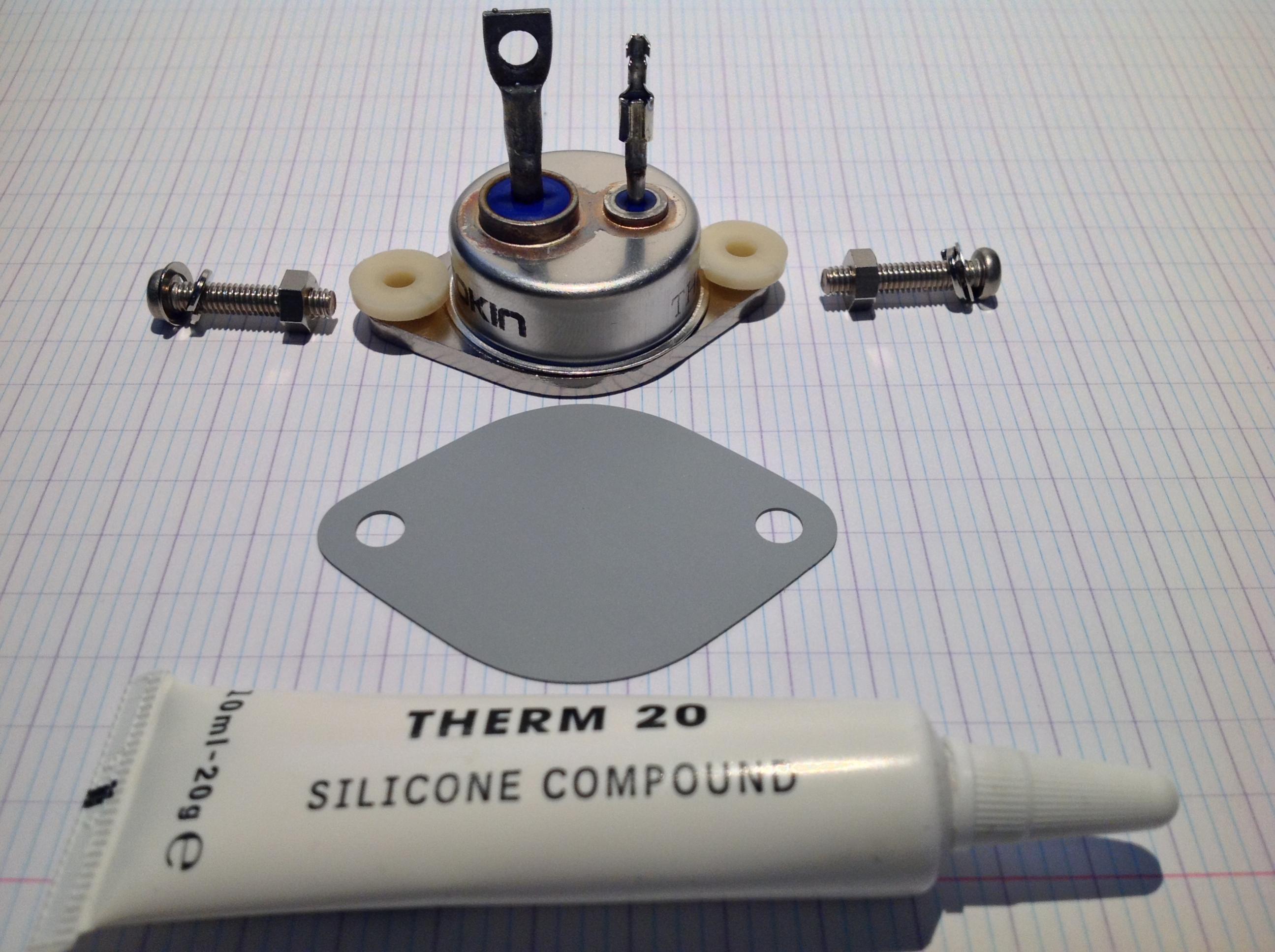

Thermal pads for solid state relay from Electronic Components and Accessories | MPJA.COM
this solution was on AudioMaker video, start time 27:00 Lab Hangout #2
Greetings![]()
Hey Soundhappy...I followed your link and tried searching the website, but couldn’t find a thermal pad like that. Afterward, I just did a Google for “large electronic relay insulating pad” and I got a hit on their website...but it says NLA.
Is this the item?
Solid State Relay, Thermal Mounting Pad | MPJA.COM
Maybe they sold out? Anyone else have luck locating a thermal insulating pad solution?

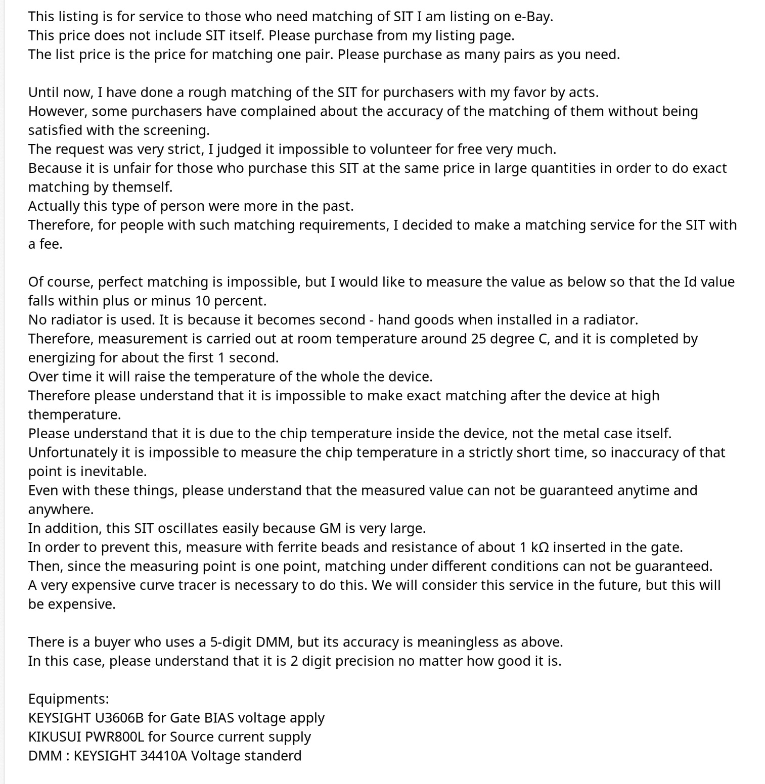

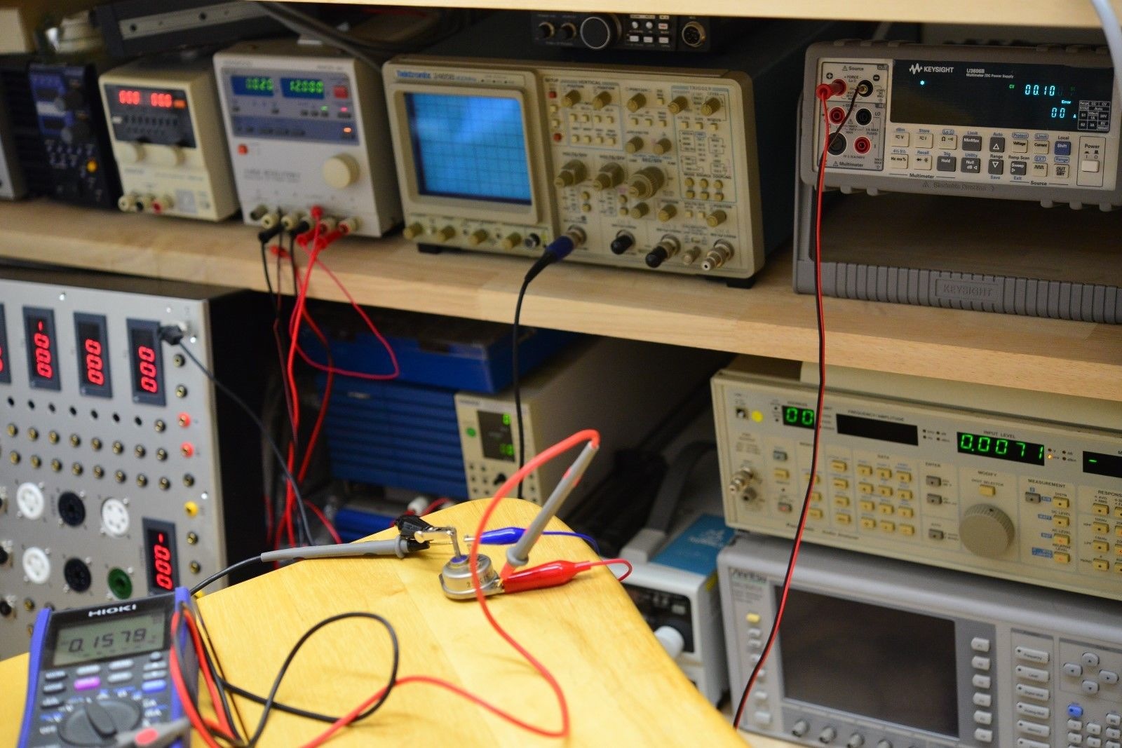

if that is not test with curve tracer ( burst , short in time ) then fact that SIT is not heatsinked is saying everything about test results
to write it clearly : SIT must be heatsinked while testing !
that's nutz
no use with that way of testing ...... even if we don't need absolute precision , border cases are going to be critical that way
one can make any sort of clamps , to avoid scratches ...... even hand pressure on heatsink is better than nothing ( even if tiresome)

no need for 15min, from my experience
it's clearly visible on DVM when part is in thermal equilibrium ..... pretty fast , in fact ... less than minute
however , if one is asking for absolute precision , more (time) is merrier , with exact control of heatsink temperature

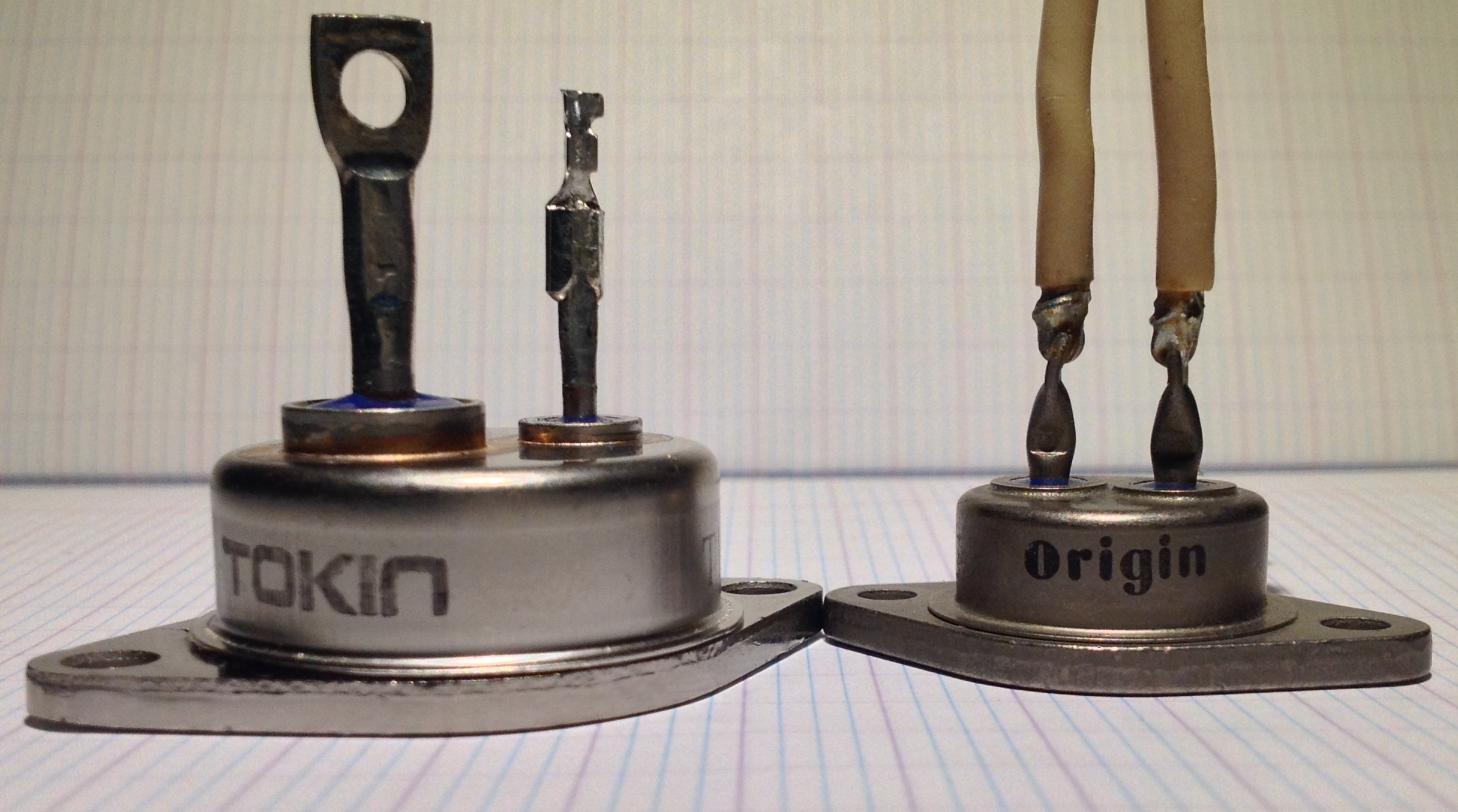

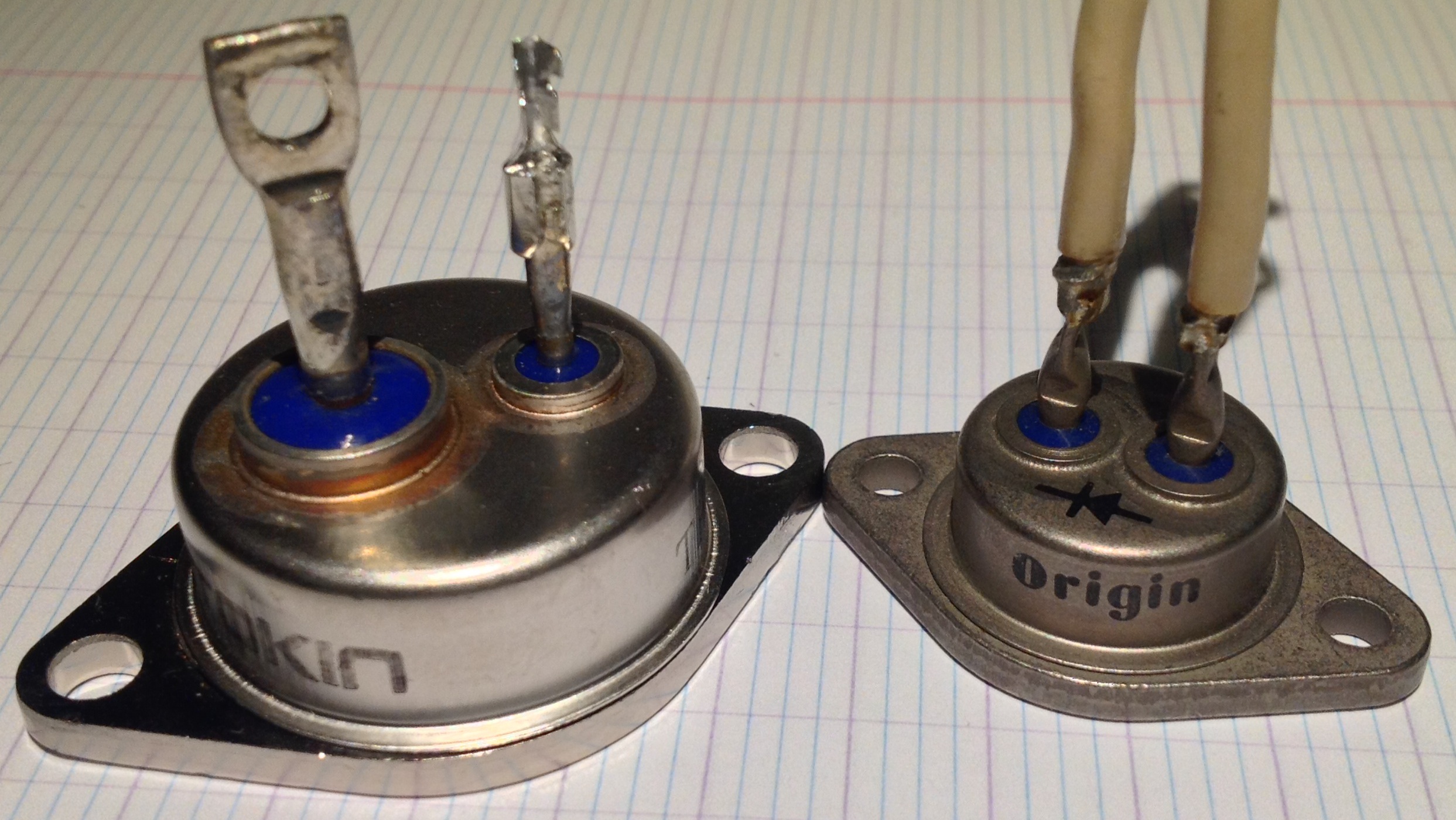

You think I find unknow vintage triode transistor from "Origin" Semiconductor Company ?
Not at all , is a single diode package who looks like small "blue sky" SIT

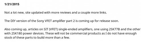

You will be happy to know that some progress has been made.
Remaining SIT-1 transistors are in SIT-3 amplifiers.
About 400 Sony Vfet channels are being prepared for introduction
in the diyAudio store.
Designs around remaining THF-51 and 2SK182 are in development.
