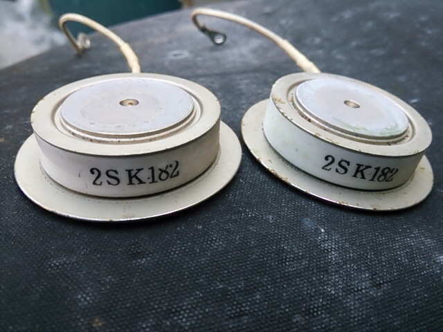

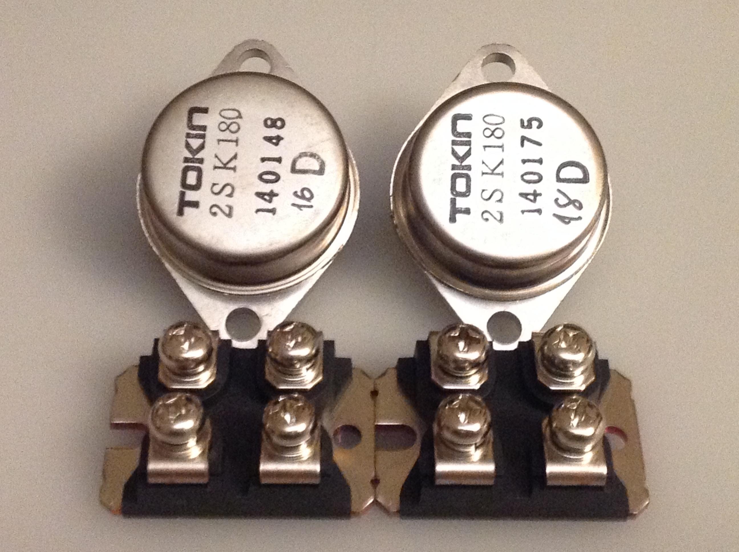

looking for a mateI have a single, orphan 2sk180. I can't decide what to do with it.![]()
Thanks for kind words Sontero.
Anyways not without circuit modifications :
2SK180 need specialized negative (-) voltage bias circuit for depletion SIT.
PSU voltage is more up ~ +60 V probably.
Choke parameters Henrys and the A current if SiTFo is possible frankly I don't know all details
I have one odd, and you are welcome to it - it's in the big TO3 style case.

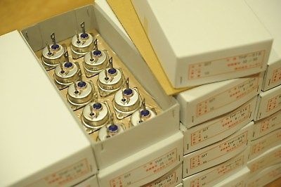

Pras1170 are new seller ( with only 4 feedbacks ) of not verified quality " sand" triodes.
Today we don't know but maybe Diyers write us is genuine stuff or not ?
Tokin SIT | eBay
Please bring Your test conclusion after deal experience.
Yeah probably NOS huge source ! Buy 4 and one is for free and the other used pcs. was tested and are cheaper 🙂
Tokin SIT | eBay

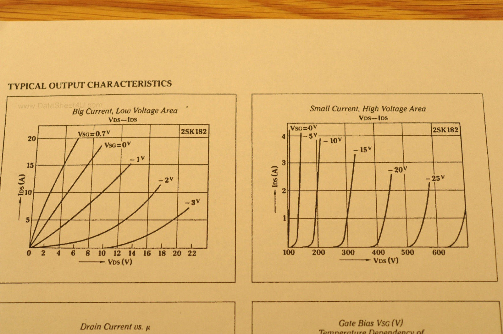

anyone here ever tried "small current high voltage area" with 2sk180?
how does the sound compared with common big current low voltage?
-thanks-
I'm interested too
Tokin SIT | eBay
To whom this may be of interest: I purchased from PRAS1170 four units of THF-51 for my diffamp-TOKIN amp. They seem very OK for me.
He accepts offers BTW. 😉
M.
Interesting question!anyone here ever tried "small current high voltage area" with 2sk180?
-thanks-

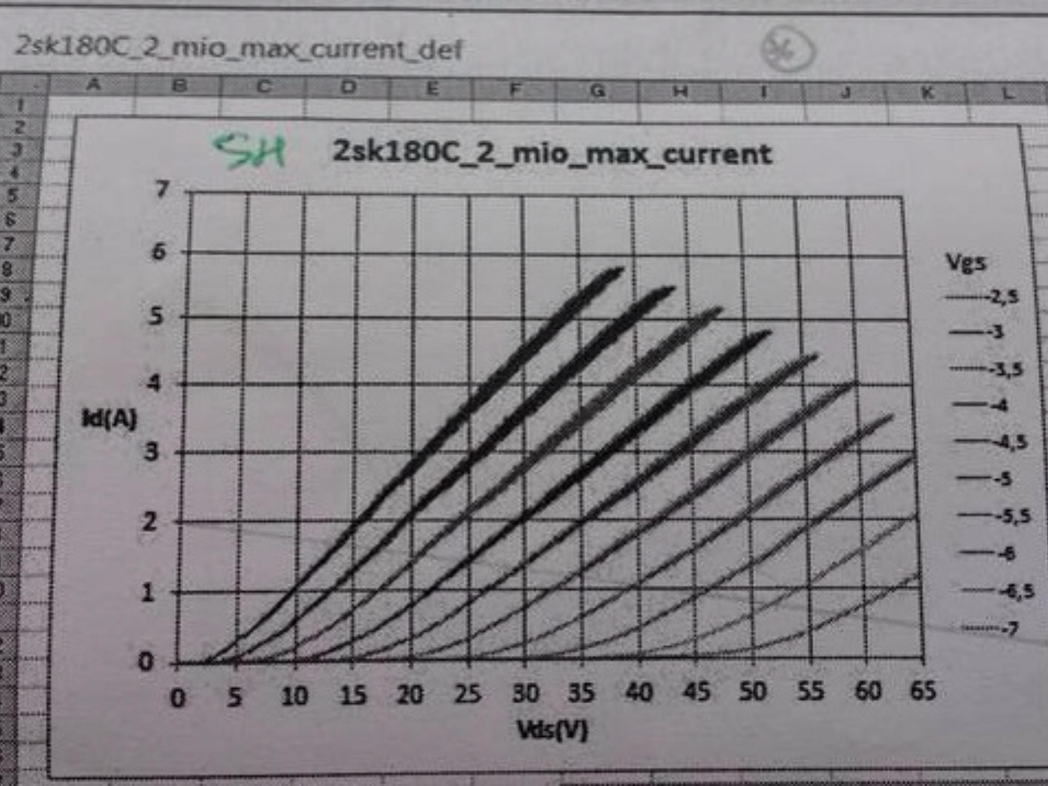

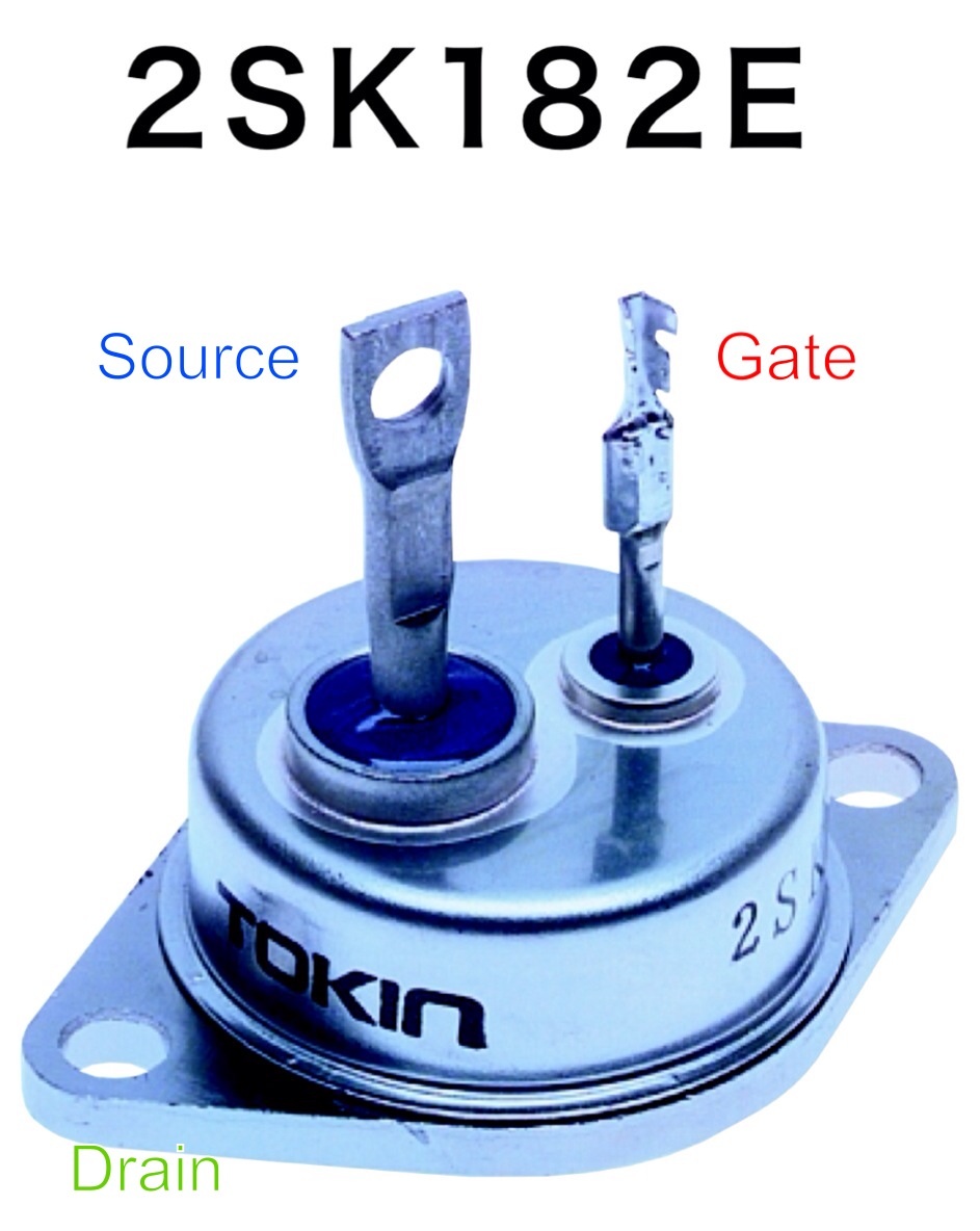

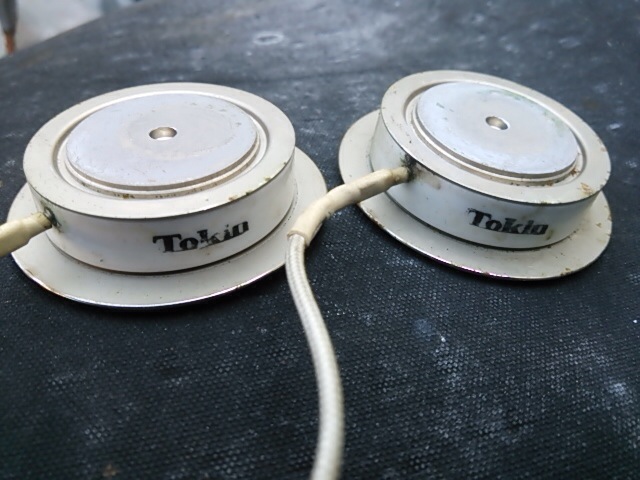

Curves show from original Tokin datasheet is 182 ( without ES ) a 1000 watt's SIT.
Member Jama send me curve traced pairs C and D grade of 2SK180.
This is for near future builds.
You can find bunch of data and SIT modeler software on Mr Rothacher blog
AudioMaker | DIY Audio Projects & More
and video about load line and sweet spot
