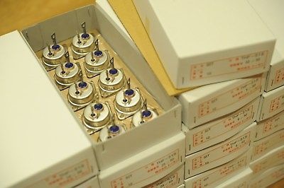

Hockey Puck SIT 2SK180 by Tokin source NOS

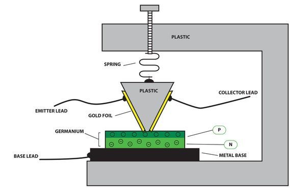

Ancestral Grand Father of all transistors
I can't resist....
I own this photo of the first transistor, autographed by the inventors.
(one of the signatures has faded with the years - cheap ball point pen!)
Thanks Mr Pass for interesting show.
Beautiful collection legendary piece in right hands 😀

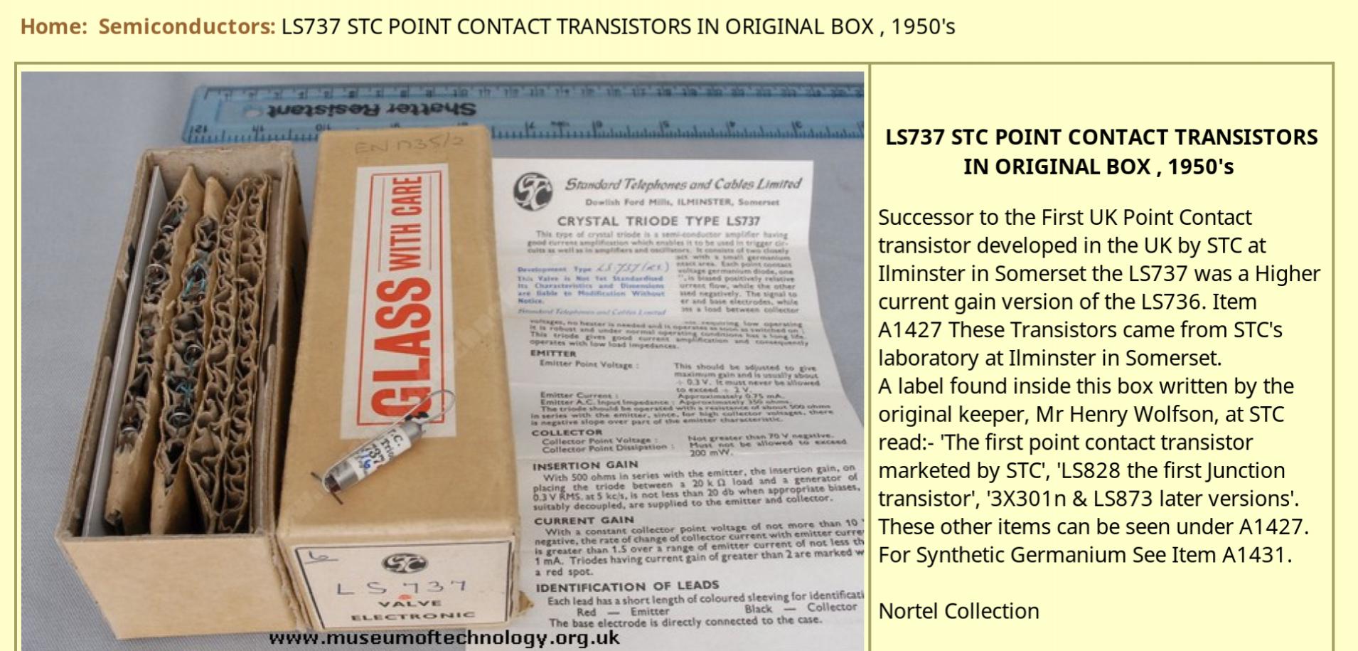

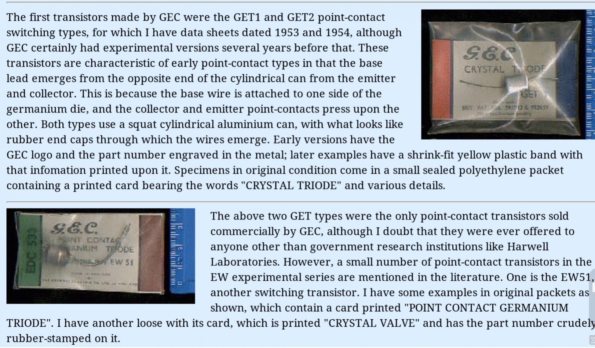

The first generation of transistors was revolutionary tech plenty of "mysteries" and not many photos of curve tracer tests.
Something to do with rare museum "crystals" 🙂

I bought my 180's from that guy. Very good. They work great on my single ended common source amp with a "cascoded-compound CFP" differential amplifier on the input.
I asked for matched pairs for the 51's but still no answer... I bought a monster heatsink for them 😀

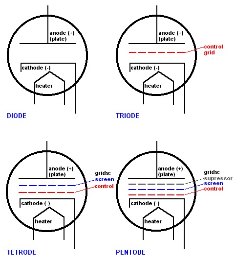

Huge mosfet and SIT can have similar parameters for example : Ciss
but are totaly different on the other side : pentode versus triode etc.

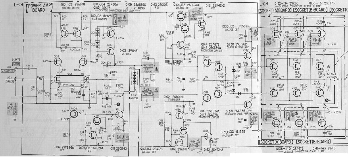

Perfect example of one complicated vintage amp circuit from the past.
Let's look at the future now 😀
What cool Tokin spec they have lot of transductance.
Single transistor can do 20 dB of gain I guess and bunch of amplification watts too.
Integrated SIT version with jfet impedance buffer and passive volume stepped attenuator , LDR, AVC etc.
that can be one audio nirvana solution with adequate hi quality source and speakers imho. What You think ?
