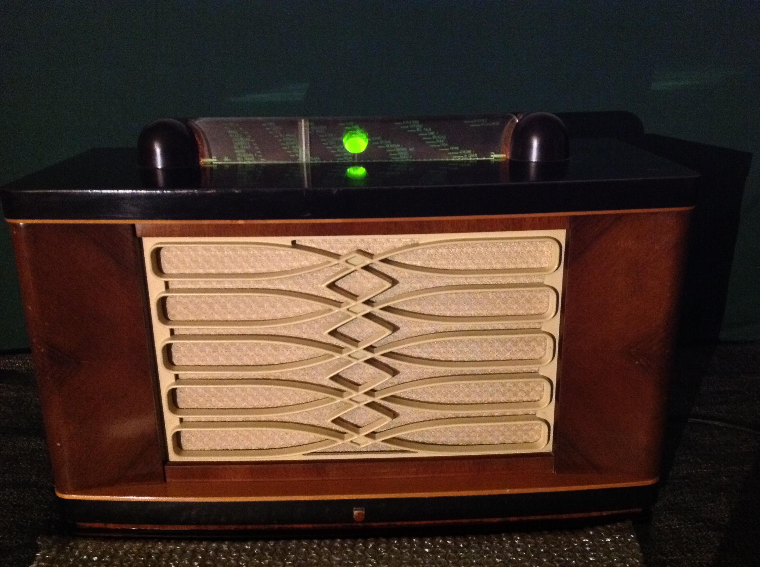

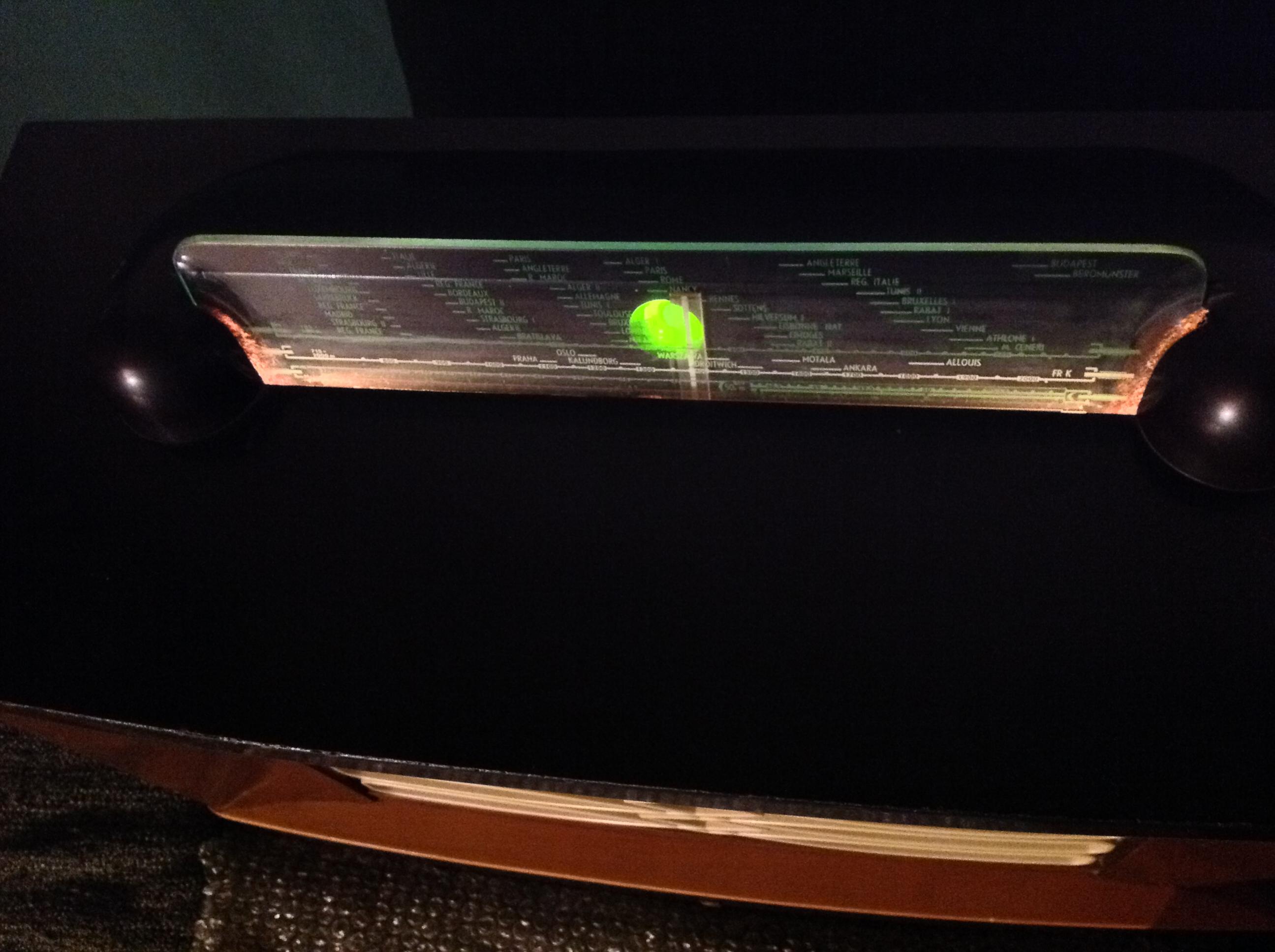

Using amp input of 70 years old Philips :short signal path : full range speaker connected to web with tactile tablet is funny.
Seriously one my audio configuration example is DAC with single-ended classA tube output into volume autoformer and M2 amp
to 12" | 32 cm (non crossovers) wide range speakers. Natural , smooth and

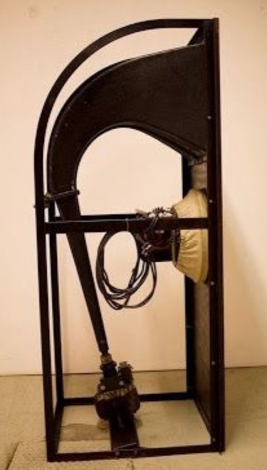

Try how Vfet's and Sit's match with horn's and compression drivers is on to do list.

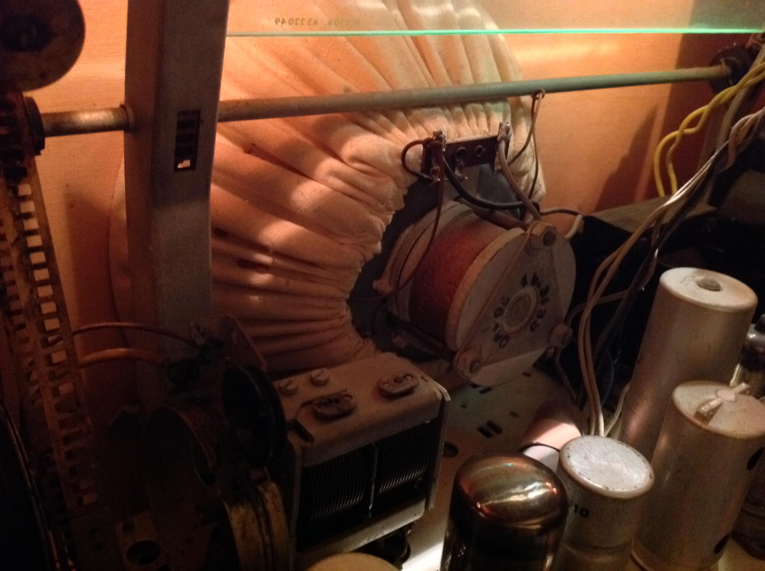

In the past Klangfilm have protected driver spider and gasket with cloth.

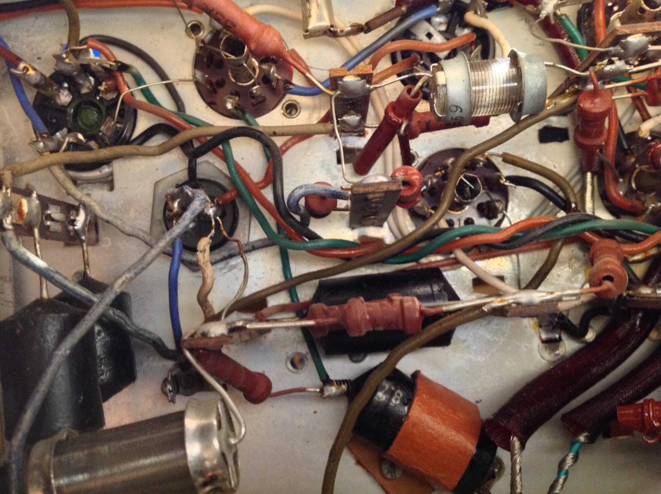

This Philips is special "tropical" model who resists to humidity and ocean salt air.
All wires are solid core, resistors not carbon component, but very old metal film type, film capacitors with hermetical layer etc.
High probability amplifier section can sing for next 50 years +
