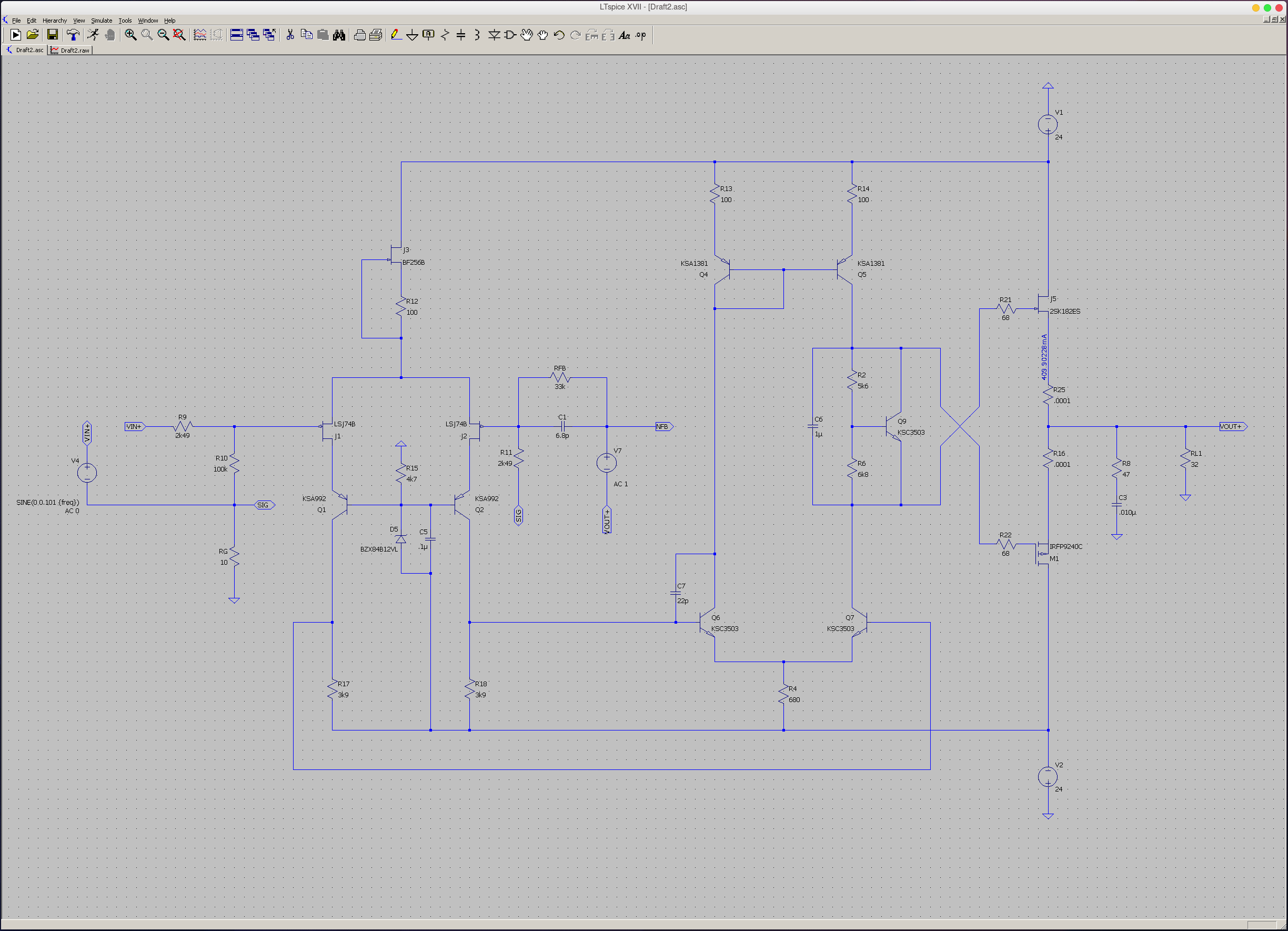

There will be a defisit in my funds soon when I start this HP amp project. 😎
your cascode iz zener-ed from wrong side
Thanks ZM. It was alot of copy paste hahaha. I will clean it up soon. It is a work in progress.
Cheers

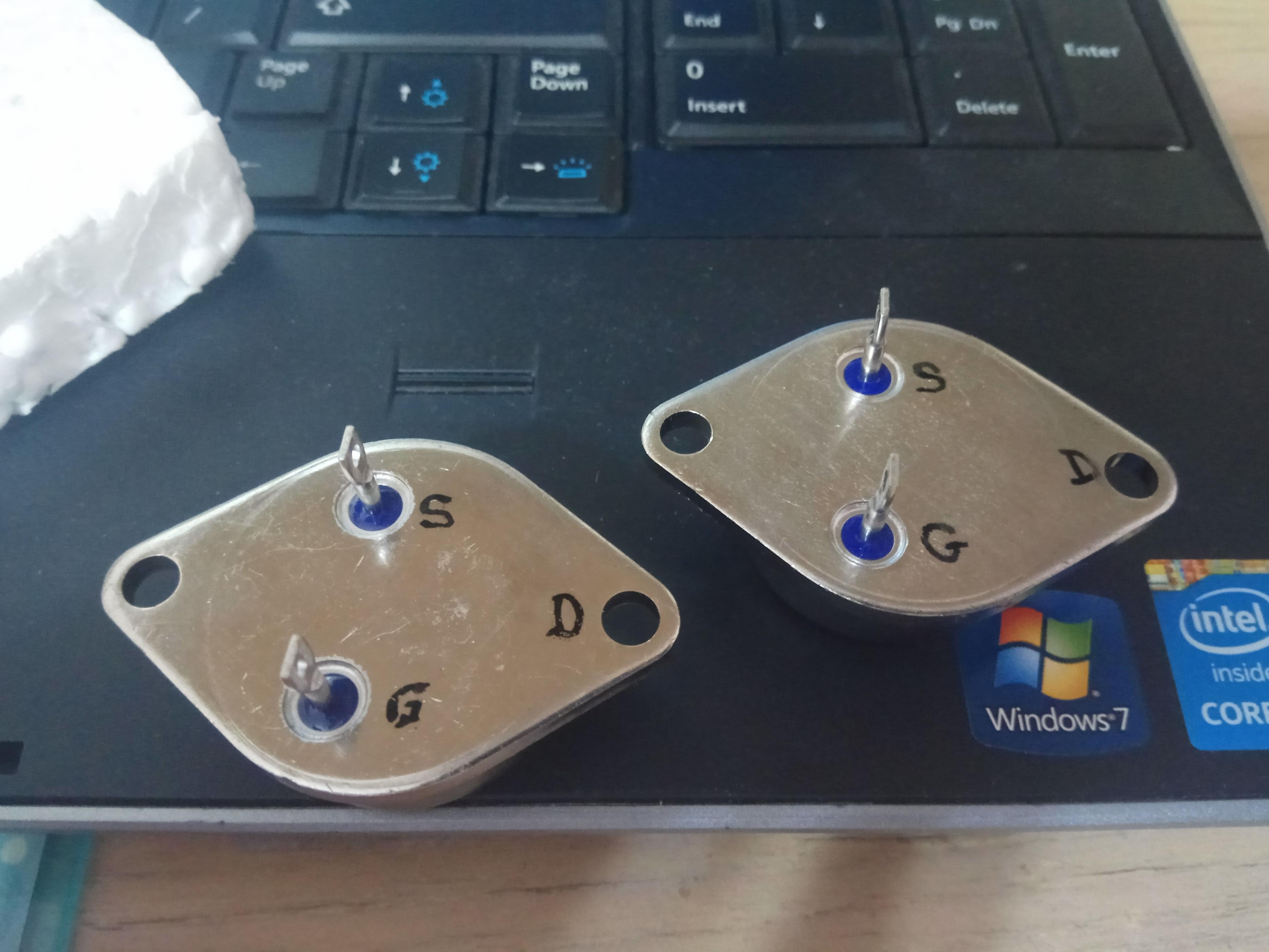

I see I've really driven up prices. Next time I'll be sure to buy a stash before I publish anything. 🙂
- Hockey Puck SIT 2SK180 by Tokin source NOS
