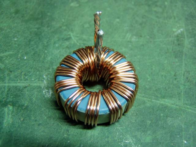

I just getting a new Coil = 20u , and manufactor tell me that
the matiral of the core is low-u core , should be suitable for
me to use for filter , i will try it again , later i will tell you

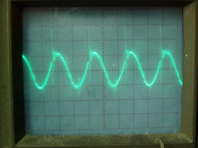

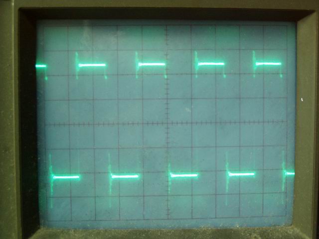

I have tried new component , It looks good.
I'll paste several pictures.
when i reconnect the Coil and turn on the power(no load).
The waveform of switch node is good form +45v to -45v square wave.
And the waveform of output is 4Vpp, but it got some ripple.
I just connect the 4.4ohms resistor to the terminal.
when i turn power on , the power supply current rise up to 8A.
But the Output MOSFET didn't get heating.
I touch my SMTP's mosfet ,it get heating. i don't know what happen.
so , i remove the resistor, and trun on power.
It go to stable , and i connect the resistor again while power on.
Power's current didn't get rising, and output waveform still 4Vpp sine wave.

the picture is my new Core:

The waveforms look almost good.

Don't worry too much about the high frequency ringing in the output waveform, it can be reduced by the addition of dead-time and slowing down the turn-on/off of the mosfets (increasing gate resistor to, say, 18 ohm).
