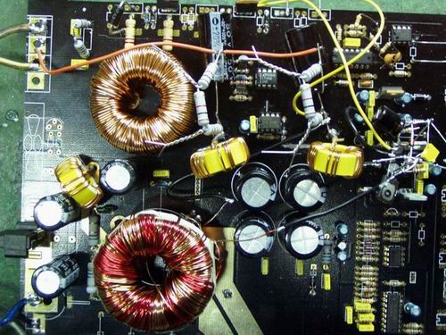

hlpe ! Turn on get big current
The output waveform as well as the square wave look good.
Please tell us the following:
- Are these photos taken with or without feedback? If so, please tell us how it is wired.
- Are you still reading a bit current consumption with the new core?

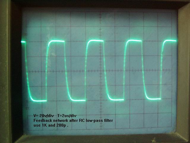

1.what is the purpose of the RC low-pass filter on feedback network??
I test the wave on the point that after rc low-pass filter.
It still a +/-45v square wave , only it no ringing.

You shouldn't get such a high square wave after R31/C28. Try increasing C28 to, say, 1.5 - 2nF. What is your sw. frequency now?

The RC filter is to attenuate a little bit the HF going into the error amplifier. It should have a cutoff frequency similar to the sw. frequency. 1K and 1nF give around 160KHz, perhaps slighty smaller C can do. (1k and 680nF).
Please try with several values until you get the best results.

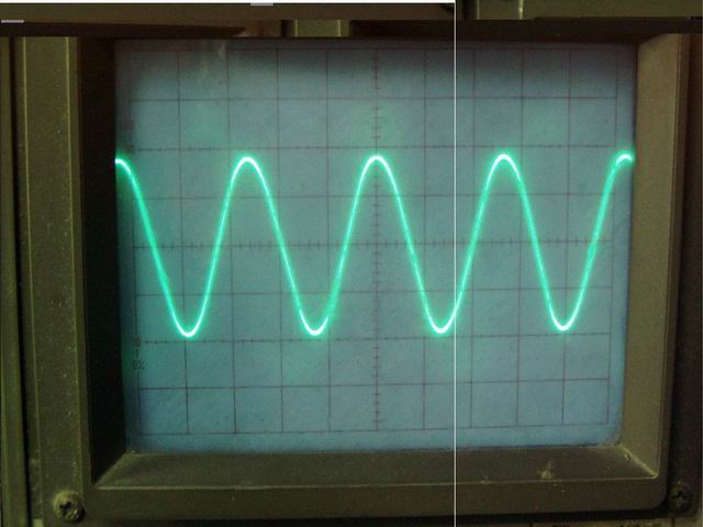

3. Now , i have used the LF347 to generate triangle wave.
but the triangle looks not like a linear triangle.
It looks like a sine wave , Like photo shown.

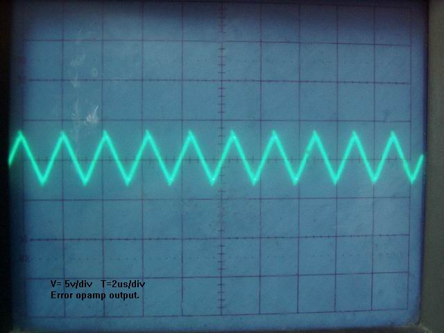

However, your 1k + 200pF waveform looks good, as long as the output of the error amplifier is not being saturated.
Your triangle is not linear at all. At that frequency, you need a faster opamp.

1. so , if output waveform voltage of the error opamp too high , should i have to lower the cutoff freq. ??
now is 180K/200p , Fc=4kHz
I found a question , if i didn't connect the LOAD.
When the ir2011 start working , the output of error opamp down to -5v , negative saturated.
But if i had LOAD , the whole system can work success.
so , did I have to change something or anything ??
Now , the output vlotage of error opamp almost +/-5v.
Looks almost saturated. Is that OK???
