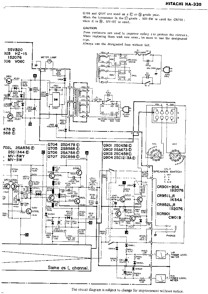

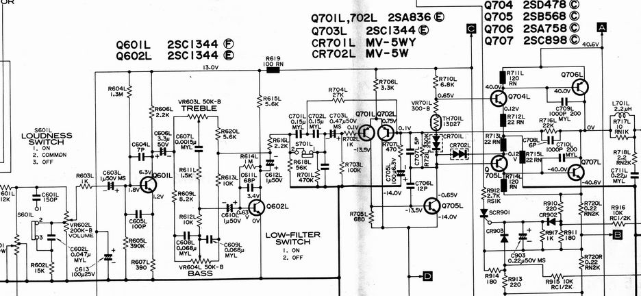

well, so far i removed low filter, those two mylar 0.15 uF capacitors, R618, R701 and its paralel cap with no name, R704
and conected R616 directly to C703
than i used spare mylars to bypas those two electrolytes in/out Q602
that improved sound a little but there is still an noise to address
i replaced first transistor Q601 with selected low noise one and it helped significantly
i can tell for sure because i must go with volume higher to detect the hiss in headphones and i have two of these amps and i am working on just one of them, so the comparison is easy and almost objective
i think i should go ahead and replace all first five transistors with low noise ones and see how much the hiss goes down
all i need to achieve is no noticable hiss when using headphones
its already fine with speakers
i wonder if any one experienced could tell me what is the critical part to play with which has most effect on noise level
any other suggestion to improve the amp?

well, replacing the lamp with the led is simple, you just have to understand that the lamp is powered with quite high voltage, so you need to put resistor in series with the led
if you look at the schematics, the lamp is powered from one of two secondaries of trafo, those two secondaties aro providing +/- 40 volts after filtration, i would guess those two trafo seconadries are 36volts ac
tha lamp is powered from those 36 vols thru 100 ohm resistor and a diode
i do not know what voltage is actualy on the lamp, I would have to measure it, since there is nothing in manual
since it is not fully filtered, there is no capacitor on the lamp, its hard to say
so to come up with resistor for the led is not easy
you should power the led from well filtered and stabilized voltage, +/- 14 volts available in the amp to power the preamp section
just take +14 and ground and calculate the resistor, that just ohms law

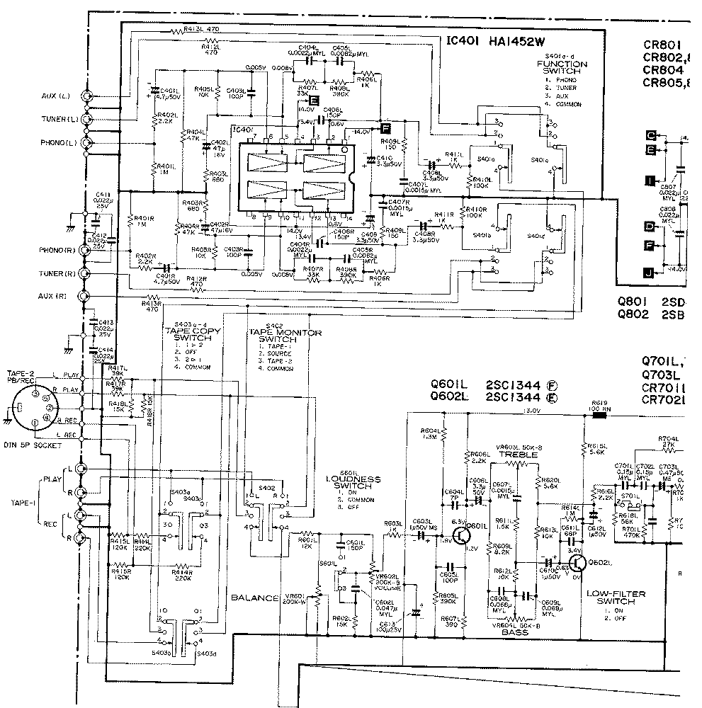

as far as I remember, the amp at the end worked perfectly and sounded good for such an old design, I was not too happy with noise, than I bypassed corretion section and all was fine, I left loudness on and off
I gave it to a friend, he is still using it
this is old thread, if nioux or anybody else wants, I can post or email schematics

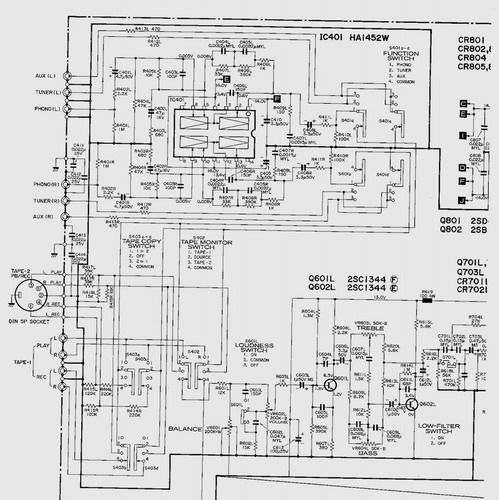

ok ilimzn
i did that, i converted jpeg scans to gif gray color, but they were still 360kb, so I had to shrunk them furter to 1000x1000 pixels, another limitation, attached is the result, its readable, but much uglier than original, whoever wants original, just email me, as i said before
