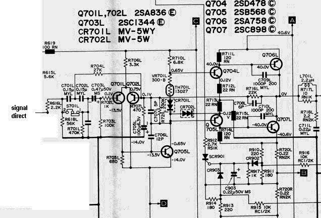

Progress on my modification
So I have completed phase one of my modifications.
This was an excercise in looking at the two gifs+jpg posted earlier. Now comes the fun part when I work towards the second of the gifs and it's darn close to unreadable. Still waiting for adason to be kind enough to send me a pdf. New member, so can't send emails yet. In case anyone else has the pdf, please send it to me.
The following is an excerpt from a diary of sorts I'm writing for this modification.
Problem: Really didn't like the way power was coming in to the amp. 10" long connector on the outside and routing of power inside together with secondaries and speaker cables.
Solution: Added IEC C14 chassis socket for power. Currently screwed to hole left by removal of speaker B plate. Incoming power routed on back, left of transformator using two conductor 1.5mm2 cable. Socket should really be C18 as connecting power ground to chassis (=secondary, signal, and speaker ground) has a very bad effect on sound. Or I could investigate this more.
Problem: Not a real problem, but as everything is on an experimentation stage, the transformer/chassis is some 2' away from the PCB. Need some convenient way of connecting/disconnecting the two.
Solution:
Cables from transformer changed to black for ground and red+yellow for others. Screw connector (don't remember/know the correct english term) added. Should probably change the connector to something allowing for faster and more reliable connect/disconnect. Maybe a computer connector.
Problem: Volume control is bad, loudness didn't seem to do anything, signal routing is ugly.
Solution:
Currently connecting directly to R616x bypassing balance, loudness, volume, and the bass/treble sections. The way I did this was by desoldering and lifting the legs of R620x, R613x, and C612x. Connection is by a piece of RCA cable (non-teflon cable that tends to melt real easy) soldered directly to the legs of R616x. Makes it real nice to route the signal cable on the front and right side far away from nasty noise sources.
Problem: Speaker cables were cut at some point and had to be replaced.
Solution: Connecting 0.75mm2 Speaker cables to 16 and 17.
Problem: J1 and J2 routed on component side of board. Didn't like it.
Solution: Re-route to solder side.
Current status after modifications:
Signal input is 3.5mm connector by long cable directly soldered to R616x.
Speaker output is DIN 41529 loudspeaker connector by 1.5' 0.75mm2 speaker cable directly
soldered to 16, 17 and to ground.
Headphone (14 and 15) disconnected from PCB.
Power level meter disconnected from PCB.
RIAA amplifier saved for possible future use. Throw and rotary switches desoldered.
Volume and balance control board scrapped.
A lot of the bad noise is gone and left is some sweet, soothing white noise audible when putting my ear real close to a MDS Fanatic 5.25" 2-way speaker (4 ohm, 91.6dB/W).
Future work:
Continue working through the signal path towards speakers.
Think about how/what to do with balance/volume control and tape/input selectors.

Others: I am still having problems to source (mostly my problem as I haven't ordered any electronics related parts in a while). Currently I have bypassed a lot of the input capacitors and am in the process of resoldering the transistors. I'm currently waiting for AlOxide insulators for the transistors. The only part I haven't decided is the insulators for the "legs". As soon as I do that I will have a working amplifier. For the moment it will be with no volume control, so I need a pre-amp which was a potentiometer that was totally unshielded. But still it got me some real nice sound, but it was some distance from the computer (i.e. my source).
I am cery happy with the sound quality of this amplifier and would like your input on my ideas of using AlOx as insulator. I think it should work very well, but I should put a thin layer of something like arctic silver on the contact surfaces, right?
Others: I may still put a volume (and other) control as these fit in the chassis, but the existing volume control was oxidized beyond repair for some reason. Any suggestions for a fitting volume control? I may consider playing around with something like the light speed attenuator, but I think it might be as well to put the attenuators outside the chassis (i.e. attenuator, balance, etc...), right?
