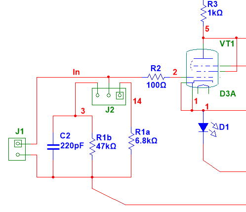

Looks like another approach might be to just use a 1:1 transformer to preserve the balanced nature of the input (and provide for a future change to a MC setup...
How do I deal with the relative input impedances?
The Jensen line input 1:1 transformers have 10K:10K impedance ratios. If I need 47K would I put two 18.5K resistors in each input leg, and 10K (or 47K?) across the outputs?

For an MM cartridge you can abandon balanced mode and load the grid of the D3a with ~47k.

Frank -- I understand that SY is taking a vacation from DIYAUDIO -- to answer your question, you can change the operating point by changing the LED, or putting a resistor in series with the LED. You'll then have to change Rset on the CCS for the current.
