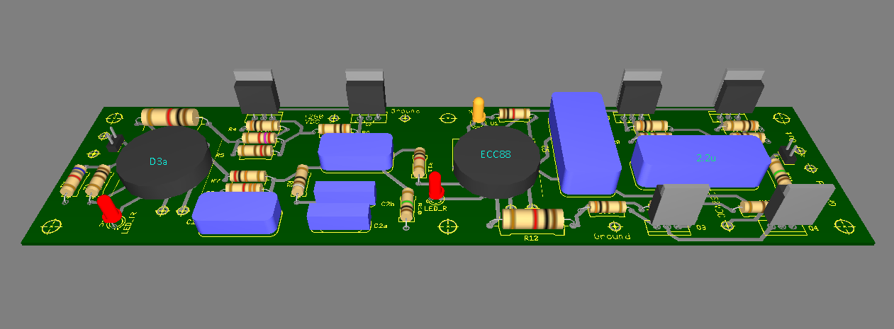

I had about 50 of the big boards made up over 6 years ago. These include two regulated power supplies, the DC heater/lifter and transformers all on one. They were somewhat expensive, and i didn't like the necessity of cutting them by hand with a tile cutter or band saw.
Here's an idea for a board which just encompasses the input and buffer circuits. Will cost me about $4.80 each including shipping and fees if I have 100 made. You'll have to mount the input transformer separately.
Jack was saying he'd do another run... Hopefully he will. I don't think there are any of the old ones available anymore.
I used some leftover boards from my Heretical project for the power supplies. The regs are super simple and could even be done quickly on perf board. A Maida reg would work, too.
