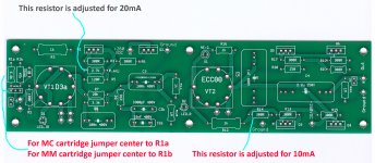

I am building the EO preamp as well. I decided to do my own boards because of the physical layout I wanted. So, I have the signal components and the CCS's on two identical boards with the tube sockets on the opposite side from the components (so the tubes can protrude through holes in the chassis), and I have the power regulator circuits on a separate board that is mounted a couple of inches away in a vertical setup so the big regulators all have convection cooling. The chassis top and vertical section is done with mirror finish stainless, so the tubes will be nicely showcased. The rest of the "chassis" is varnished teak, and there is a perforated cover to protect the supply while allowing for convection cooling. It is about 90% done.
I started by collecting parts for the HMN preamp, and then, like noviygera, realized I wanted to do an MM design. So, the power transformer I had was wrong (too high a secondary and no separate tap for the negative supply. I built it up anyway thinking that Sy's statement "the higher the better" in terms of regulator overhead would save me, but then I realized that later in his article he pointed out that at 16 mA, the overhead can't be too high before the heat dissipation in the regs becomes too high. Edcor does make one that works, but it is a special order. Not too expensive, but 6 week lead time!!! This modified raw supply should produce about 165 volt B+ rail, and an 18 volt B- rail.
I'll post pics of the build in a few days.

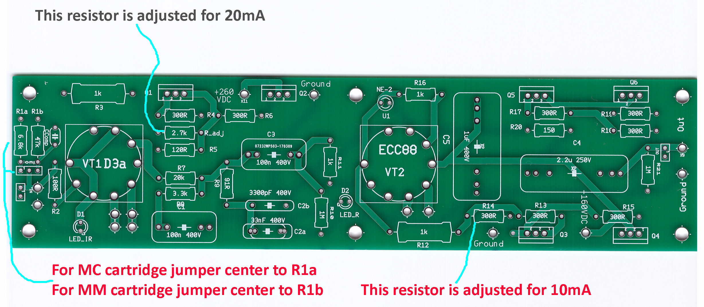

Here are my boards for the EO preamp. I'll start a new thread on this so we don't drift this one.
As noted, I put the tube sockets on the top of the boards, and put the components on the bottom. This allows me to have the tube sockets poke through holes I cut in the stainless top plate of the chassis, and allow room for the somewhat large components. The tubes will thus show, while the boards won't.
Once I test this, I'll post the board artwork so that anyone can get the boards fabbed. They were pretty expensive in small quantity (about $60 each), but they are very nice quality. I did the layout in Eagle. Signal boards on the right, regulator on the left..

Scott,
Nice design. I get what you are trying to do. The advantage of the way that SY designed it is that he can use the input boards for other projects.

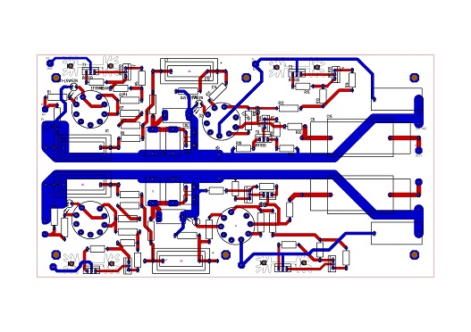

could somebody take a look to my design? Are there correction needed? Or have someone an idea for improvements?
The board is 240x140mm cause it has to fit an empty cabinet in my Hovland HP100. I bought the Hovland used, without Phono Amp.
The design is not symmetrical. So its possible to put the GND of both Channel together if needed. Is this okay?
i would use Glimmer-capacitors for the 32nf-capacitor. The board can be fitted with Wima, Mundorf or Hovland capacitors.
The connection for the tube filament will be soldered directly at the sockets.
Thanks for your help.

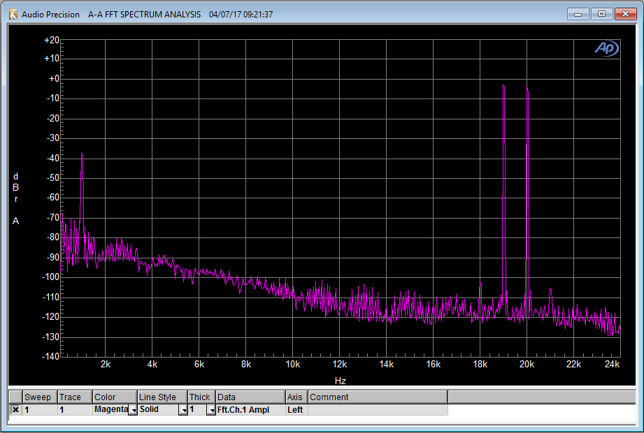

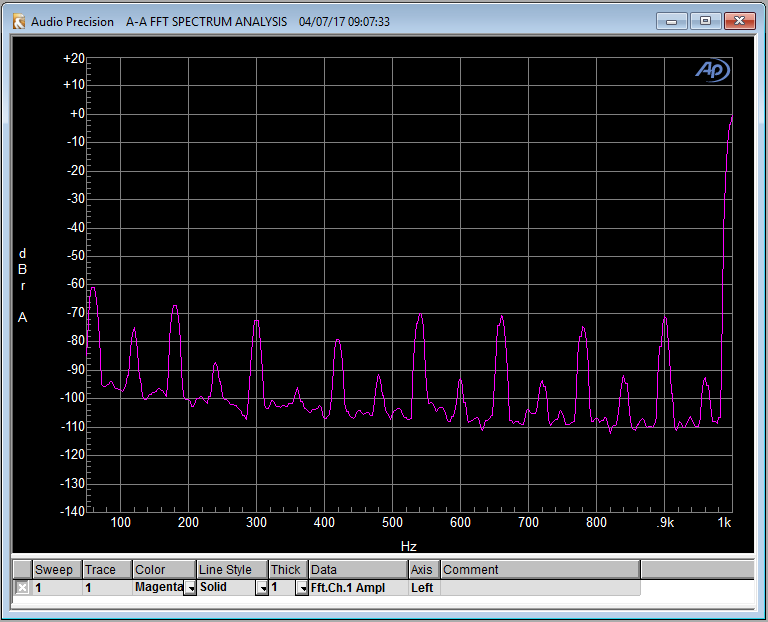

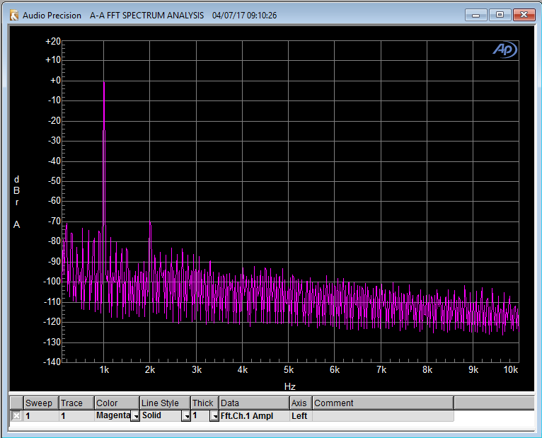

Intermodulation Distortion. The spurs are almost 100dB below the mixed fundamental which is darn'd good.
100db anything seems pretty good to me! I wish my scope was that quiet. Think i need to get a better one.
So is your input signal a simulation before transformer at about ~0.2mV or post transformer straight in to the input on the board at ~2mV? 100db down from that seems insanely low noise, amazed thats even possible.
