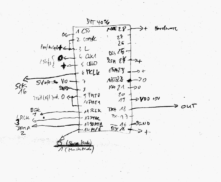

Simple version
I have a simpler version running. Cirrus being so complicated, I got samples from Texas Instruments and used their DIT4096.
Connections according to attached picture. The numbers at the SCK, BCK, LRCK and DATA arrows denote pin numbers of the sterero-mode-PCM1742 (the right-most) where they go to.
If you can't read something or have other questions, please ask.
5V-power I took from the bigger capacitor (1000µF,6.3V) which is C8029. I had to get a service manual because I made a very short short which killed a transistor in the power supply...
Now it's running very fine, and sounds much better through my own DAC, which luckily switches automatically between optical and coax-input, depending on whether there is an optical signal present.
CD output doesn't work through the DIT, maybe different data format? But DVD-Audio 24/96 works 🙂
Maybe I'll post a foto later...
Edit: I have a Pioneer DV-585A.

Re: Simple version
It seems I was wrong, now it suddenly plays CD too!
All with one single chip! 😀
Edit: I could connect the output of the DIT4096 to the cable that leads to the player's original optical and coax output, so now I have everything on the originals outputs!
