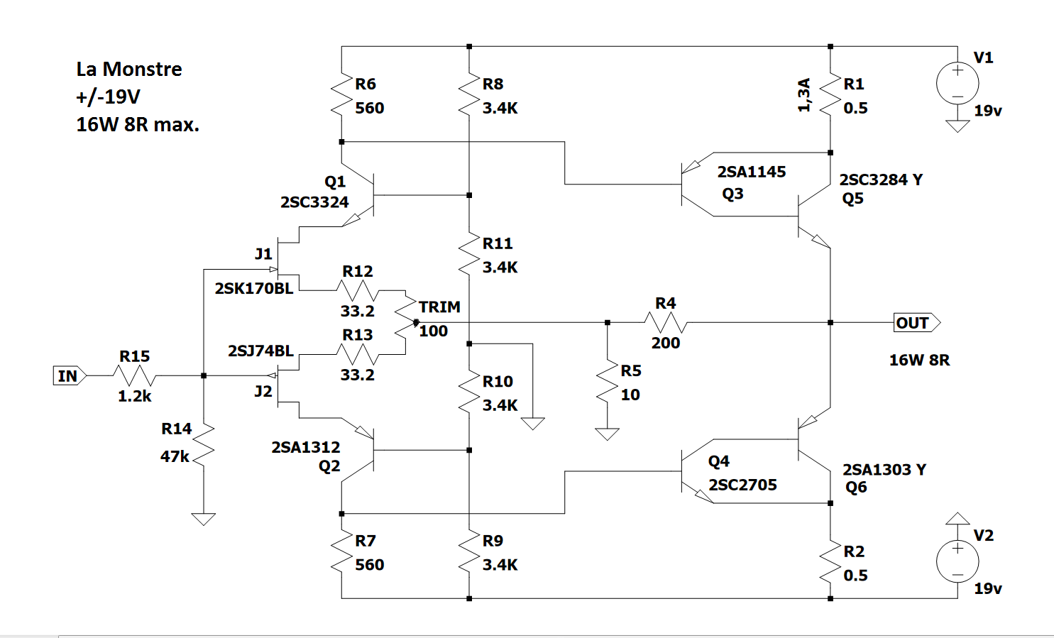

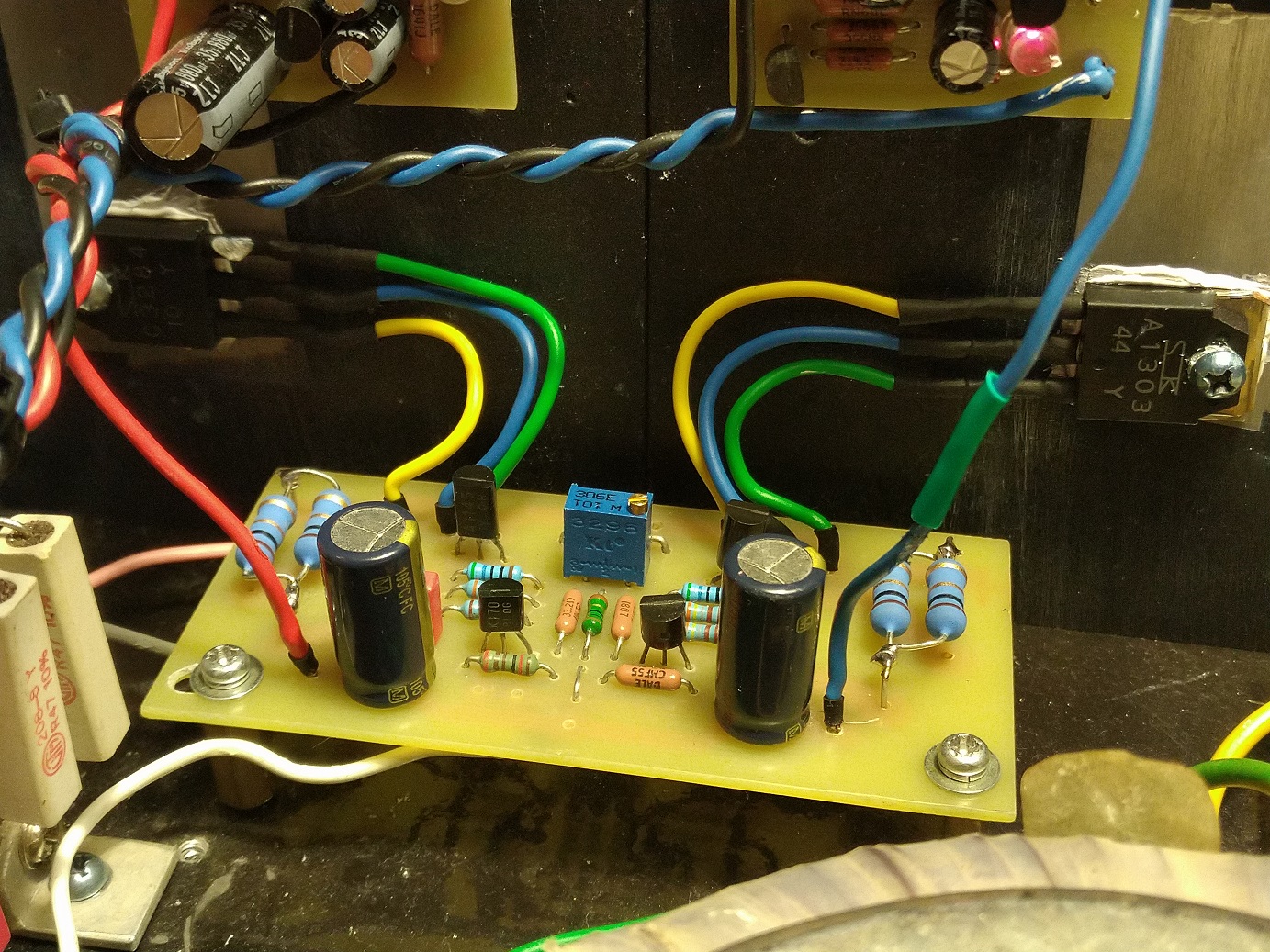

my La Monstre got new output transistors yesterday(2sc3284/2sa1303), I also reduced the collector resistors to 0.5R, I left the current the same around 1.3A, the supply voltage is +/- 19V.
sound? I was surprised, now it's even better than my JLH69, it got a kick in the lower frequencies, the middle and high are detailed, clear, the piano sounds like it's in my living room, just wonderful

looks good.
which pcb did you use? have a pic?

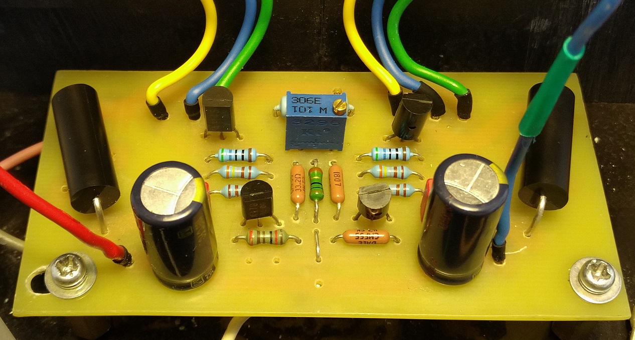

I made all the PCBs myself.

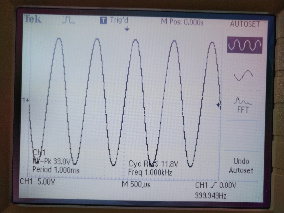

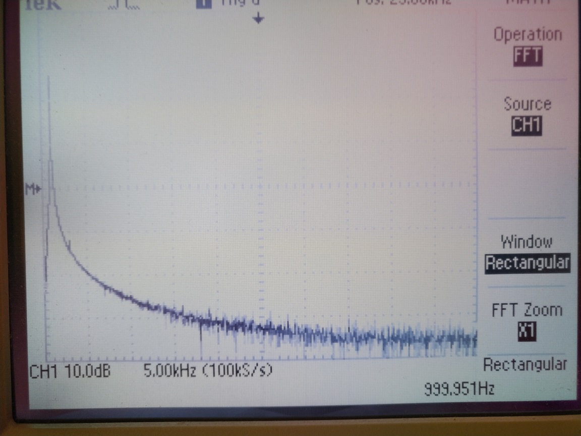

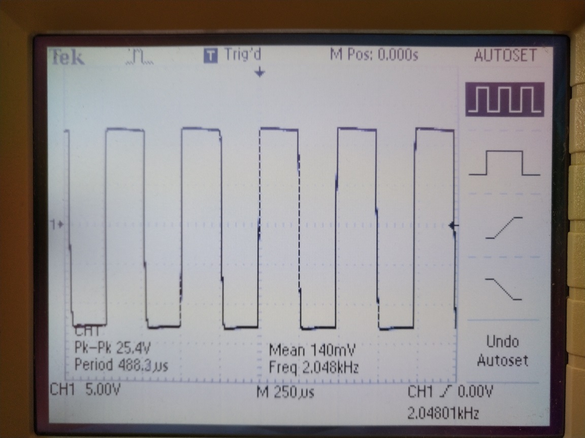

Here are a couple of pictures of the output signal on the scope at 8ohm load.

Nice PCB work!
Could you please provide a pcb template with the components placed?

hi, i can not see 2sc3324 and its complementary on your board? and even not on on your pcb layout?
2SC3324 / 2SA1312 are SMD components and are located on the bottom of the PCB
