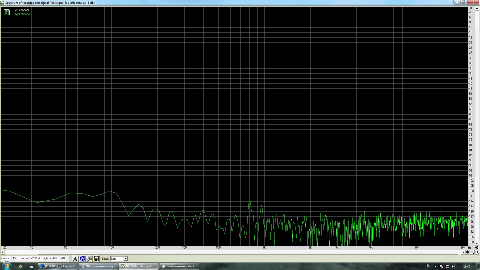

You can to see in RMAA how it influence on amplifier's output with closed input. I don't remember level of pulsing AC of my power supply (because it was 1,5 years ago), but diagram has been saved. 🙂
On diagram: Jean Hiraga's Super Class A 30W made for "rear" (0,18F, bias 0,9A, gain=21, toroidal transformer 2*18V*4,4A 160W, BJT: 2sc1775+2sa872, MJE15034+MJE15035, MJL21196+MJL21195) average self noises with closed input. I have made it on my own PCB.

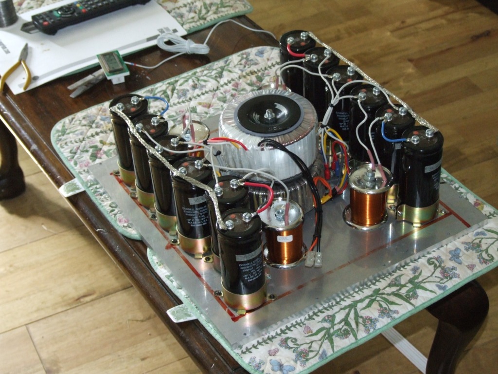

Photo in studio! 🙂
I must agree that I've tried a cap multiplier too and wasn't too impresssed with it either.
It's OK if you are starting out and want to experiment and save a few pennies but ultimately the BRUTE FORCE power supply will always be better.
My 100W/Ch Pass Aleph 4 has a monster power supply to keep its Class A hunger buds happy.

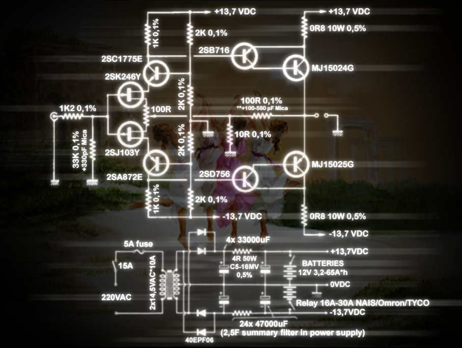

I bought resistors 0.1% 15 ppm. 🙂😀

170+74 had discontinued. 2SK246Y+2SJ103Y as alternative with Idss=1.2-1.5 mA.

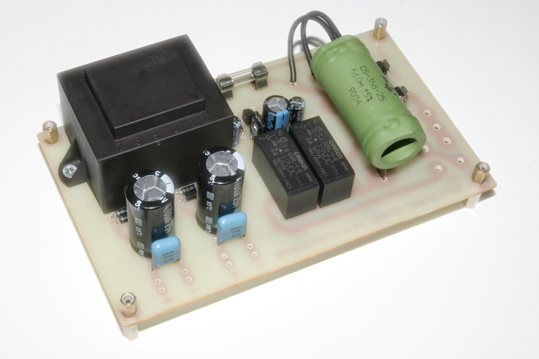

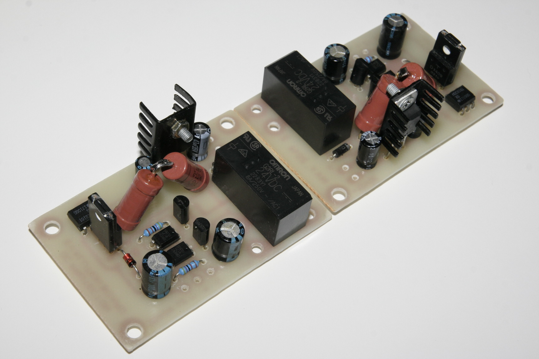

Soft Start for Le Monstre, 56 om 25W, 2 seconds (will be 4 seconds) delay and DC Protection for Super Class A 30W 🙂

Good to hear that the bias difference isn't unusual.
I have two solid state relays with their own built in driver circuits so will be building a DC protection circuit for the outputs. My speakers are vintage german field coil with extreme sensitivity - I would not be happy if this baby took them out.
