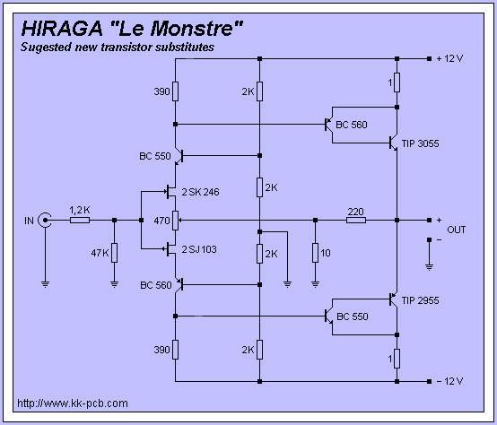

I tried your version but only with IRFP240/9240 and BD as drivers - THD is less - about 0.1-0.2% at the same level with 14V rails. BC show bigger THD then BD or MJE 15031/30.

If you do not like the BC550C/560C as a driver try to use the same driver I'll will use in the mosfet version.

So you say the mosfet version is better after the sim??

For me it looks like it. I swapped only the output transistors (with gate stoppers and add 510R Resistor Between drivers collectors).
THD drops from 0.5 to 0.118 % in sim.

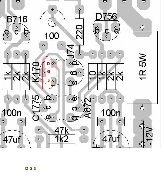

Yes you are right!!!?!?!
http://www.audio-constructions.com/monstre/DSC04059.png
I have mounted it as first suggested and it works! Mayby that is the reason for the shy bass?
But then should it work at all the other way round?????
Have I burned out them?
Even wrong way, it will work.
Why should it work the wrong way? Mine works the wrong way indeed but maybe this is the reason for the "shy" bass?
Can I use the same fets of are they burned out because of the wrong way connected?

The correct connection of the FETs is this one.
Only the 2sk170 needs to be reversed.
Please confirm if I am right, to avoid further confusion.

Please confirm if only one of the two fets needs to be reversed, or not. I am waiting for a reply for the other members on this on my post above.
If only one of the two needs to be reversed then it would be nice to have the pcb altered so that thermal equilibrium occurs between the two fets again. I have allready made the faulty PCBs so I cannot correct this now...

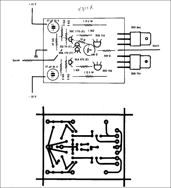

Hello Neazoi,
Source pins of the JFets must be linked to the 100ohm trimpot; drain pins must be linked to the resistor drain of 1k via the bipolar of the cascode (2SC1175/2SA872). Please check the datasheet of the JFet for correct pins identification, but in my memory you've got to reverse both.
Indeed, a Jfet can "work" wrong way, because its internal structure is more or less symetrical. You may measure same idss both way. For me, i match my trans with a curve tracer and a difference occurs with the choice of connection.
Anyway, i don't think your JFet have suffered.
Don't think neither that they are responsable for your "shy bass".
This last point is very strange !
Le Monstre was known to have exceptional, firm, quick and powerful bass, comparable to the Kaneda 50W. I have never heard a "shy" le monstre in bass, oh no !
This power is coming also from the huge PSU : the different versions used between 500000µF and 1.2F per way with or without battery (for perfect silent PSU). You use only 1000µF...Do a test with 300000µF, you may hear something different.
Knd Rgds
PYJ

Hello
Yes you have to turn both both JFet.
I agree with jouff about the "shy bass" .
If you already has the PC board that is not a problem. Use a piece of heat-shrink and fill up the empty place with that warm glue.
You know that glue you have to melt it with glue gun. That has very good thermal conductivity!
Also try to play with different hockup wires. These amplifier is very sensitive to every parts U use.

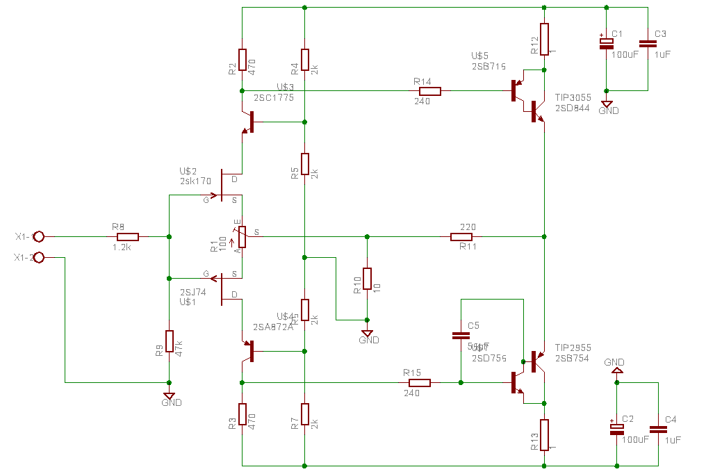

Seeing the datasheets and the schematic http://www.audio-constructions.com/monstre/Hiraga-Monstre-Monster-Class-A-amplifier-schematic.png I think only one of the two fets needs to be reversed.
Is that right? please check it
