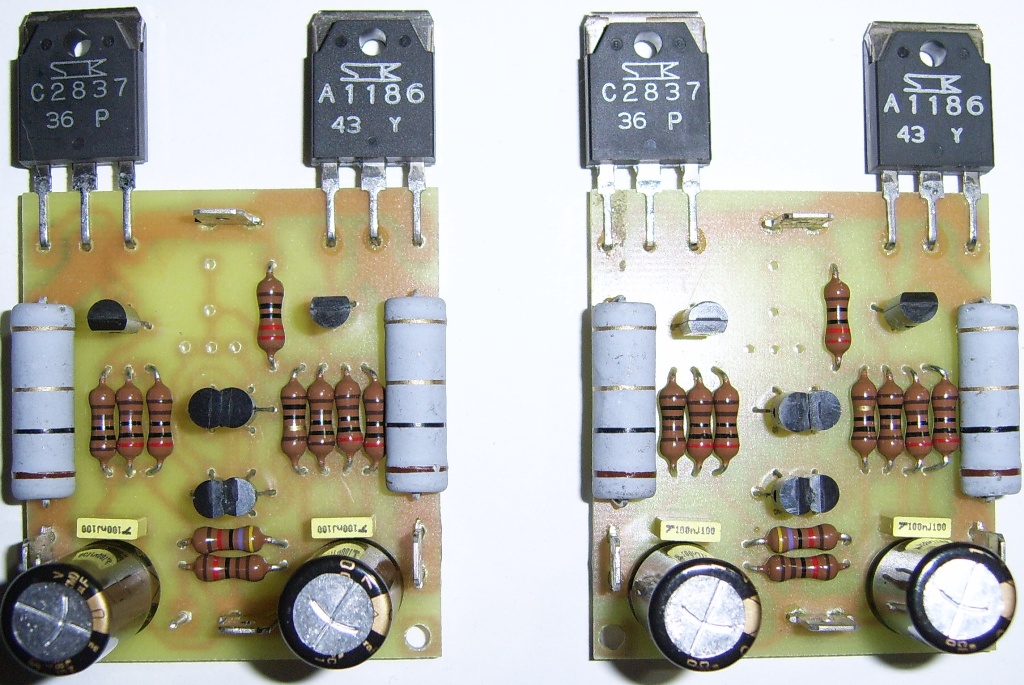

Hi All....
Yes its after midnight...
Just put some bits on the le monstre take 2.....
this time it has special bits on it....
all 0.5 W 1% resistors are tantalum or should i say - unobtanium
the two 5W power resistors are metal oxide non inductive...
the caps are ELNA Cerafines, the transistors are all matched originals, the JFETS are all matched originals, the output stage is the only thing non original it is upgraded to Sanken 2SA1186/2SC2837... much faster / lower Cob.
i superglued the small signal stuff together to enhance thermal tracking.
any how i need one more part which is the dc offset trimpot i will get a multiturn one tommorrow....
then its time to power up this little beasty...

Just fired it up in my break....
Had to trim the bias down from 2.4A !!!!! adding a 1k in parallel with the existing 1K biass resistor yeilds 1.01-1.05A stable.
I did notice a couple of things if anyone is build one.
if you wait for the amp to get stable once you have set the one amp bias you can achieve <10mV with a 25 turn pot easily. with quite low drift. +/- 5mV
The bias level is quite critical for stability at 8R high power at high frequency.
ie if you have 2+ Amps bias on this one it is/was not stable at >20kHz with max output. (i think the 716/756 pair begins to become saturated)
once you have 1 Amp... the amp is very stable. I was able to achieve over 1MHz.

Ok....
to save people who dont want large-ish images loading please see here for the le monstre MSo shots.
notice these is some ringing on the square waves at higher frequencies.
I will work out a cure for this. however i think it is just the measurement setup leads etc.

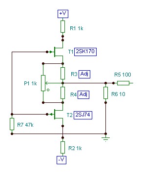

1. So the 1K should be replaced by 500R ? Is this replacement specific for the transistors you have used or does it have to be about 1K if using the original output transistors?
2. Also for the 1.01-1.05A, you refer to the quiescent current through EACH 1ohm resistor? (because in the original article it states it sould be 0.5-0.6A)
3. An interesting point is to make a circuit to continuously correct the bias, by measutig the voltage accross 1Ohm resistors and altering the falue of a parallel resistor to the 1K one. So the bias would always be in the correct point. (very usefull if running in battery only operation, where the voltage changes as the battery discharges.)
Yes the bias i am running at the moment is 1A with the output stage i chose i needed 500R to achieve this.
I may bring the bias lower to see how it affects the performance.
I thought the original bias was 1A have i will have another look.
-Dan

Yes that was exactly the point I was reading too.
hm.. I found the simplest solution for the autobias! It is something like this http://diyaudioprojects.com/Solid/DIY-Lightspeed-Passive-Attenuator/
just use LDRs.
But one should chose a specific LDR which will give a resistance of 500ohm to 900ohm, when paralleled with 1K. i.e the LDR should have a resistance of about 1-10K. A scaling mechanism must exist there, to compenstate correctly to the voltage variations.
So as far as I think just decide the bias point and then chose the appropriate LDR.
In a fixed PSU this is not much of importance but in battery only mode this is crucial I think, unless you want to continuously set the bias as the batteries are gedding discharged.
hey you may even compensate for the differences in batteries discharging that way? (one battery may discharge a bit quicker than the other, or may not be as charged as the other). (crazy thought?)
