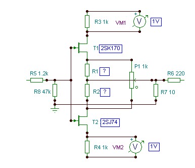

OK, here's a drawing of the circuit I'm using. I didn't put on the values of the bias resistors, since I'm using trimpots for these (at least for the time being). These are adjusted to give 550mA bias, as the Monstre articles recommend. (Although I suppose the recommended value depends on the output transistors too, right?).
I don't use PCBs (at least not yet), all done p2p.
It's not too hard to reduce the resistors on either side of the trimpot (which would reduce it form 460R to, say, 300R). What do you think?
Cheers
Nigel
regarding "loudness" ( gain ) issue - double check values of 220 and 10 ohms resistors in feedback net ,same as functionality of feedback net ( is it connected at all , where it need to be ) .
excessive gain and noise are signs that you're running that amp open loop ........ and fact that you have same culprit in both channels is sign that you made some system mistake ... (not connected track or similar)
actually, to support what Zen mod says,
I remember there is some trick with the location of the 10 Ohm resistor
its location is shown incorrectly on the pcb overlay pic layout in the class a amplifier site and should be connected as per the circuit diagram.
(that is from the pot wiper to earth)
-Dan
Thx for the replies. I'm not sure what "open loop" means... Am I right in guessing it simply means the feedback loop isn't working? (which is the second half of ZenMod's reply) Anyone have a reference where I can read up? Certainly I can (and will) check the remarks about the 10R and 220R resistors, and the feedback circuit as a whole.
Returning the trimpot to 100R sounds a backwards step - after all things sounded dreadful before raising it. The original circuit (which uses Y grade jfets) uses 100R, other circuits I have seen using GR grade use 200R. I simply guess-timated the value. Reducing it to 200-300R sounds a more plausible thing to try.
Nobody seems to think the output transistors are the culprits, right?
I'll report back.
Cheers
Nigel
@njepit :
simply check have you proper conection of 220R and 10 R , between output and trimpot ( between sources of jfets )
open loop - means - disconnected feedback net ( 220r-10R - pot ) , when amp have entire possible gain ..... , not decreased with feedback .....
in that case - you'll have excessive gain and noise
if you have feedback connected as needed , any swap of output transistors will have just diminutive influence , not massive one .....

Thanks ZenMod. Very clear explanation. I'm checking the 220r -20r network as I write this....
Two questions - the trimpot is evidently part of the feedback circuit. Presumably its value therefore affects the feedback loop. So if it's value is to high there is too little feedback. Would this have the same kind of effect (although to lesser degree) as no feedback? That is, force the amp into higher gain than is desired? The second question if what happens if the two bias resistors are unbalanced? This may be an issue since I am using trimpots.
Cheers
Nigel

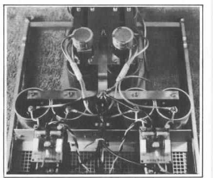

Hi all,
Just a few pics of original le monstre some "eye candy"
