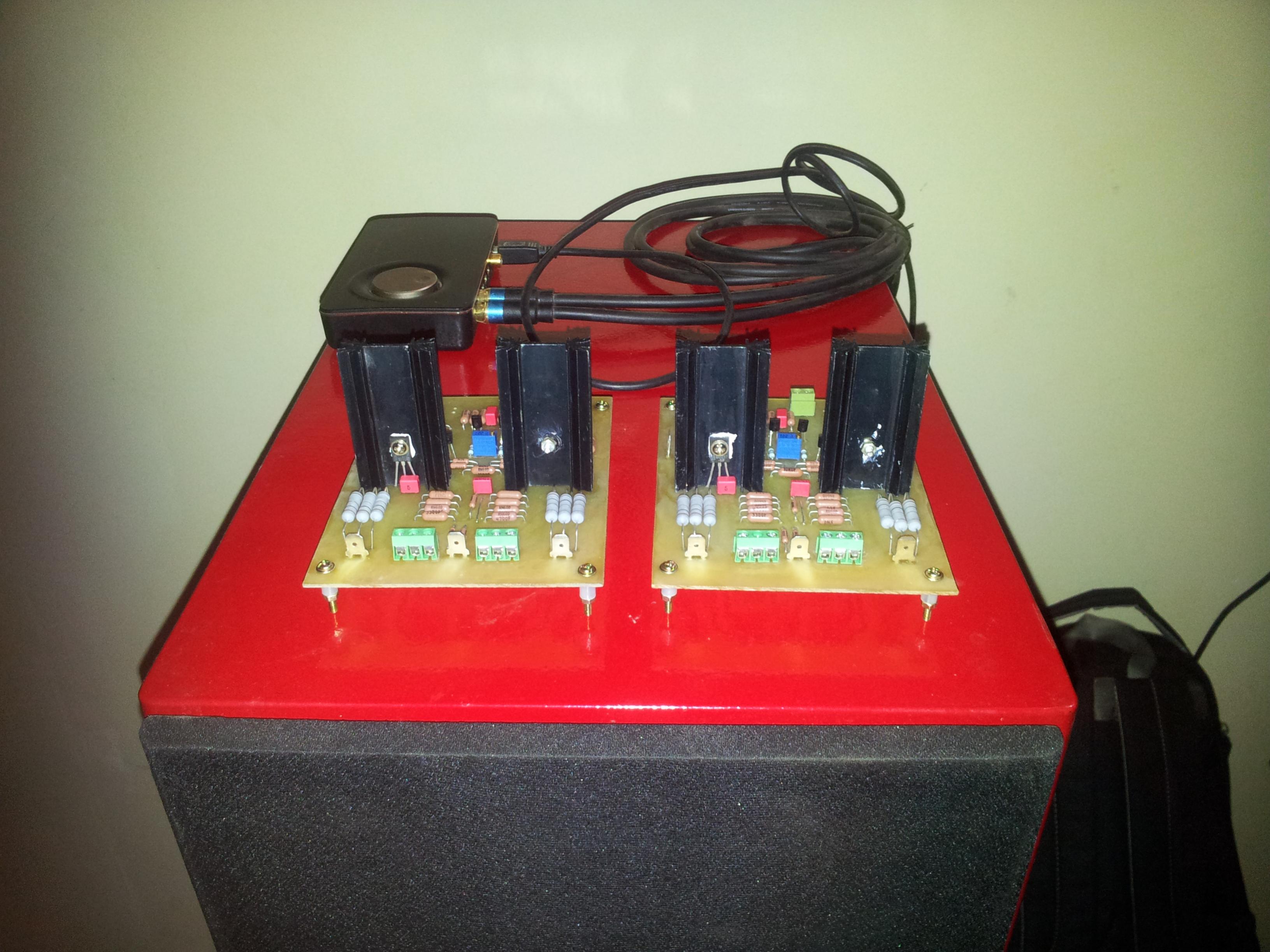

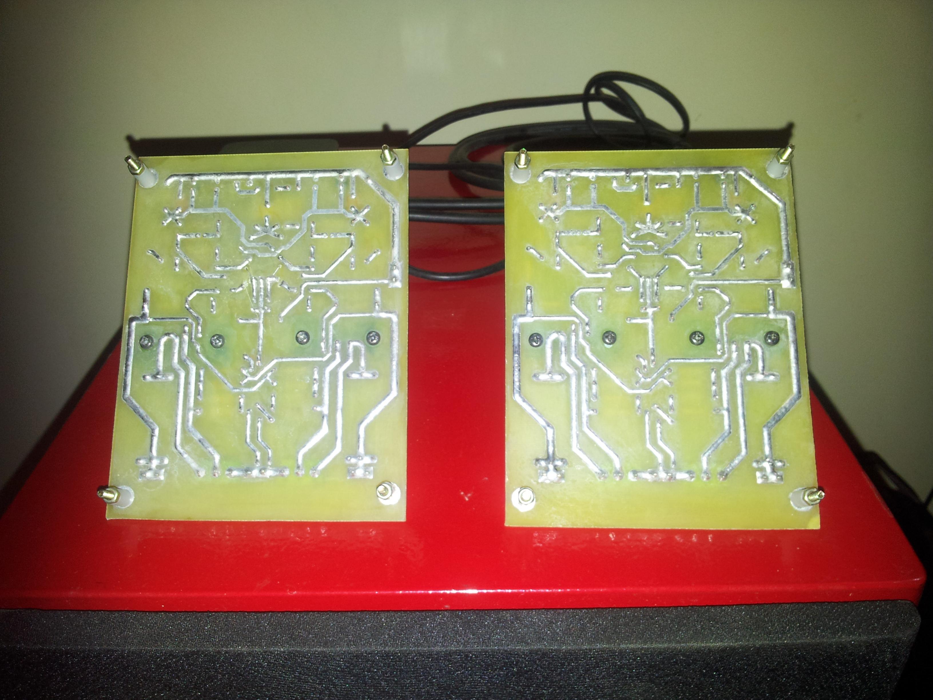

Excellent work. Looks like professional fabrication. You have used Dale resistors on the board, who is the seller of Dale resistors in India. I am at Lucknow and unable to get any quality component here. Please share the test results with us.
R.K.Katiyar
Hi, R.K., Dale resistors can be procured online from theaudiocrafts ...but you may not get all values, which was the major reason for series and parallel connection of resistors, as I didn't want to put anything other than dale.it also got me to match the values exactly..so good luck...test results will share shortly...hardware is wip. Regards ss😀
some more pics...
