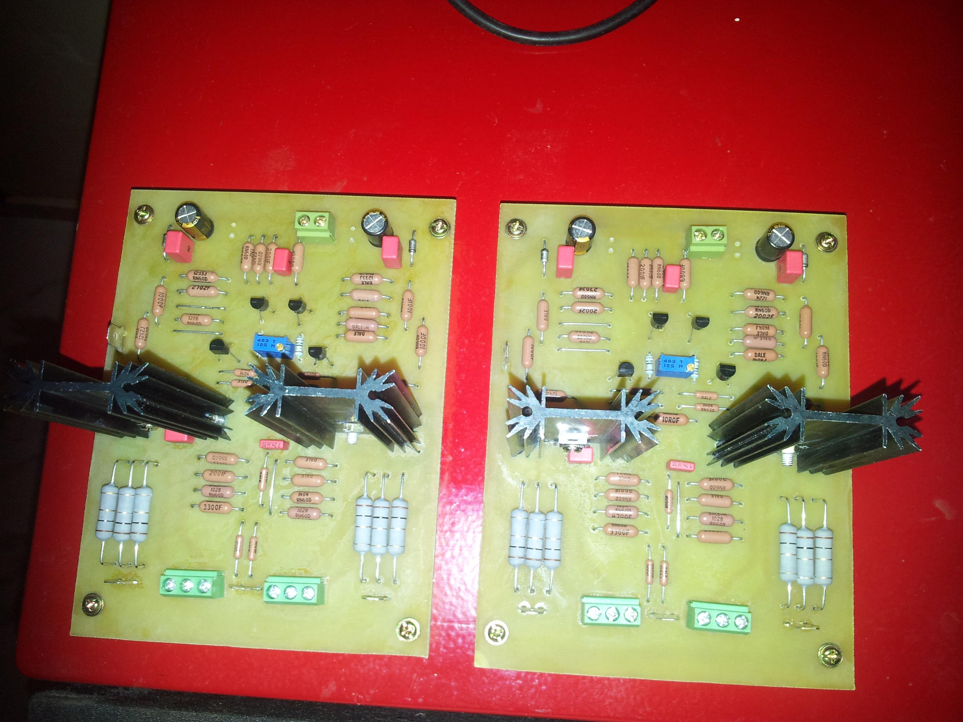

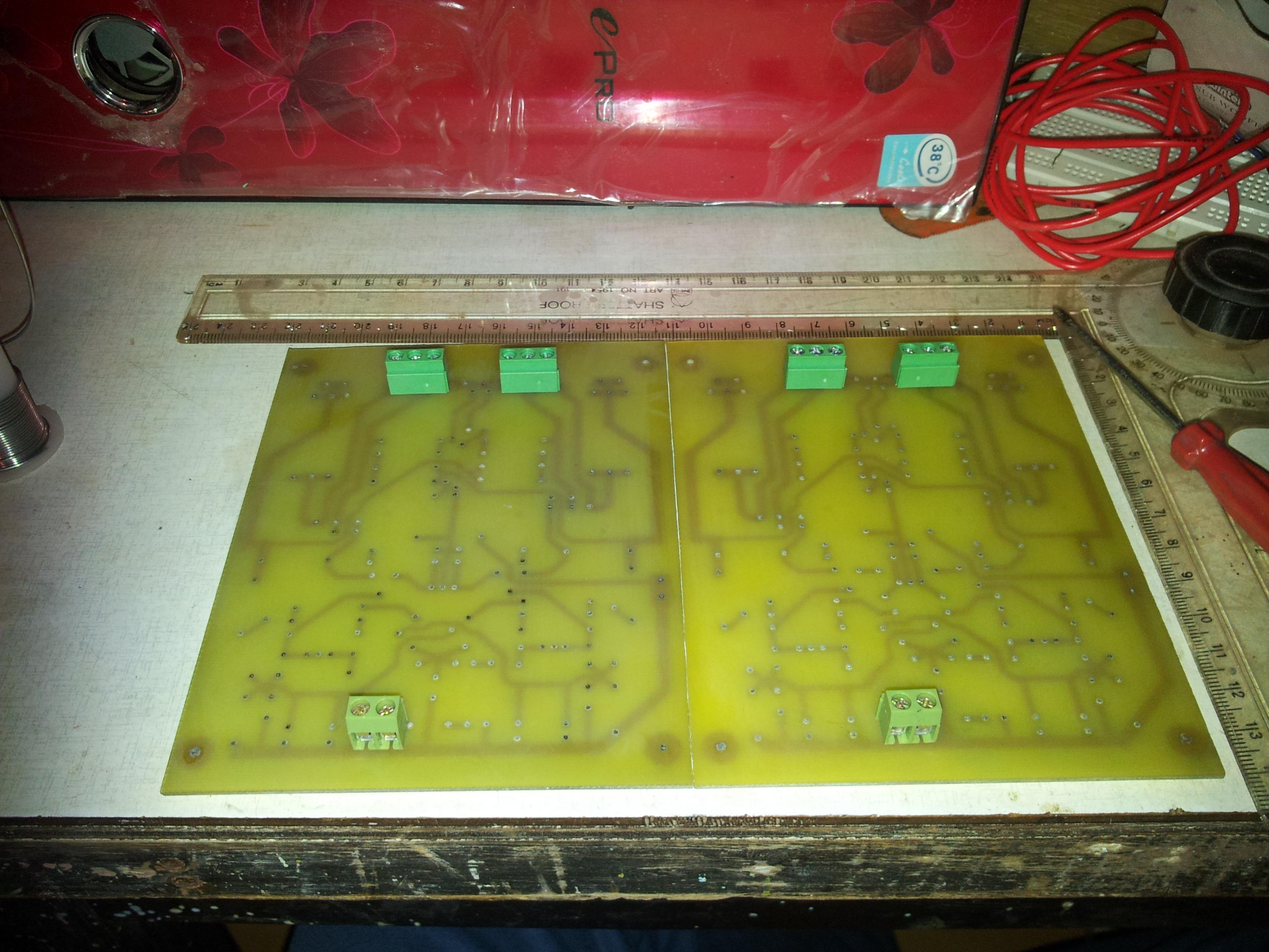

Hi, All. Started the assembly..PCB population in progress...
hi Saraswat, those PCBs look neat. even i am planning to build a Hiraga 30W Class A. recently I have ordered the PCBs from Jim's audio [off ebay]. planning to do a dual mono construction.
as Sergiu suggested, i am planning to use 400VA trafos for each channel. ultimately everything will depend on the parts list and schematic that Jim's Audio is going to mail me.
All the best!
-Som

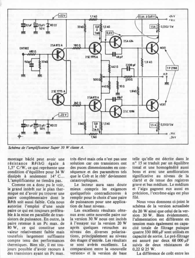

I think that Kef 104/2 are not problem for Hiraga's 30W (but the filter of 1,456F is really scaring).
Huge !

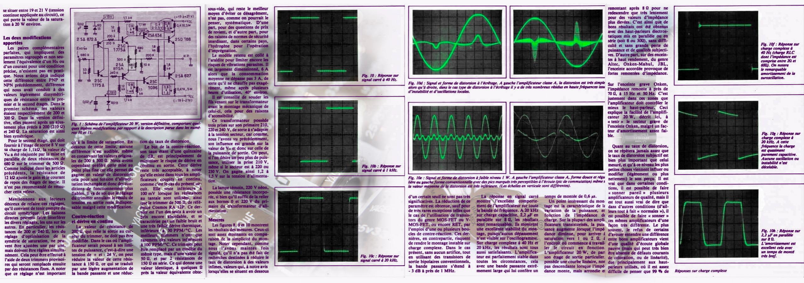

Are you CLC or CRC for the caps bank ? Good inputs about that in previous threads & posts on DIYAUDIO on the corrected version by Hiraga himself in la Revue de l'Audiophile)... Ah yes you linked the paper !
Huge !
CLC or CRC - 2*68000 uF->L/R->4*330000 uF look cool and.. scary.

Really nice. I agree that you should solder those wires for the outputs and Ual. If you leave them like this there isnt so much contact there and they may get some heavy oxides in time wich you will not want in the future.
Cheers
Sergiu

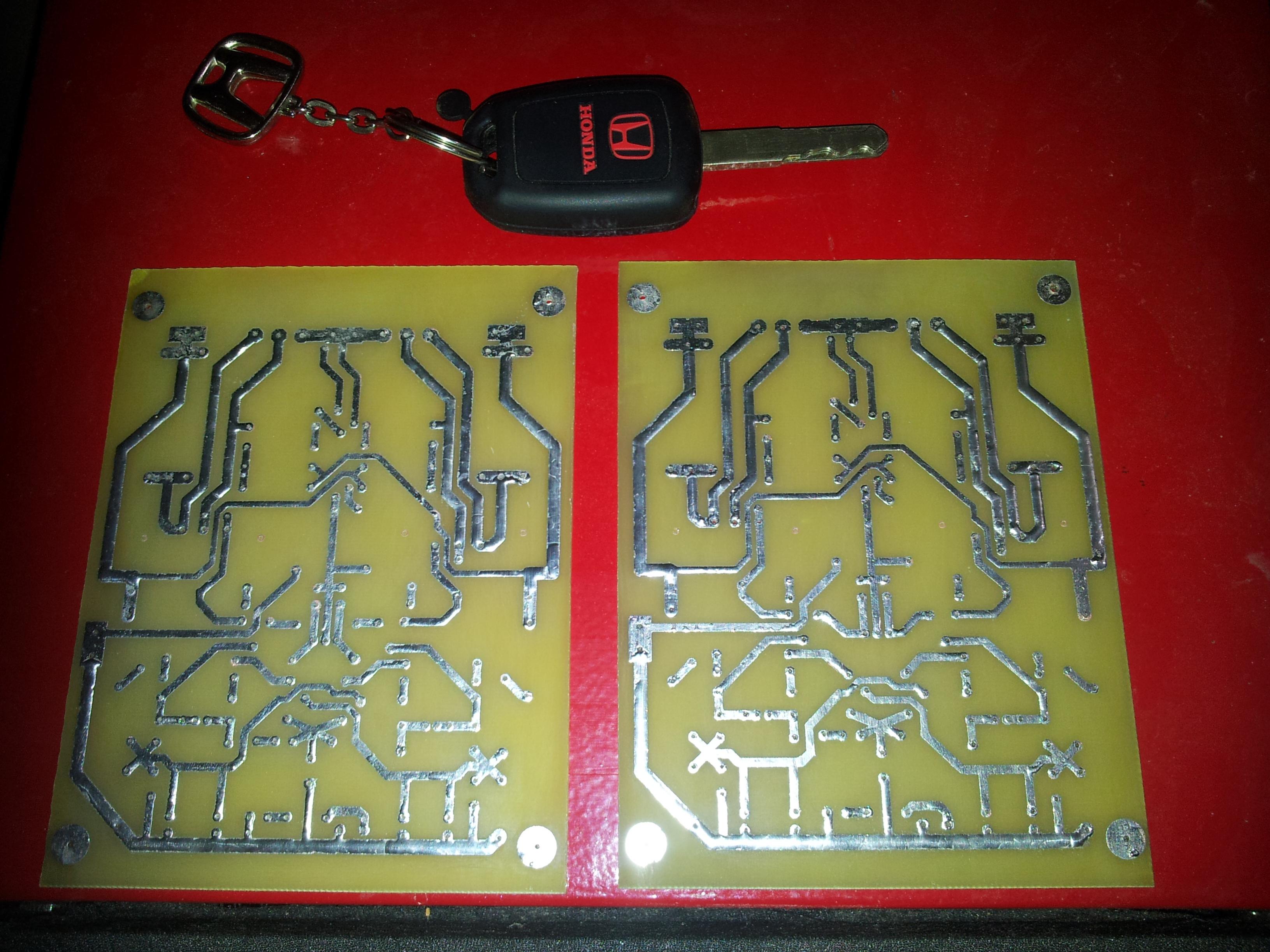

In process...
I have seen the pcbs from the other thread. Imacullate work and neat.
Keep up the good work and posting.
Cheers

Hi, Sergiu, thanks have used those connectors temporarily ...will remove them after final testing...regards
Thanx.I have seen the pcbs from the other thread. Imacullate work and neat.
Cheers
