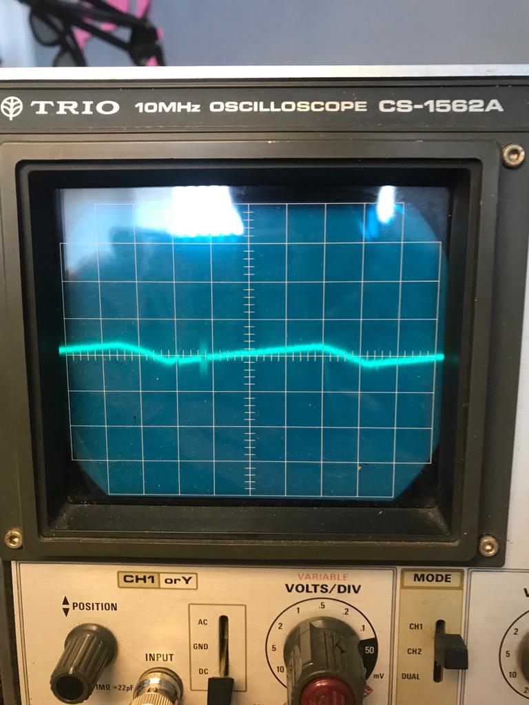

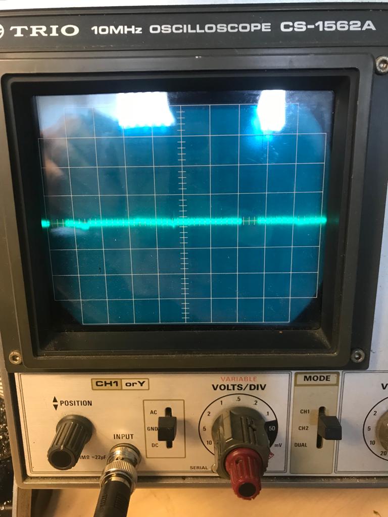

I have the second half of the amp running now, looks stable . But while checking the signal path with my scope i noticed this. on the base of the output transistors and ouput itself.

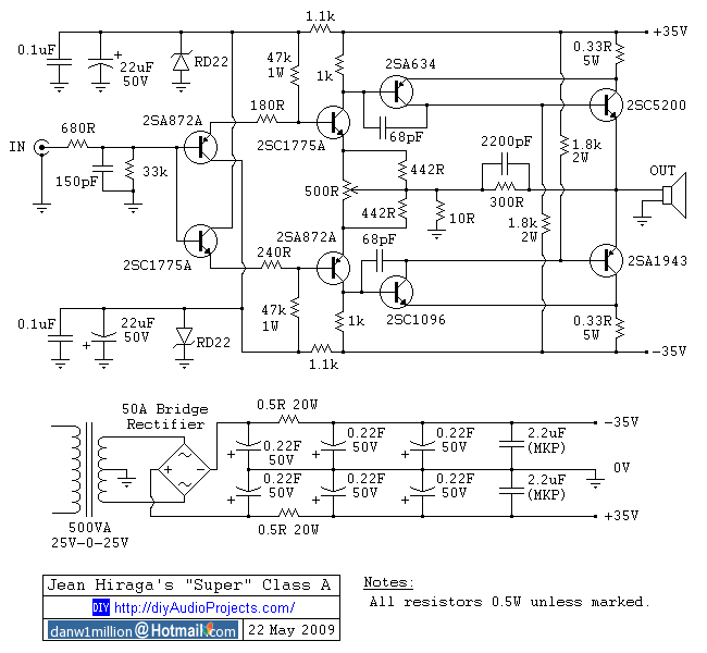

Time is 10ms so 100Hz, Vpp is 80mV. My supply has a 100Hz 300mVpp ripple @ 32V while running 900mA current through SC5200, which doesnt seem too bad i guess? (no load/input shorted) . Is this something to worry about ?

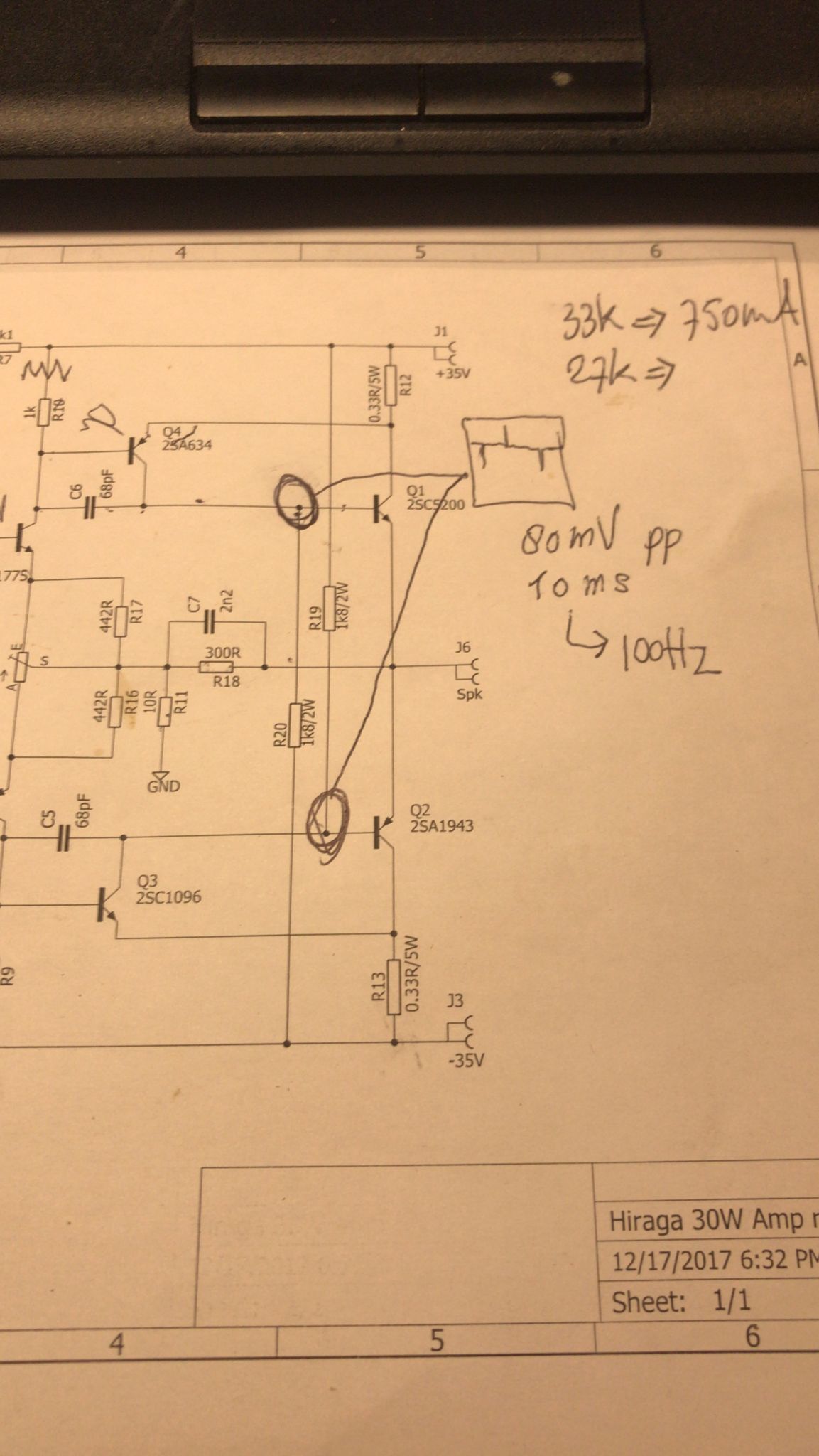

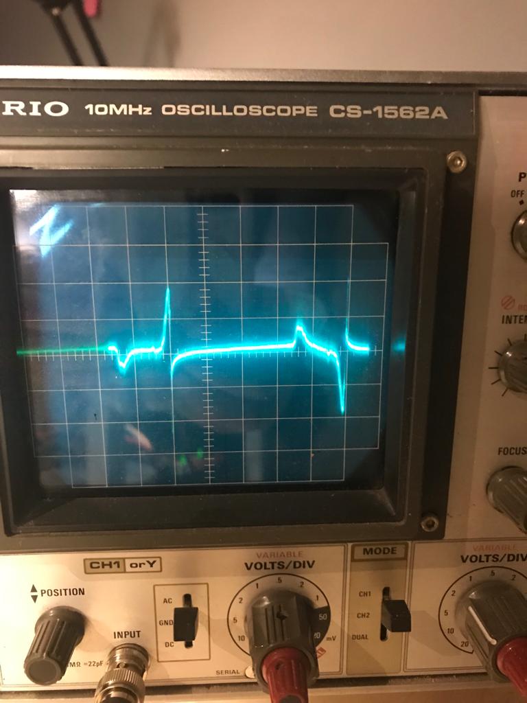

My best guess is that you can see the charging spikes from the supply rails: first a small dip when the rectifier diodes starts to charge the supply caps, and after 2msec the caps are full and the bridge closes. A spike from inductors (?) feeds the caps a little bit more.
Is the supply CLC or CRC smoothed? Hiraga used CRC. There is a simple but very smart supply application on the web (other members here have the link ready... I haven't, sorry) to determine if the supply setup is susceptible for this ringing.
Can you post a circuit diagram of your supply?
Addition:

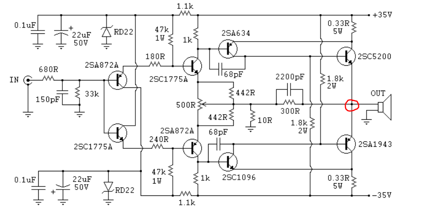

These spikes (dips) are injected into the signal path through R19/R20 easely.
Q3/Q4 are close to the rails surrounded by (relative, current speaking) low value resistors, so I don't expect susceptibility there.
Curious to observe these alternating spikes actually while typing this. It should be mirrored on the circled nodes. Hmmm...

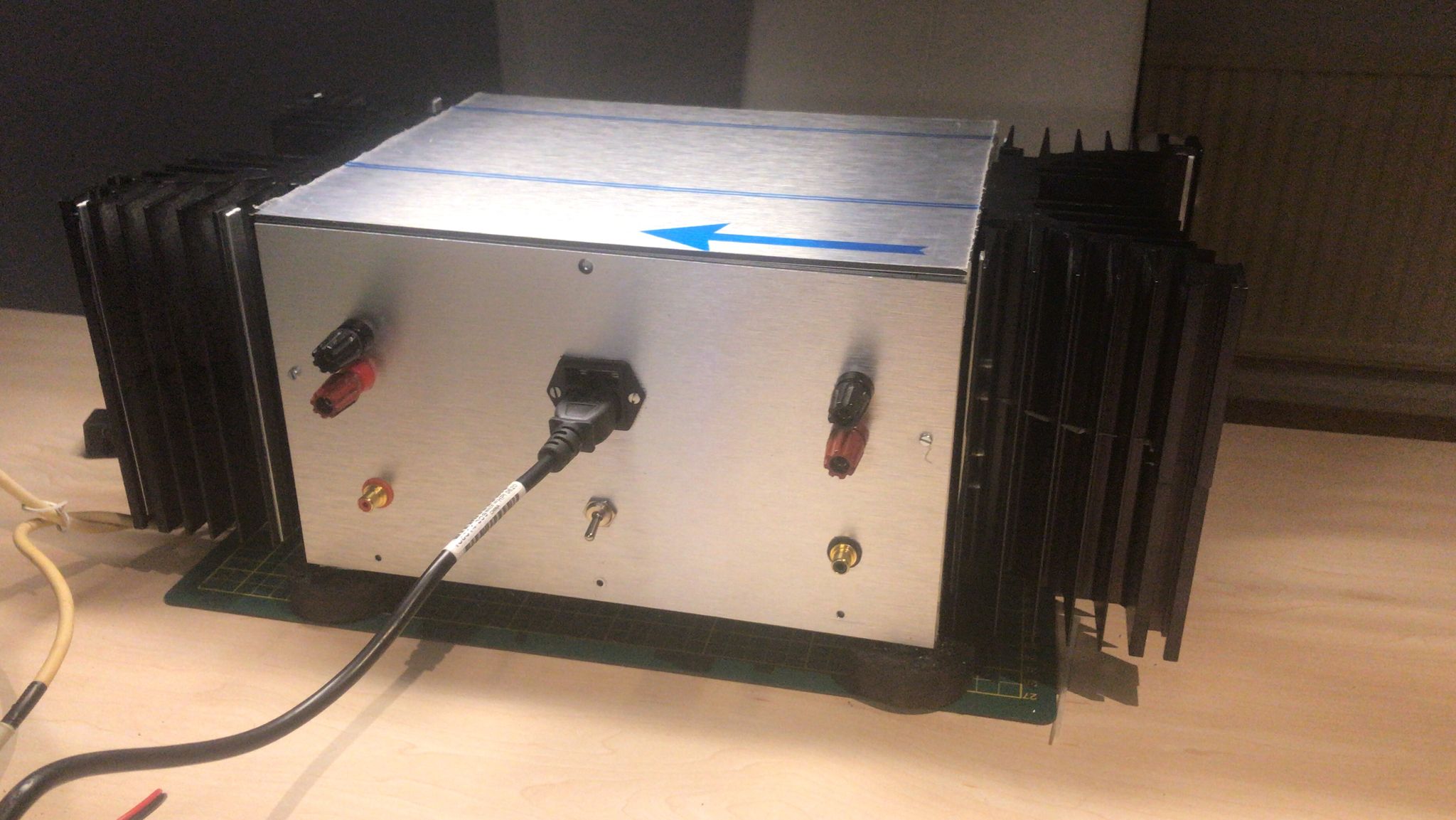

Put both halves on the main chassis, a lot of wiring to do , an do it neatly also. Quite a challenge ;-)
Also, both outputs keep drifting up and down, +/- 100 mV . It might not damage any speaker but it doesnt feel ok.
So i tried to figure out where this drift comes from. Its the driver transistors. The are not thermally coupled. If i blow just a little bit, on one of the drivers the output swings to a 250 mV DC. If I put the lid on the housing drift stays within 20mV DC.

With the complete assembled housing drift is within 10mV.

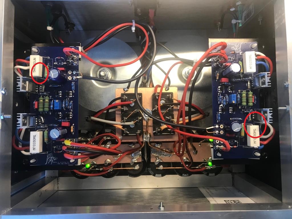

Where is the point I circled in red located? I mean the exact physical location inside the amplifier build. I am asking this because sometimes the spikes you have shown in post #22 could be corrected by choosing the feedback signal pickup point as close as possible to the actual binding posts... which in this case could work really well due to the non-existent Zobel filter. I learnt this many decades ago when I was playing with Japanese amplifiers.
I suppose you could give it a go and see what happens with those spikes..?
Another approach is what was already mentioned above... tackle the root cause by reducing the PS ripple and possibly by using fast-switching soft recovery diodes.
That point is on the PCB's, see picture . Can you explain what you exactly mean with binding posts ?

Placed (16 total) 47nF capacitors on the rectifier diodes. Ringing on power rails and output is almost gone. Still some 5mV PS hum....will put a 4Ohm resistor to make a CRCC supply. Also, after running in the whole weekend the endstage current increased from 859mA to 1.1A....on both left and right. Still running in I guess !
