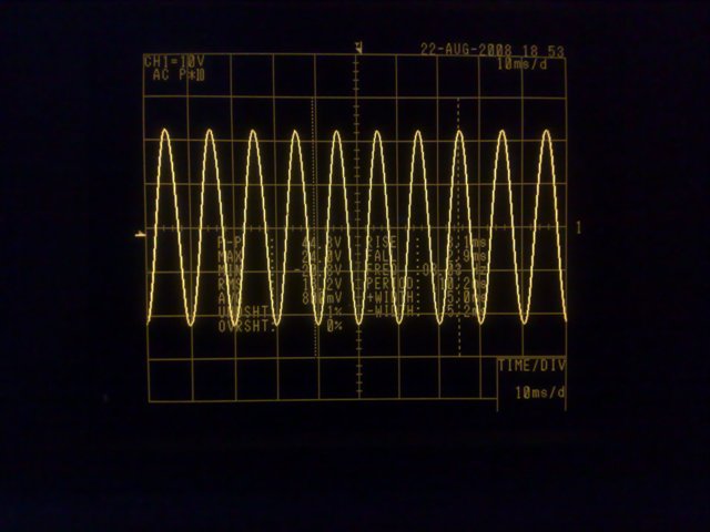

looks good, daniel
but,
squarewaves show more the quality of signal
have you 1kHz and 10kHz square results?
at normal level ( 1 - 2 Volt )
but,
Hi lineup.
I have not finished taking all the measurements yet.
I will post up square wave results when bring the amp to the lab.
-Dan
-Dan
