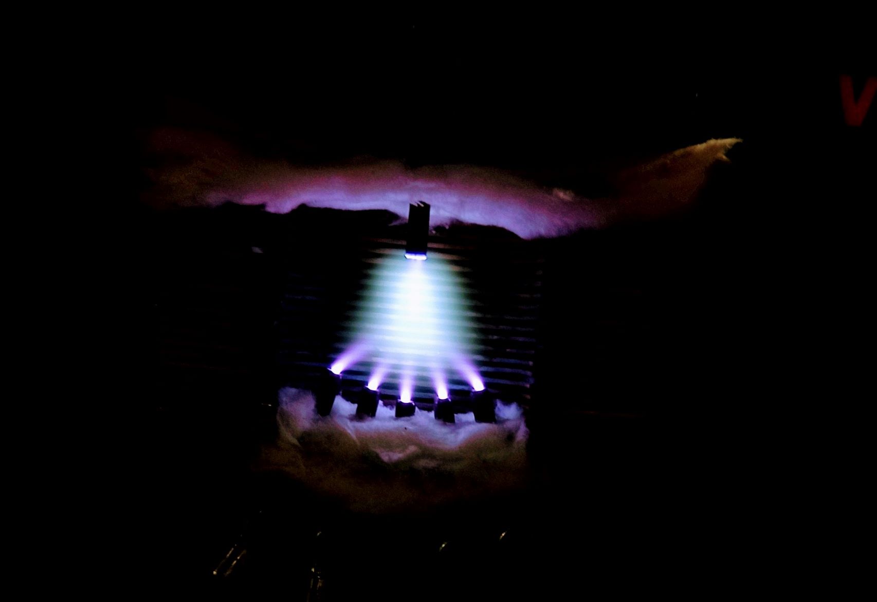

Here is a photo of one of my resurrected plasma drivers. The color is not quite right. The cathode areas are a bit more on the rose-lavender side of the spectrum (from the ionized Helium) and the main column is more greeny-yellow (from ionized Nitrogen). The distance from the anode to the center cathode is ~1 inch.
Thank you for sharing this image and info, very helpfull indeed !
The laminated metal sheets in the back need to have a resistive connection between each other to help the flame jump (like a bridge) at start-up. I was wondering if metal rods can be used instead to help cooling the flame a bit.
Another thought i had was using porous material like graphite instead of nickel tubing. This way the heat will be spread over a larger area (if the plasma is obedient).
The copper sheets are electrically isolated from each other and do not contribute to start up. They are perpendicular to the electric field so as not to interfere electrically while removing heat.
I cannot think why graphite would be better than the nickel tubing.
