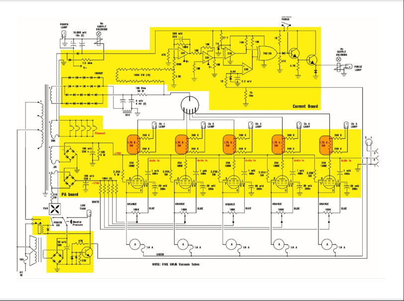

I always imagined some gas flow noise, but that is a non issue?
Did you need an alternative for the fan?
The gas flow is ~1.25 cubic feet per hour - very low. It makes absolutely no noise.
The fan was needed because the tubes, power resistors, and plasma driver were all in close proximity. We used an AC fan and placed a resistor in series with it to slow it way down. My new system does not need it.
