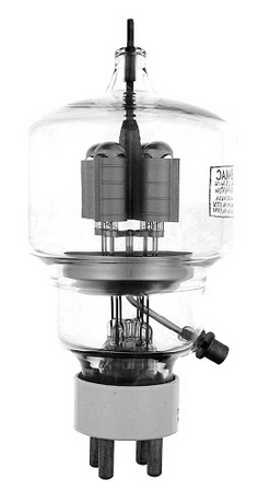

I'm building the power supplies now, need to snag a good tube. I wonder how a eimac 304TL would do? Overkill? well, I already have a couple of them.
Wow, nice tubes ! Just the heater supply will keep you warm in the winter, and that is just the supply ! Then the tubes plus the cathode current... no plasma spark yet... ha ha... that will add some more heat !

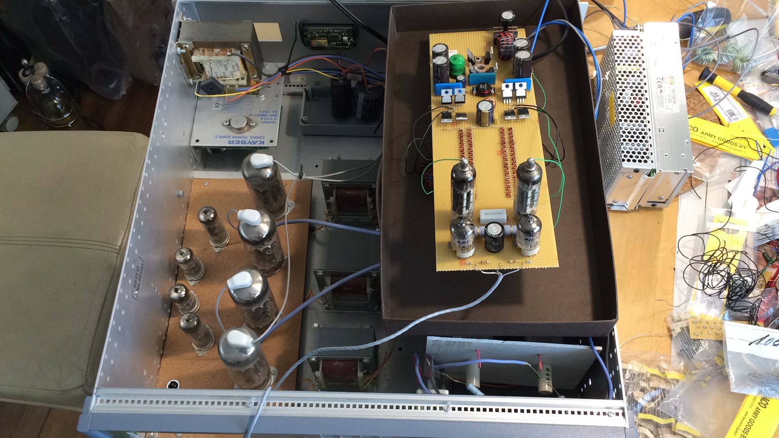

Had weird tube dreams last night. Studying 4X150 and 6MJ6. The numbers don't add up on 6MJ6. Gm 7500 u mho, Rp 7000, Mu 3. If Gm = Mu/Rp it don't flush. Not even close. If it was off by 1000 or something I would blame the decimal point, but it's off in left field. At least one of those numbers is wrong. I'll try getting the numbers off the curves next.
For sure, a 4X150 will do a good bit more of everything than a 6MJ6, overkill really. The special socket and forced air is a pain, the advantage is I already have a few 4X150s.

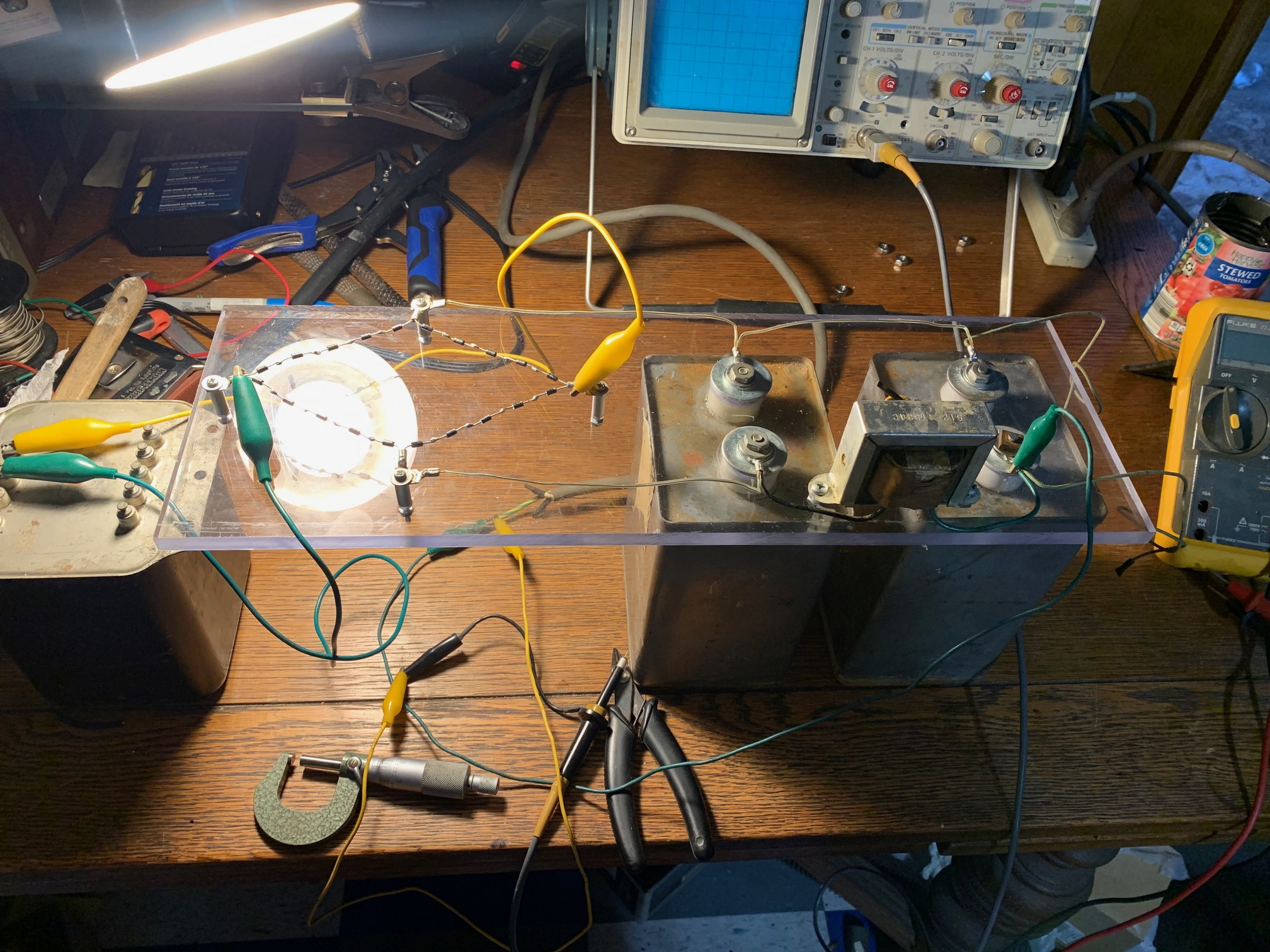

Got a 3000 volt supply in the works:

6MJ6 in triode mode?
The 6MJ6 is used as a pentode: screen grid at ~150V, suppressor tied to cathode. Plate voltage is ~1100V at ~30mA while running. The tube is pushed right to its limits.

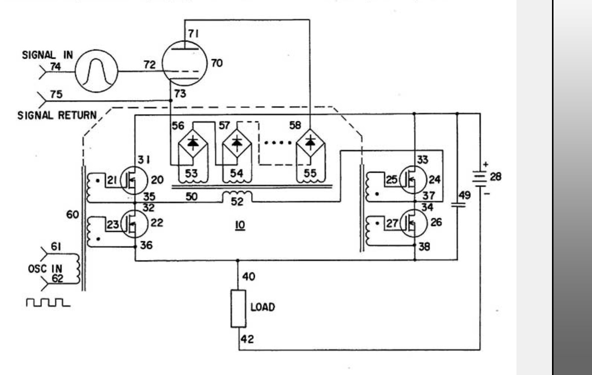

The rectifier in the lower left of the original schematic should be turned 90 degrees...
Good catch! I was only 21 years old at the time and should have caught that error. It was done in ink and was not simple to erase without making a hole in the velum. I don't remember after all these years if I just hoped it was not going to be noticed.

My understanding (from Alan) is if the plasma current goes to zero, even briefly, it becomes unstable. The recombination rates are fast - I don't have exact numbers, but a few microseconds seems plausible. Best to be aware of this possibility. Also be aware that a single channel test, at say 35mA, will not be stable at all because the total current in the discharge will be less than what is needed to keep it alive. I know this from direct experience. I have to run all five channels to get it to stay lit.
