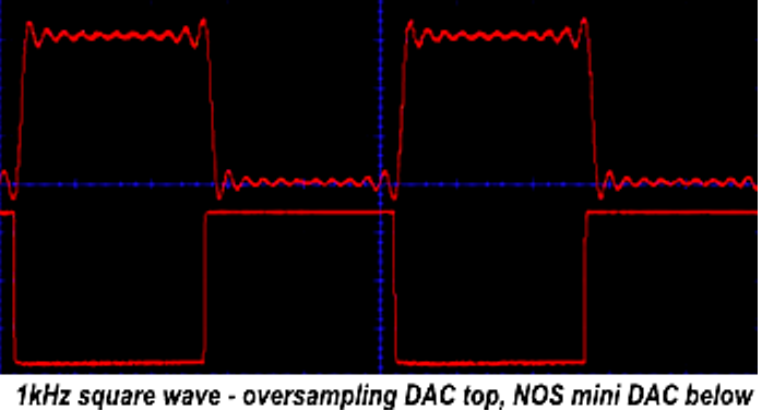

I think that I read almost the full tread...
But I do not find the explanation of differences between this two screenshots from post 110 even if was posts by "experts" in the field in my opinion.
The explanation it is very simple:
the first wave form show a square wave form with a limited bandwidth and it is not necessarily connected to an over-sampled DAC but to a reconstruction filter. To obtain a perfect square wave form you need a infinite bandwidth. This are the theory, it is not my statement. The "ringing" are not distortions, only show lack of superior harmonics necessary reconstruction of a rectangular waveform.​
the second one show a voltage step, not reconstructed waveform, and the bandwidth it is much larger because it is a commutation and it is limited only by parasitic capacity and by slew-rate of the output of commutators from inside of cip. From my point of view it is more close to digital waveform not to analog waveform.
I would like to know what "acoustic" signal source can generate such a waveform (it is need a source with an infinite power because it is need a infinite bandwidth).​
None exist in the real world but the first is much closer to reality.
