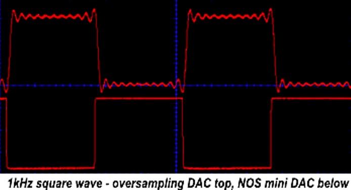

And the concept of a NOS (non-oversampling) DAC could be clearly described from the attached screen-shot from oscilloscope.
The upper waveform is the output of an oversampling DAC while the lower is the output of the NOS. With analog audio terms, the upper waveform is plenty from overshoot and ringing and i have seen it many times in tests with instruments. It is realy the enervating side of digital audio devices as it implies a very high TIM distortion (transient intermodulation distortion) which in analog audio circuits usualy is caused from non compensated feedback loops.
The lower waveform is the output of NOS and indeed is a clean and enviable square wave. But only a 1KHz test waveform does not say the whole story.
I would like to see the square wave response of NOS at 100Hz and at 10KHz which are the difficult test signals.
