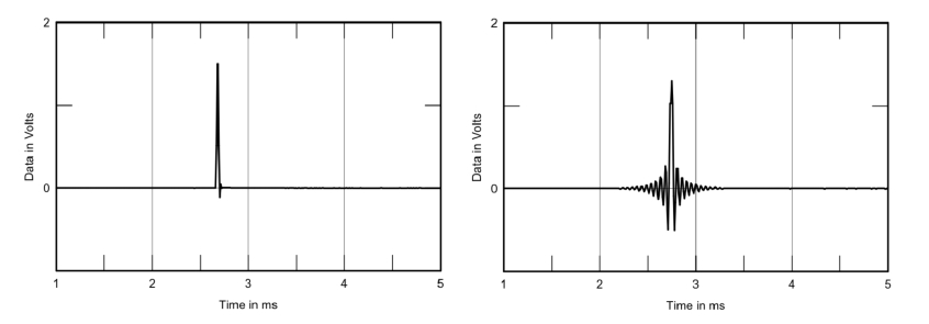

So, with simple words, ringings caused from the reconstruction filter which is an analog low pass filter.
It's not ringing in a resonance sense- it's Gibbs Phenomenon.
The "ringing" are not distortions, only show lack of superior harmonics necessary reconstruction of a rectangular waveform.
From my point of view it is more close to digital waveform not to analog waveform.
I would like to know what "acoustic" signal source can generate such a waveform (it is need a source with an infinite power because it is need a infinite bandwidth).
None exist in the real world but the first is much closer to reality.

If you look at this picture, you can see the impulse response of the NOS DAC is much closer to reality.
From the picture, it looks like this has been faked. To wit, the 'impulse response' isn't the system impulse response, rather a digital file with illegal values has been created (hex editor or maybe Audacity) and played out through the filterless NOS DAC.
The mistake you are making is assuming that doing a 'join the dots' with straight lines represents reality.
It doesn't, the sample values are NOT the signal, especially when there are high frequency components present.
For example, 0, 1, 0, -1 <repeats> is a Fs/4 sine wave when correctly reconstructed, put it thru a 'DAC' without a filter however and you get this weird pulsy thing simply because you still have components at 3/4Fs and 5/4Fs and so on.
The oversampling DAC in those pictures is the one working correctly and reproducing what I would expect, the NOS one clearly lacks suitable filtering and has gobs of ultrasonics in its output.
Now you can argue with the filter used in the oversampling DAC, it is clearly linear phase but all such suffer from preringing, and reasonable men can disagree about the best tradeoff here, but it is far closer to correct then the NOS one without the filter is.
Indeed. This is how a real pair looks.
